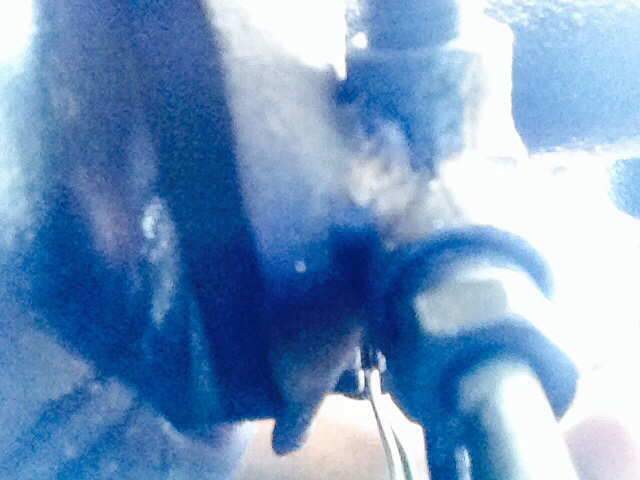

Master cylinder leak
Did some off roading yesterday and must have rattled my brake master cylinder. Some fluid seeping from the front of the cylinder. Do I have to replace the whole thing or just a gasket issue?
Is the fluid actually seeping out of the cylinder, or is it just coming off of it like it had gotten past the lid?
To be honest, I would recommend replacing it anyway, because the masters on these trucks tend to be pretty tired.

It seems it was just some fluid that seeped out of the cap where the sensor wires enter. That's a relief.

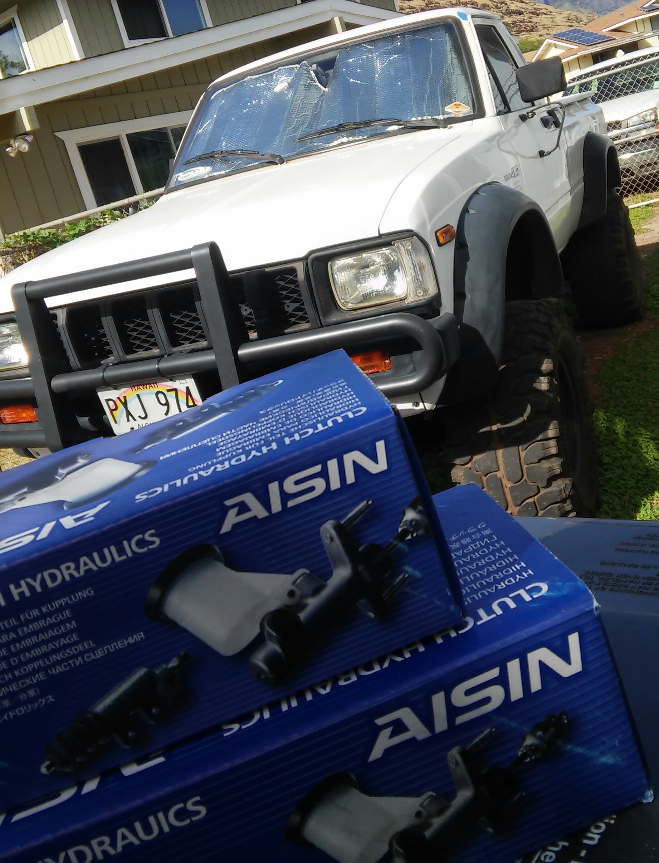

I got a new radiator. Old one had a big section of brittle fins. Temp problem gone.
Changed windshield rubber.
Gonna change clutch master and slave since its cheap. Amazon.
Old master got a slow drip by the pedal.
Swapped transmission gear oil for synchromesh mtf. Sooooo smooth!
Big plan with no financing. Lol. One day I'll actually build it. Until then it runs all over the island strong.

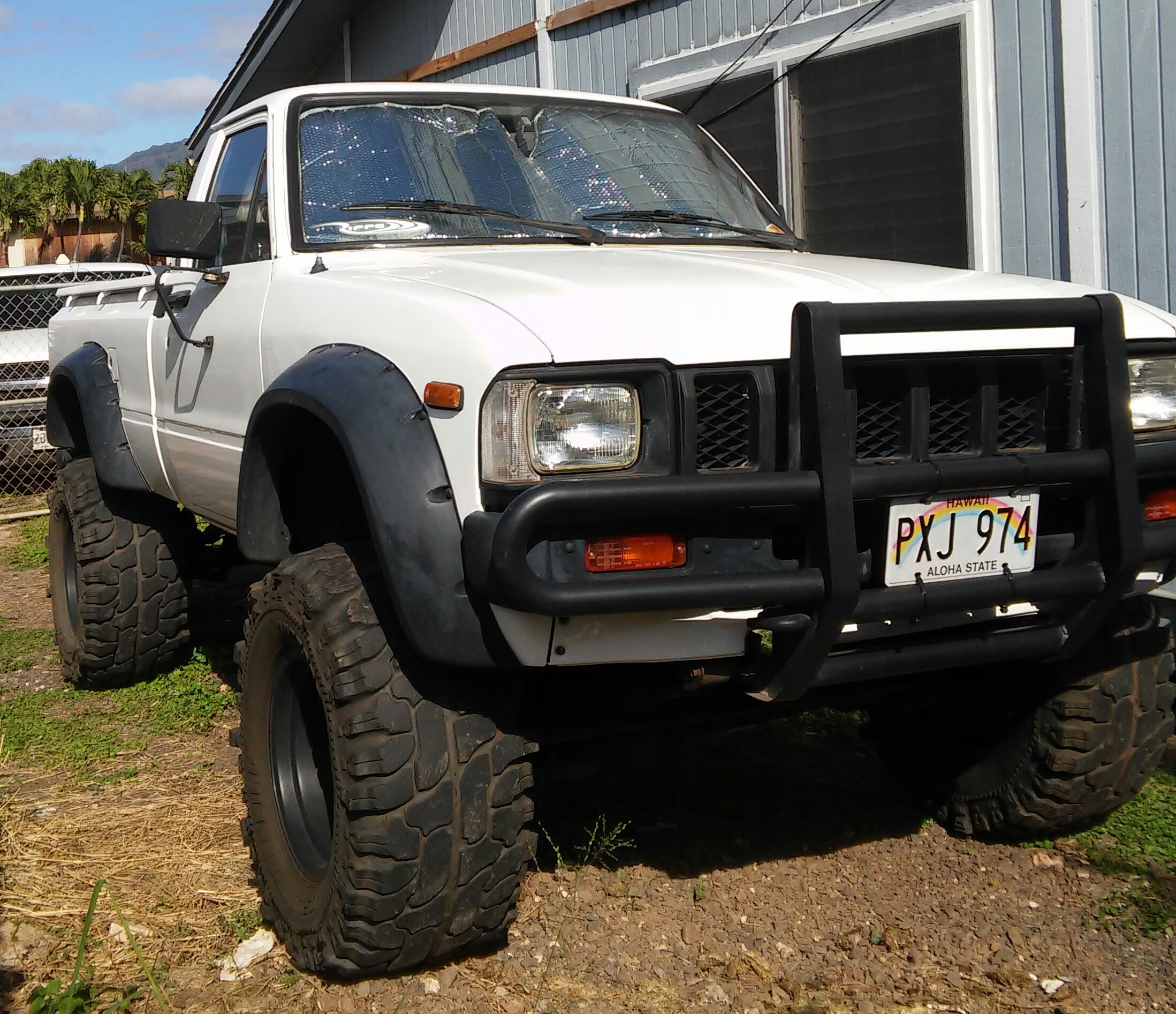

front tube bumper manufacturer
Anybody know the brand of my bumper? I have yet to see one like it. My rear bumper is smitty I'm positive just by the look of it. Front bumper idk
