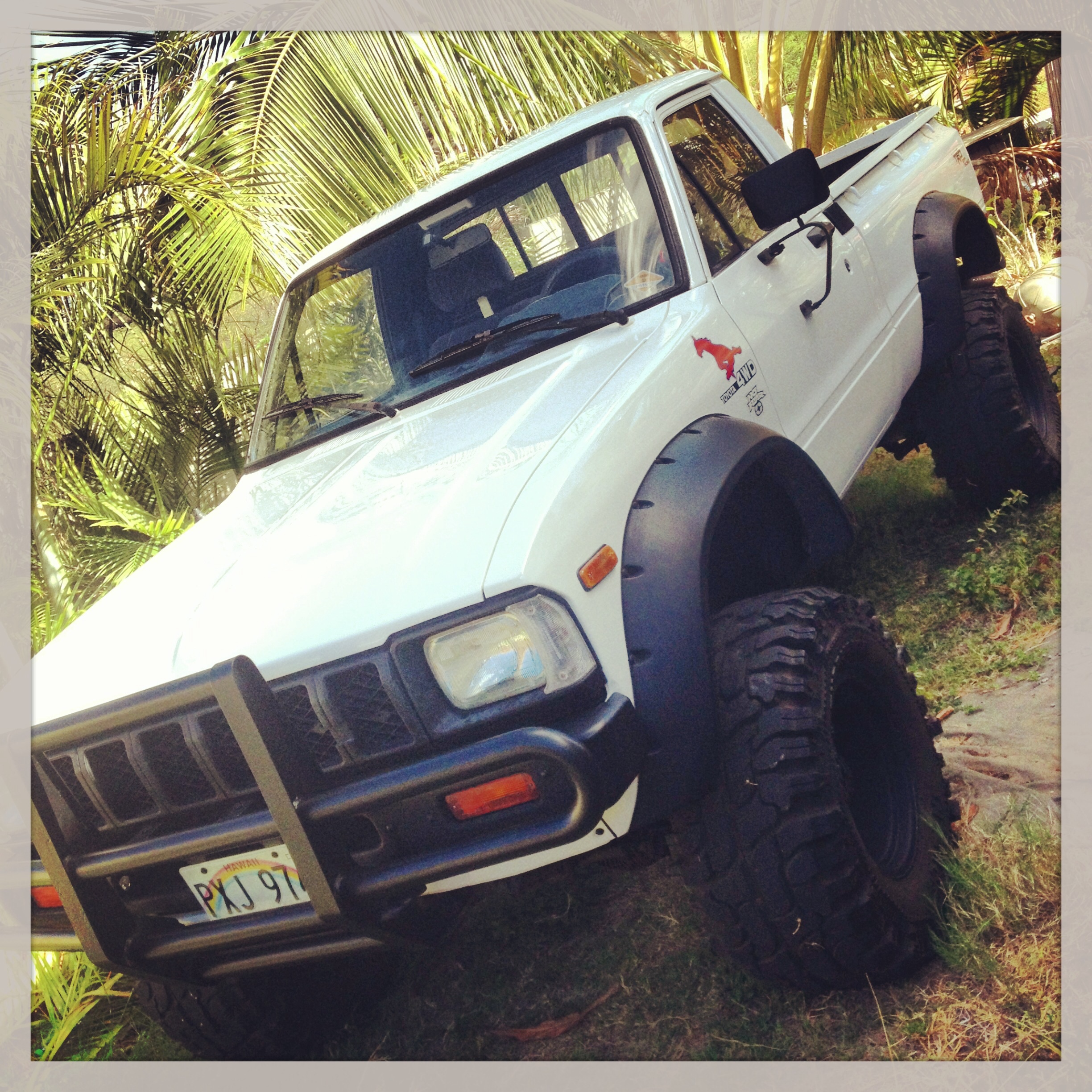

I always wanted a off road yota since I was a teen and finally got one! Alots been done to it already but I plan to clean it up even more. One owner for $4,600. Overheating issue at high speed (runs normal if I stay under 45 mph). Changed t-stat but still does the same. Gonna change the water pump now. Frame has surface rust so I gotta learn how to kill it and what to paint it with. Overall a clean 83 especially in salty Hawaii.

Good looking truck

Thanks! I luckily found a deal. I know there's nothing like building up yourself but just don't have the time.

PLEASE let me know if you ever want to get rid of those Bushwacker fender flares - I will gladly pay you a premium for them! Better yet, you could do the whole community here on yotatech a favor and send them off the Corey (Slacker on here) at Toyota Fiberglass so he can make a mould to reproduce them for the rest of us. I'm pretty sure that he can do it without damaging your originals. Great looking truck though!

I'm figuring the fender flares aren't made anymore?

You got it, they are extinct. But I love those flares so I search weekly for somebody that may be looking to get rid of them.
