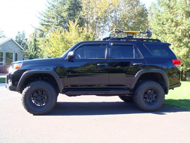

Here is my 2013 Trail Edition with KDSS. I am running Icon Extended Travel Coilovers in the front with Light Racing UCA's, OME 898 Coils in the rear with OME Shocks, and Metal Tech Offset Lower Links. I am happy with this setup. The stiffer springs in the rear will allow for additional weight when I eventually get a rear bumper.
Check out T4R.org if you get a chance. There is a 5th Gen section full of build threads and a wide variety of setups you can look at. Way more 5th Gen info over there.
Good Luck!
