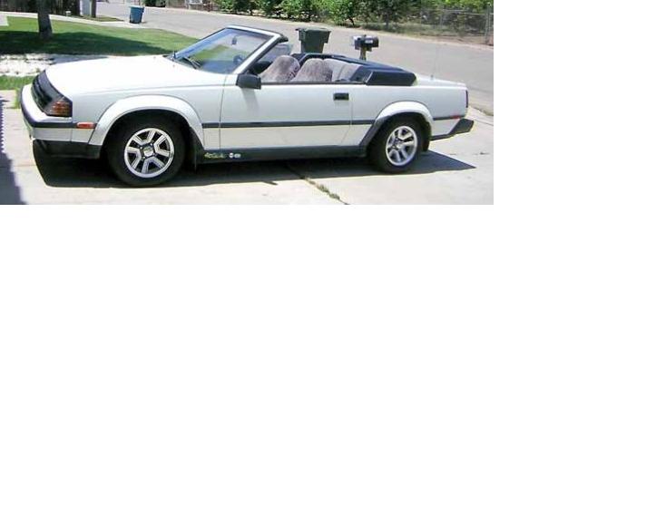

How do I post a photo of my Celica on this website? I tried down loading in my info but it didnt work.
Old Jul 20, 2005 | 08:35 AM
1985gts's Avatar
Joined: Jun 2005
Posts: 27
From: Corona, Ca
Here is my 1985 Celica GTS convertible.
Attached Thumbnails 85 Celica GTS Convertible - junk yard bound!-1985gts.jpg
