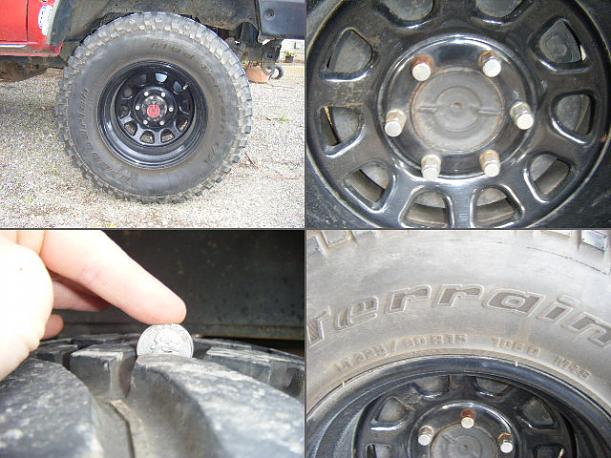

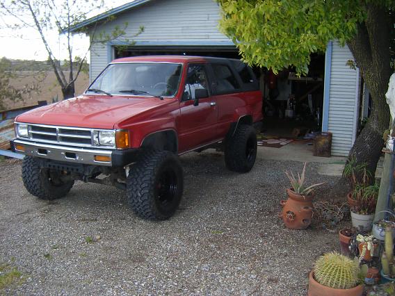

This is my new to me 87 runner, the red one. Love it and I wish I had bought one a long time ago.
P/O had these wheels on it when I purchased it.
One major concern that I have is... are these tires too big for a stock 22re setup? LT325 / 60 R15 are they robing horse power and MPG? Im thinking I would rather have more narrow 50 R15 and narrower rims. Plus the rear wheels rub the top of the fenders (out wheelin) and the front wheels rub the frame.
Is this current tire size going to stress my drive train and clutch?
Im thinking of going with the same looking wheel as the white 4runner that I found on the web.
Any guess as to what size the white 4runner has on it?

I like the look of those tires, never seen that size. Mind telling me what brand those are? THanks in advance!
BFGoodwrinch Mud terrain

Thanks for the reply, i'm going to have to figure out what its going to cost me to get a set of those to AK! Any idea what size rims those are on, must be 15x10s?
