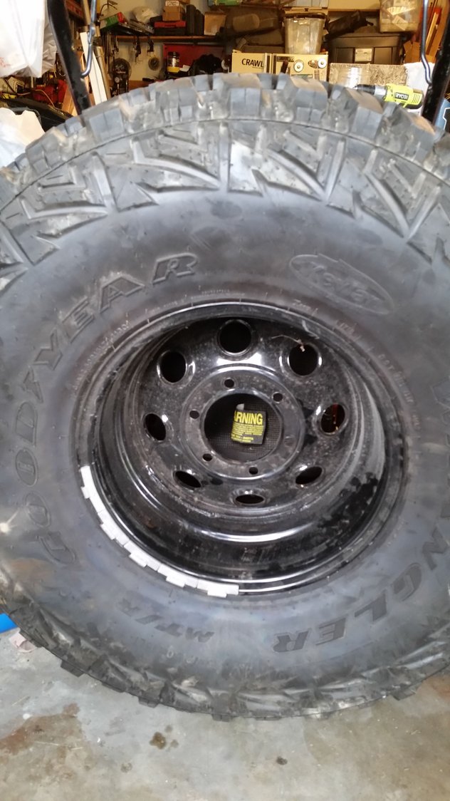

I have Goodyear Kevlar Wrangler MTR's and would never buy another set. Took one set back because 3 out of 4 were out of round and impossible to balance.
2nd set was a little better. If the truck sits for a week it is like driving on a set of bias ply tires.
Here is a picture of my spare, mounted on a brand new rim that was checked as true before the tire was mounted. It also took a ton of lead
Goodyear Kevlar MTR'S are one of my biggest mistakes

I have the GY Duratracs on my 100-series Land Cruiser in a 285/75-16 E-rated tire. I do like them a lot, and got them because they were new at the time and seemed like a nice "hybrid" or very aggressive AT tire that nobody else was offering back then. I want to say I have around 50k on these tires and am now somewhere around 8-9/32 of tread leftover - perhaps another 30k? They've held up amazingly well for street use but I don't take my Cruiser out in anything hardcore and can't comment on the issues that many complain about regarding weak sidewalls and slicing them up on boulders and sharp rocks. I have, however, noticed they do have a rather soft sidewall which is noted by increased body roll on the road - this was resolved by upping tire pressure into the low 40s. I think the E-rated also helped stiffen them up, but the almost 6000lb pig using them doesn't help either. I'm sure that a C-rated 33x12.5-15 would be super soft and likely where lots of complaints come from regarding the sidewalls. Balance-wise, these tires are pretty good and don't have nearly as much weight as the MTRs Dropzone pictured. Sound is obviously going to increase over a street tire and I only hear them when going 35+mph. Definitely rotate them regularly, I've been doing like 5k+mile intervals and it's too much time in between and I've noticed some cupping starting to happen.
