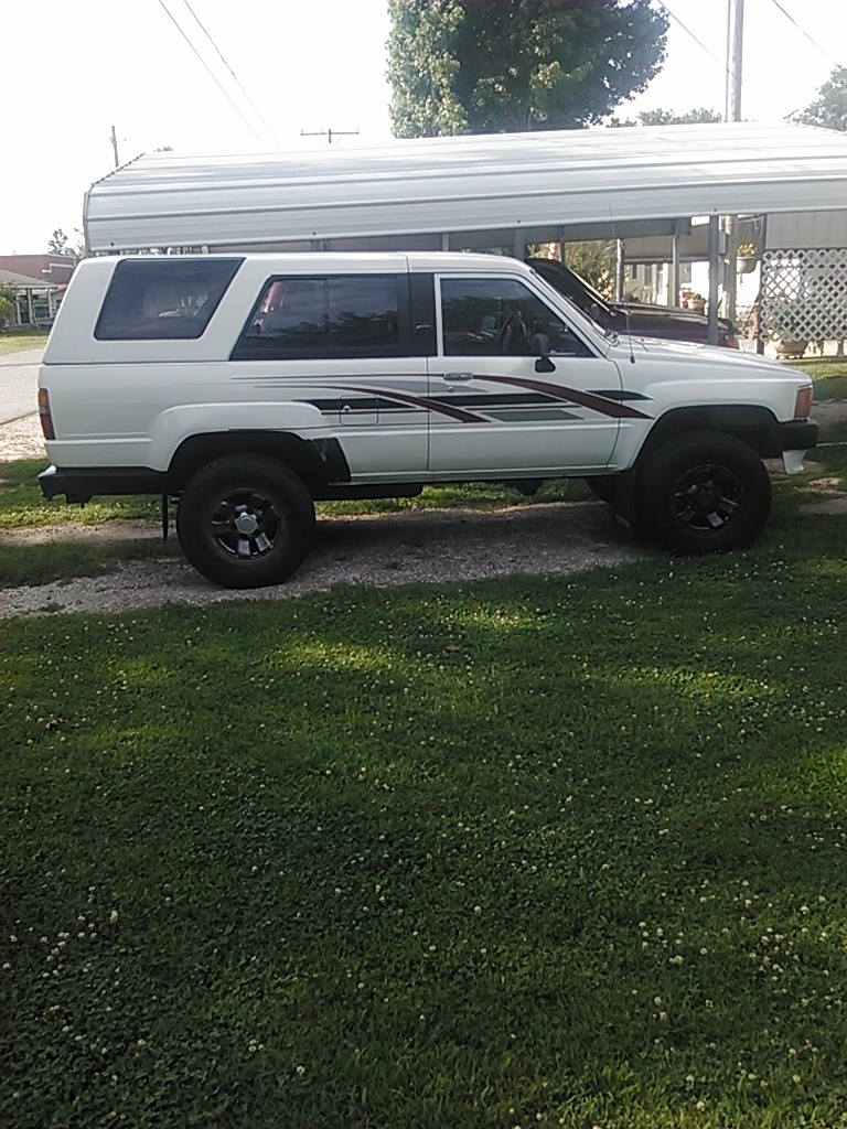

These are what is called the Tri Spoke Wheels from Toyota. They are around the 96-00 year time frame. I got them off of craigslist so dont know what they come off of. They are 15 inch wheels.

I don't doubt it. On the 95-02 Taco/4Runner's there was both 15" and 16" wheels equipped on them. Not all of the 16" equipped rigs can fit 15" due to brakes interference unless you bust out a grinder on them.
The above pictured wheels came in both 15" and 16" sizes.
