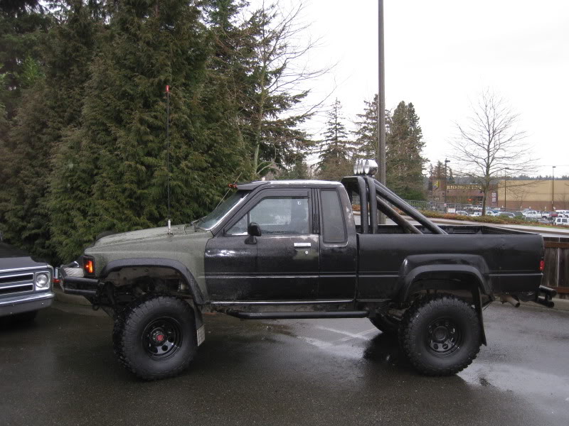

Does this count? waiting for spacers.....

They hit on the 3rd gen's that can fit 15" rims, the little lip on the rim hits on one place on the caliper, bs has nothing to do with it, I have them on my 4runner but i run spacers. They did not fit without the spacers.... But i need the spacers for 12.50's to not hit on my uca

That's exactly my problem. The 1250 hits the uca by about a quarter inch. I'm thinking 1.25" spacers from wabfab should do the trick but I'm still debating making my own.

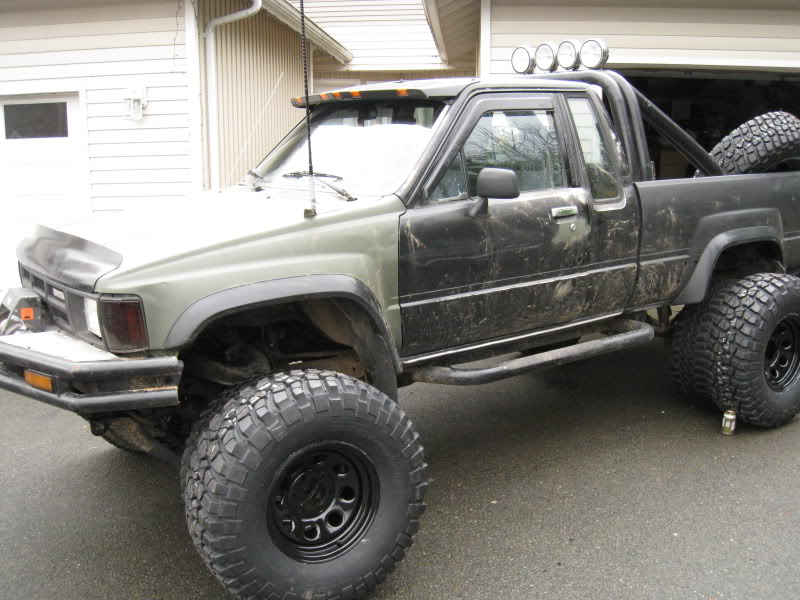

Finally got em on. 1.5" spacers. Now I need to relocate those mudflaps back.

nice man those look good!

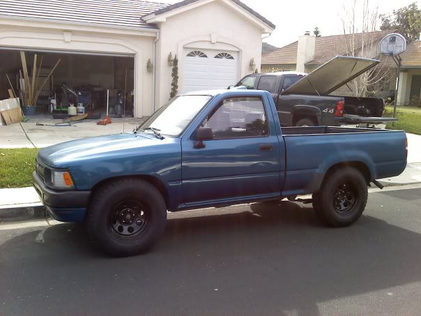

finally got my yokohama geolander at-s on them so i was able to put them on
