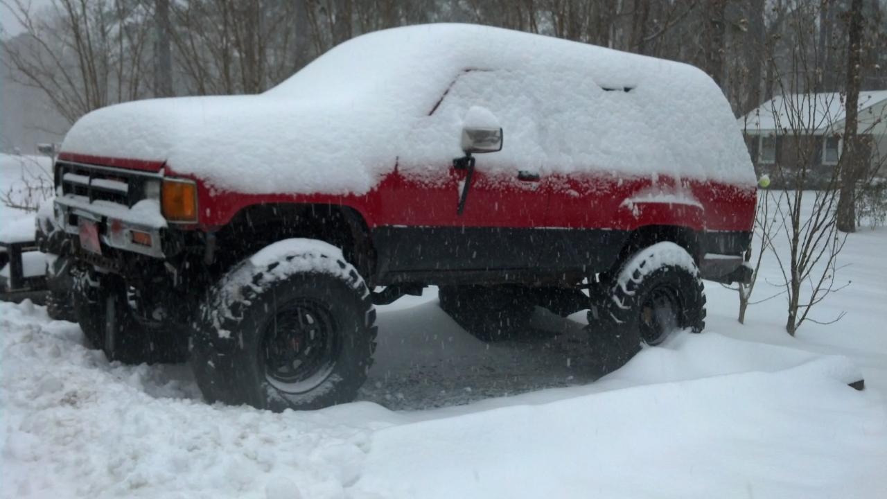

88 4runner on 36s
I have a 88 4runner with 6 inch rough country lift with 36 12.5 16.5 no cutting with a lil squat in the back due to wore out leafs I havn't replaced them yet im working slow to a sas I got the axle just need the other parts
Attached Thumbnails 40s on an 88 4runner possible?? Even if they are free?-img_20140211_171100_265.jpg
