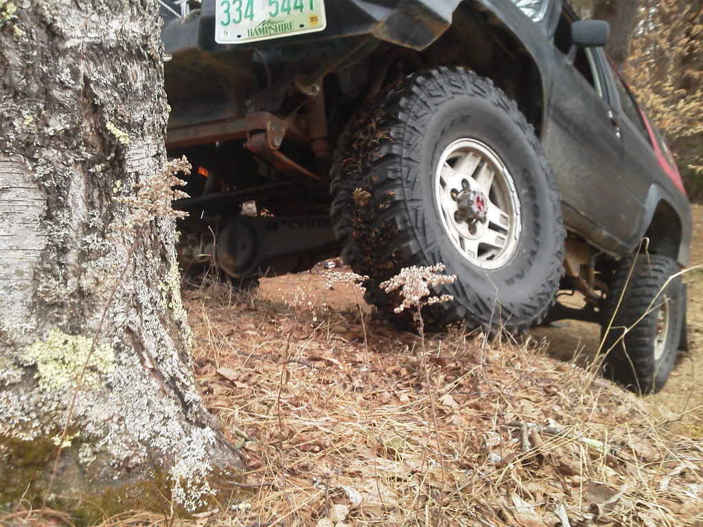

I ran them for two years on a 4runner i just sold. The tire shop didn't have a problem seating the bead, i don't see why there would be an issue seating the bead. I feel like putting them on a narrow rim is like a cheap bead lock. Iv run them down to 8psi out wheeling and drove home on that pressure. You will need to run less pressure even when street driving in the 4runner i ran 25-27 to get even tread contact with the road. If you do go this route, mount them up and drive on dirt then pavment. The pavmant will take the dirt off where there is contact with the tire, adjust your pressure from there.
I didnt just run around town with that set up I visit friends and family in my home town two hours away almost every other weekend, so i would say i put 20-30K miles on them with out a problem.
