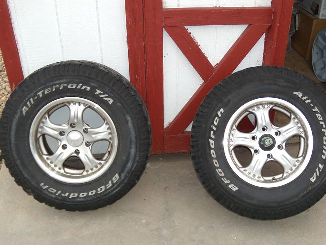

revive a thread! also curious
revive a thread.... I just got a set of these myself... did they fit? I never realized they were 8j x 16 .

they do seem to rub the A arms with the rubber. I believe wheel spacers are the solution.
I have since taken them off my 99 Runner with OME881s (front) and 2" body lift, and they are for sale!

I'm in agreement with others that corrosion is an issue and the center caps are almost worthless.
I ran them on my 99 for about 4 months but the rubbing of the tires against the upper control arm was worrying me.
