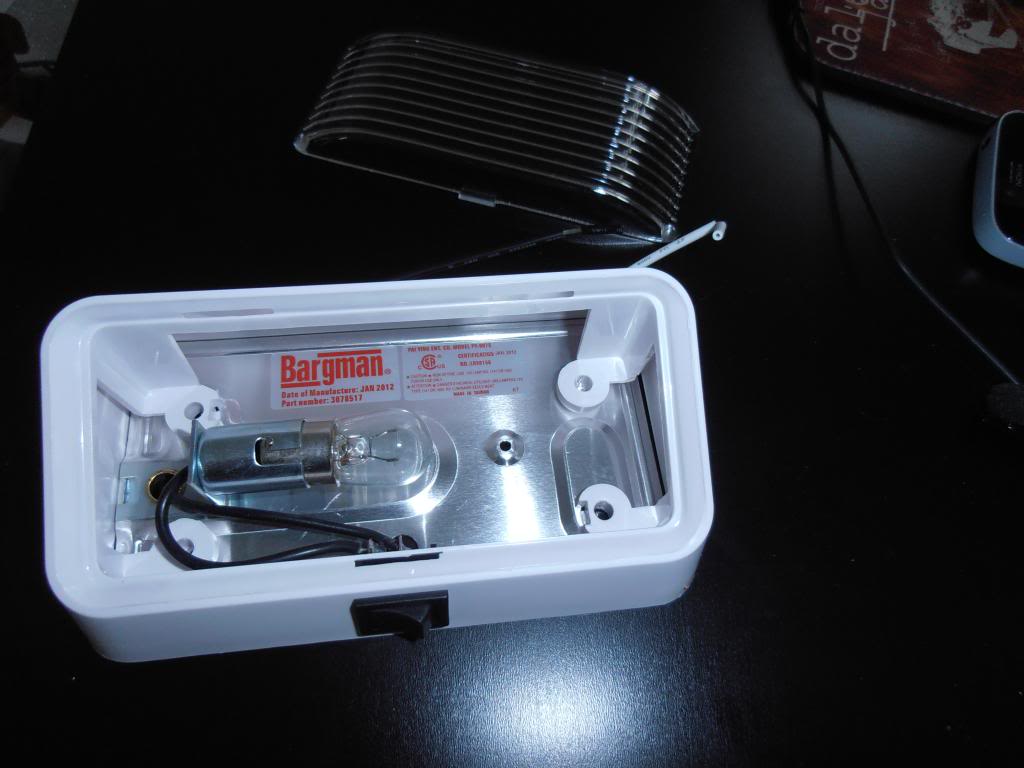

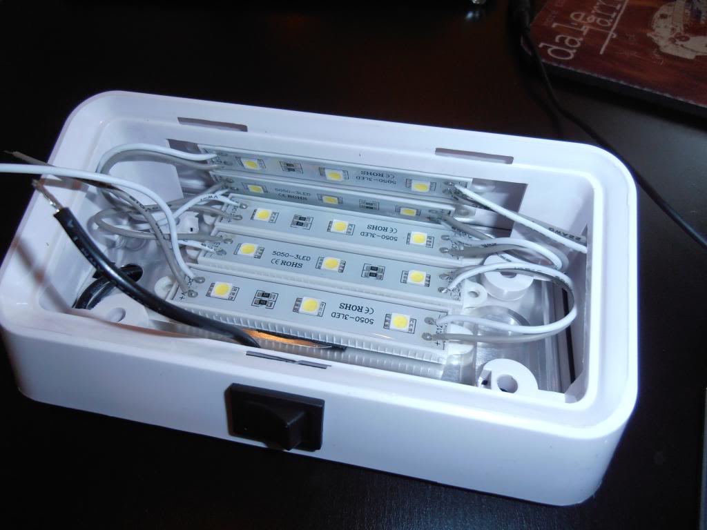

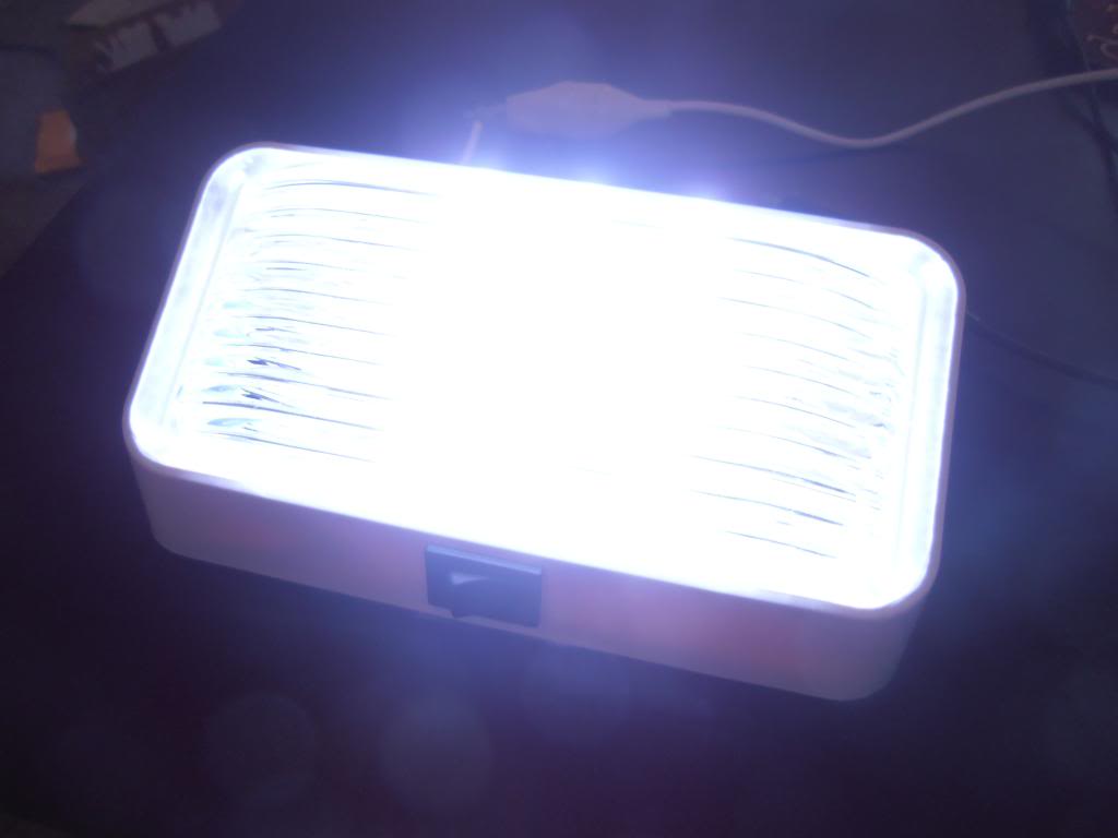

porch light:

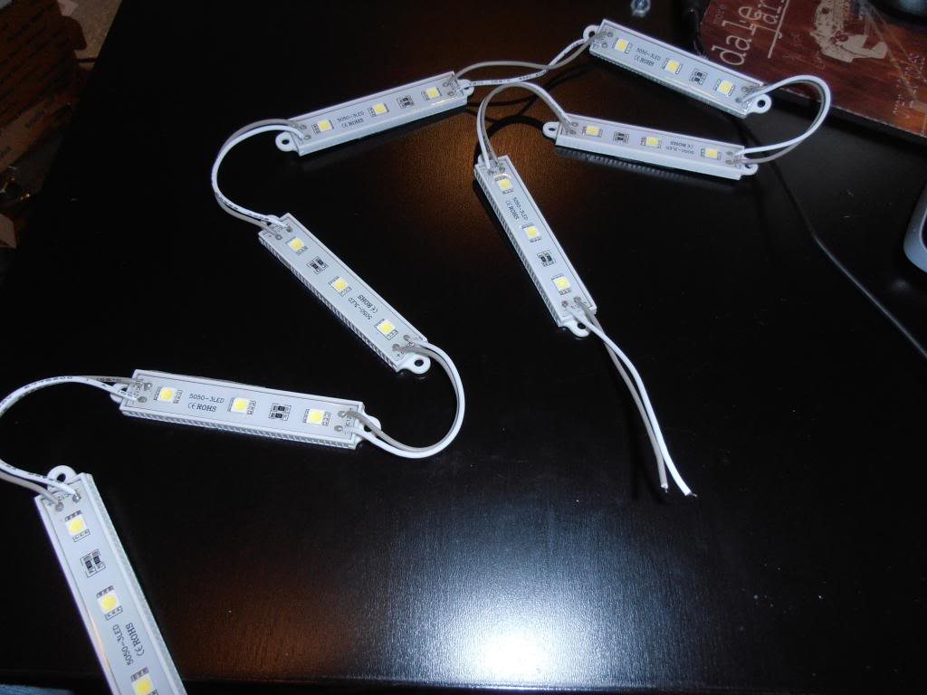

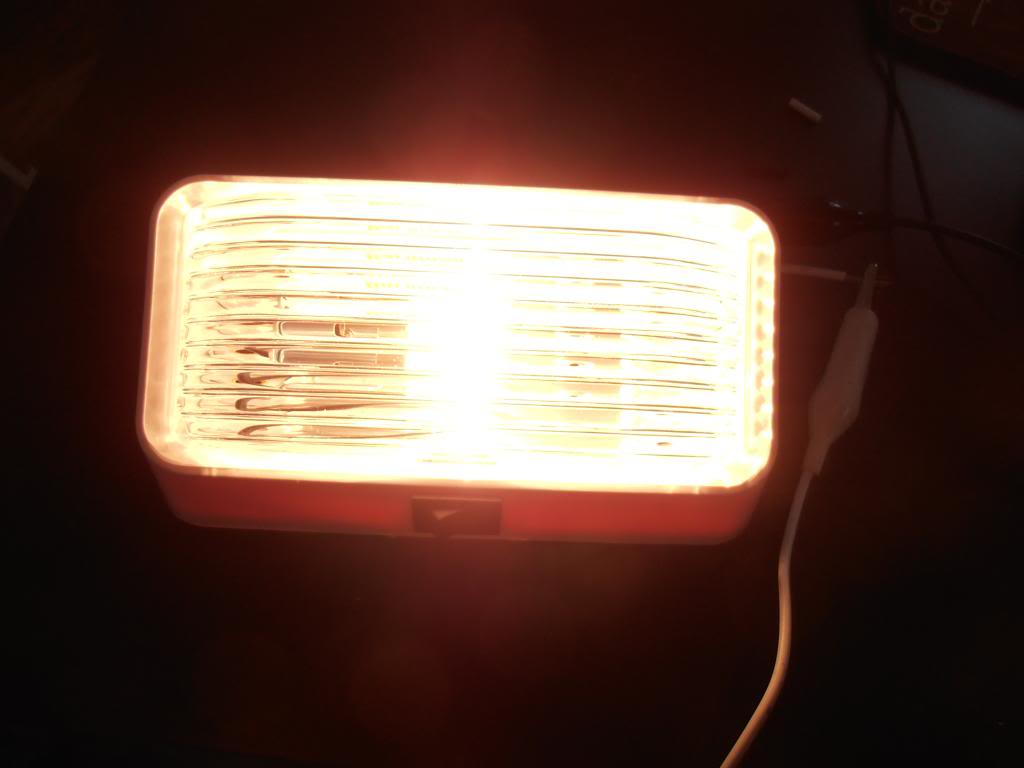

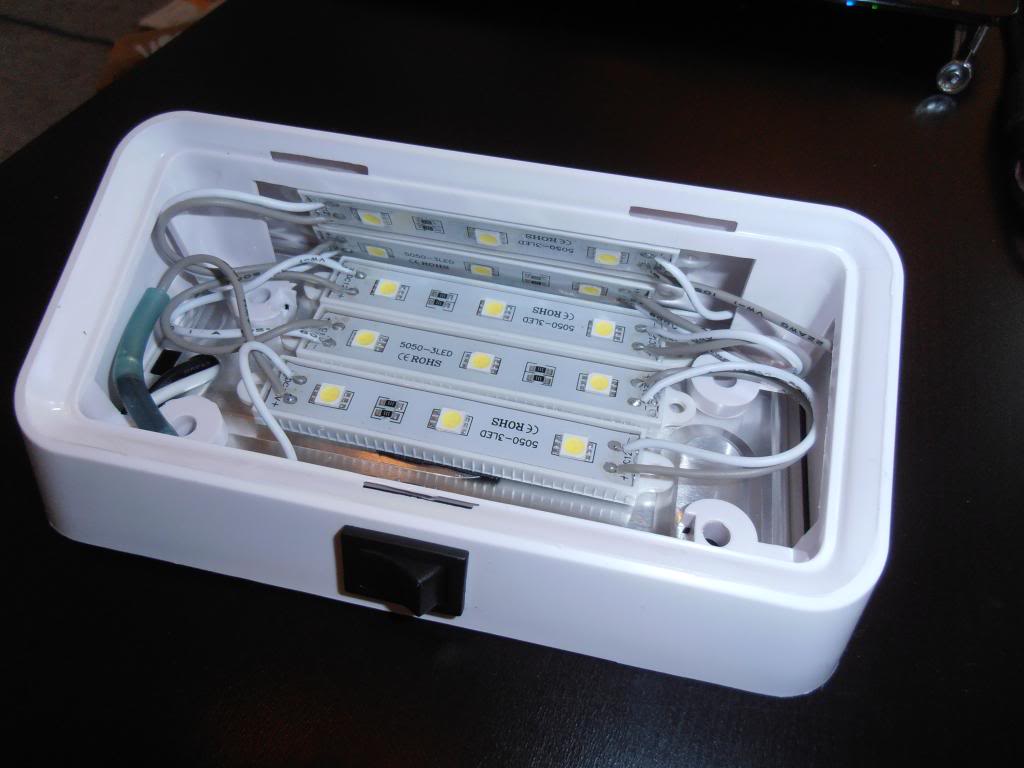

i wanted one, but didn't want to have an incandescent bulb on there after seeing what happened to the old one (mostly melting). so i decided to modify one to put a string of led's in. i already had them, so it was a no-brainer. results were most excellent
(all pics shot with the same exposure: f-3.0, 1/30)

Let there be light! Lol... That will surely light up ur porch and more.

Wow, that's really bright! Nice work

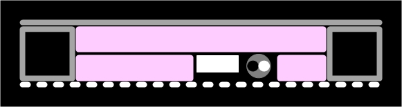

i figured out what i'm going to do about the ceiling to make it look decent:
where (top to bottom, left to right):
aluminum skin
½" foam board
½" foam board, led lighting, wiring, foam
translucent plastic

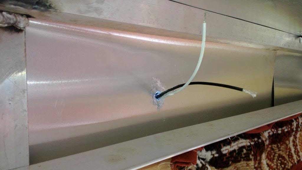

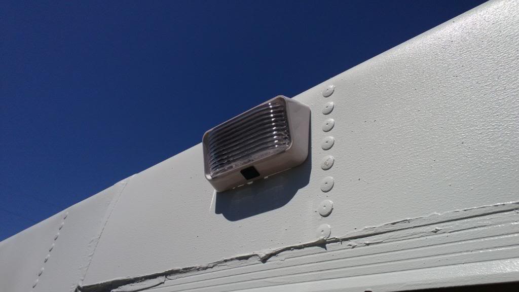

popped it out this past weekend and installed the porch light. using high-strength tape, i managed to only drill one hole in the roof (sealed with goop)

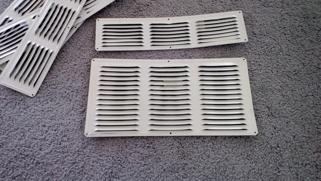

in other news, i ordered these screens/vents to put over the hole i'm gonna make for the a/c. they're aluminum with mesh screen to keep the bugs out, and they were fairly cheap. the big ones are 16" x 8" and the thin ones are 16 x 4

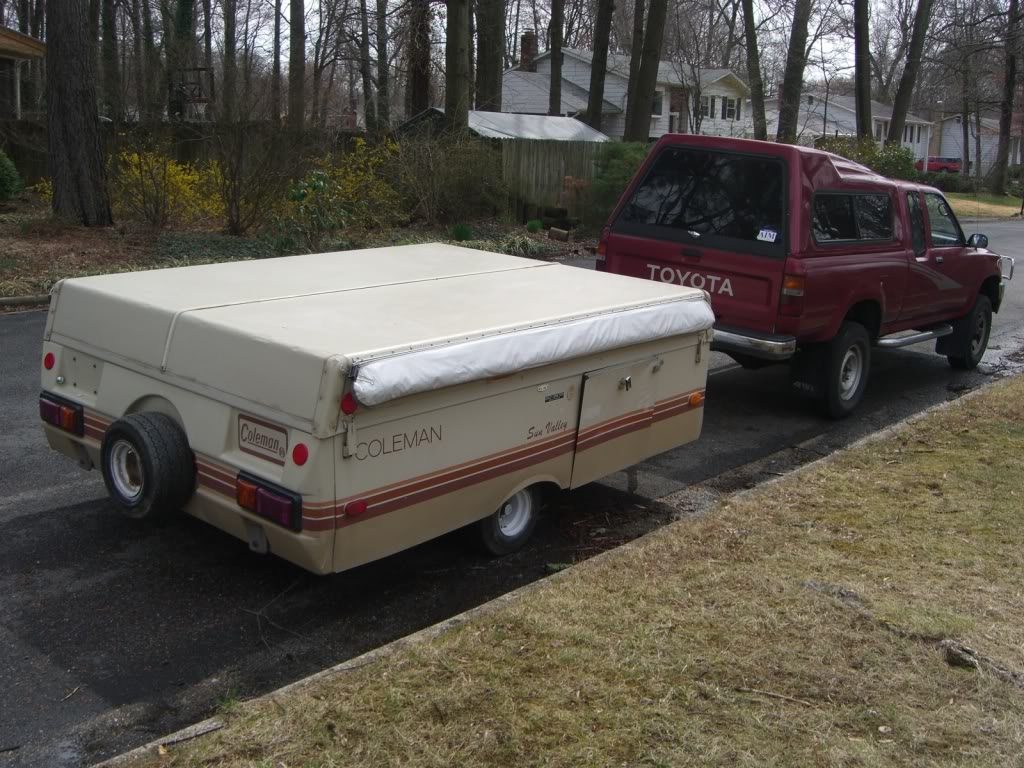

very first image of the entire thread shows how the awning gets mounted:
you can just see the bottom of the porch light sticking out from >ahem< under the awning

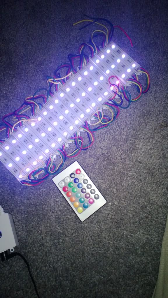

every camper needs cool lights!

it has 16 steady colors, each dimmable, and 4 flashing/fading modes. i like it (especially for how cheap it was), but i don't think i'll add flashing-to-music features just yet.
and for the roof, i figured out a decent way to cover everything and still have light come through: instead of plastic, i use fabric held up with velcro. that way, it's easy to take down if i need to fix anything, i can swap out colors easily, it's translucent, and it's cheap
