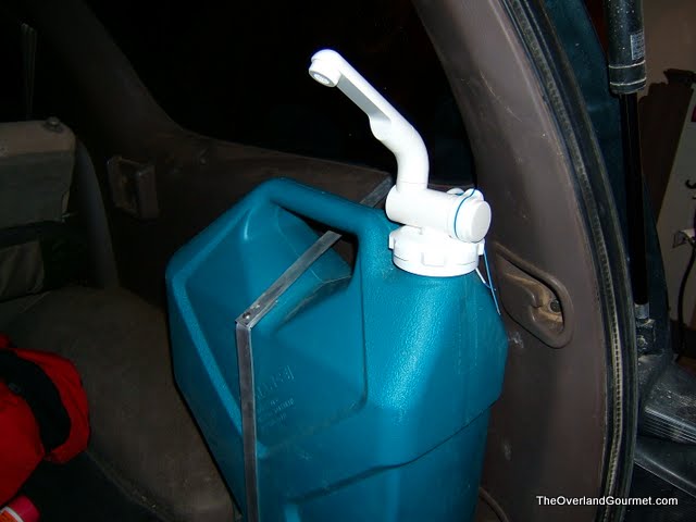

We live out of the back of our 4Runner for days at a time and to make life just a little easier we built this inexpensive on-board water dispensing system. The water tank sits adjacent to our cook stove and allows us easy access to fresh water when we cook. We can also roll down the back window to fill water bottles while we travel.
Parts List:
1 Whale 881 submersible pump
1 Shurflo 94-009-01 faucet
3' of 3/8"ID tubing
3/4"NPT-1/2"NPT reducing bushing
7-gal Reliance Products Jumbo-Tainer
4' 18ga wire
1 12V cigarette outlet adapter
Tools Required:
Soldering Iron
Hacksaw
5/16" drill bit
Drill
Dremel Tool
Finished Product
Inexpensive on-board water system

I have toyed around with the idea of adding a battery pack so I can use it outside of the 4Runner, but since we cook out of the back, it makes it nice where it is.
