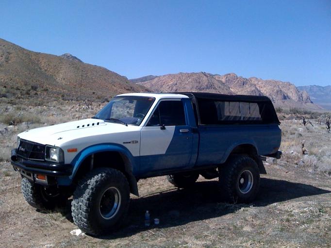

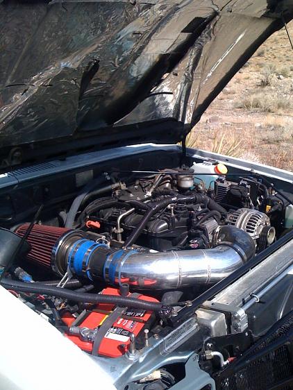

2007 All aluminum 5.3 H.O. LH6 with AFM(4cyl mode).
Attachment 80451
Attachment 80452
Dude !! Wheres the right up on this one..
Nice truck ..
Nice truck ..
Some old pics.
http://s418.photobucket.com/albums/pp265/VEGASROBBI/
