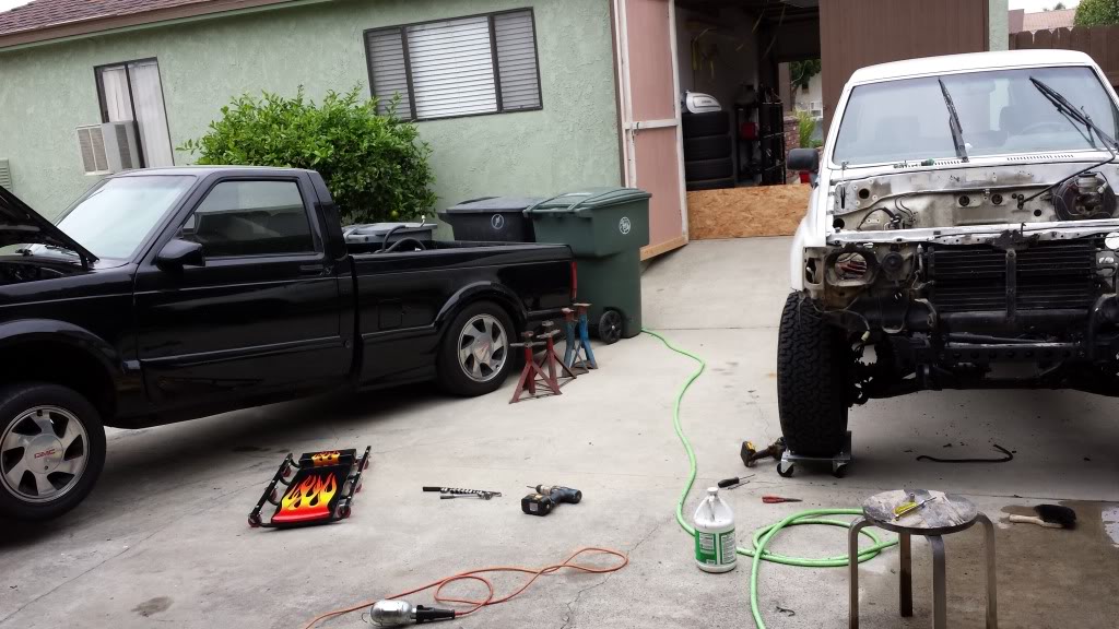

I'm not sure if I'm breaking new ground or not, but I am installing the engine and tranny from a 1991 GMC Syclone (~66K miles) into the 4runner! The 4.3 and 700R4 combo is a swap I've read a lot about on this and other forums. I've named the project Tsunami as sort of a joke on Syclone/Typhoon. A "tsunami" decal in the lettering style of Syclone is in the works.
Currently a donor Syclone has been acquired and both motor and tranny sets have been pulled. It was a little heartbreaking to tear into the Syclone because of their rarity, the only consolation being that this particular Syclone had a salvage title and missing cladding. VERY cool, scary fast, badass truck which I debated on simply restoring but I am sticking to the plan. It's going into the 4runner. I'm losing the Syclone's full time 4wd in the swap so it won't be the same 4wd hard launching monster but it should still be a lot of fun to drive.

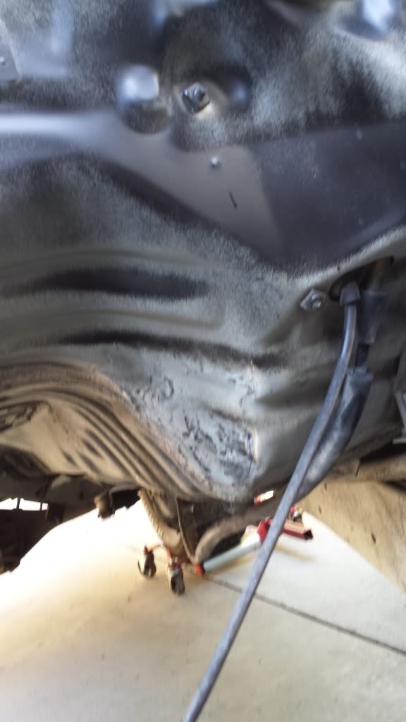

Hammering out more clearance for the 700R4. No body lift in this swap.

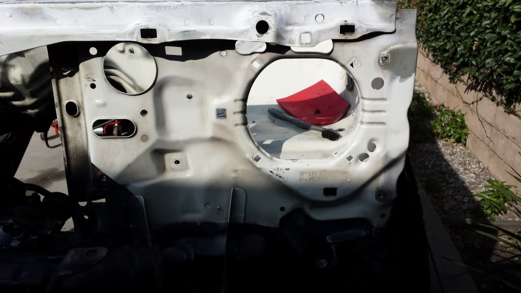

Cleaning up the engine bay. Almost an inch thick crust of sand/dirt/grease built up in some spots from various slowly leaking fluids.

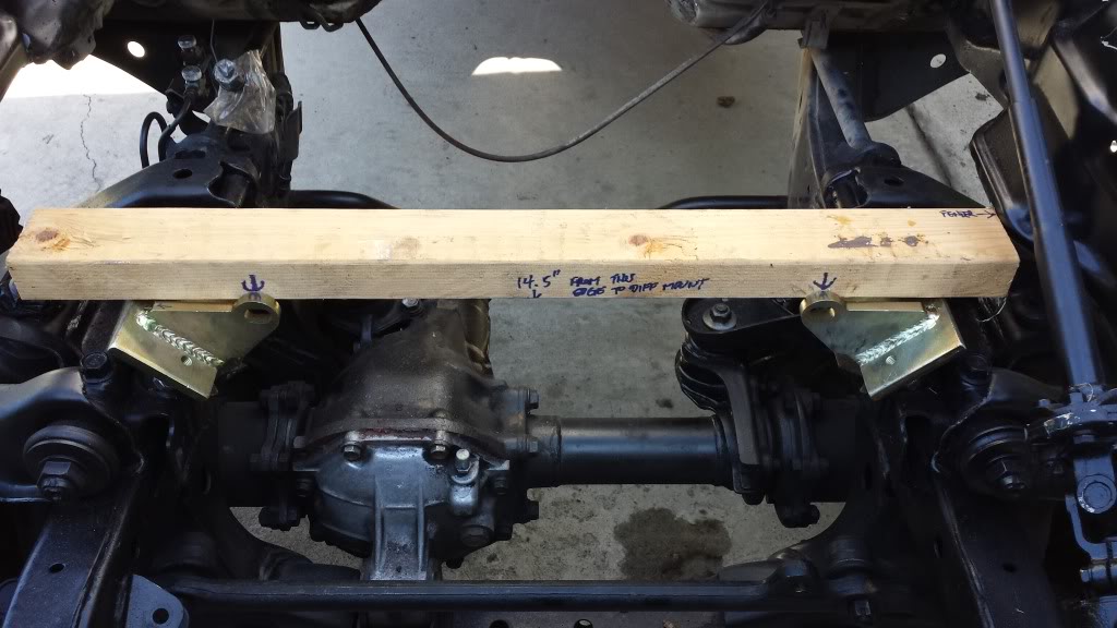

Taking some reference measurements using the Advance Adapters engine mounts bolted to the stock mounts. Way too high!

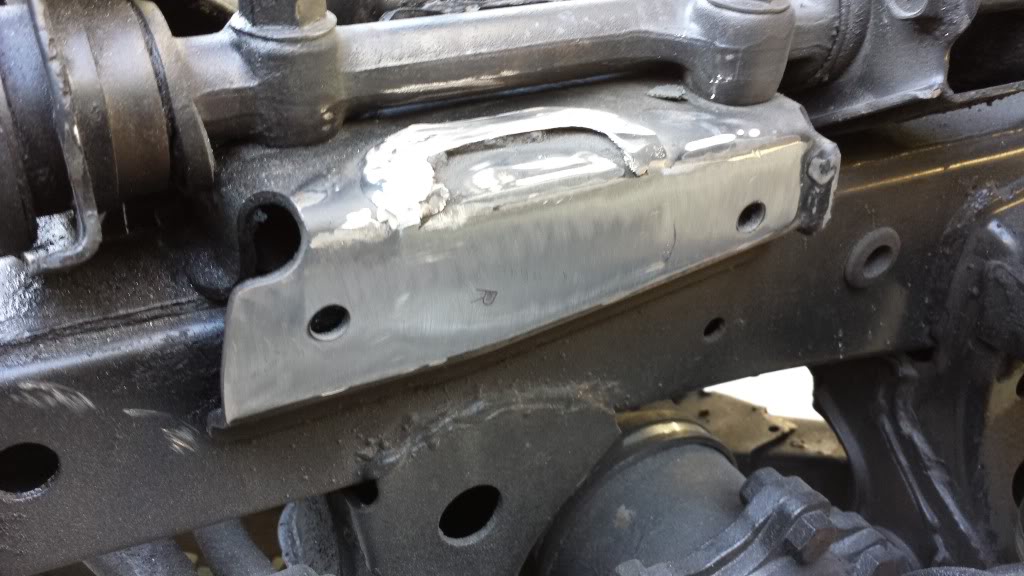

Stock engine mounts cut out and smoothed out in preparation for welding the AA mounts directly...

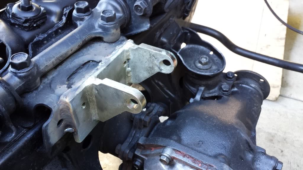

Test fitting the motor mounts. Shockingly good fit. The mounts welded directly turned out to be the exact correct spacing. Lucky coincidence? By this time the engine was painted with 3 cans of Rustoleum Satin Black.

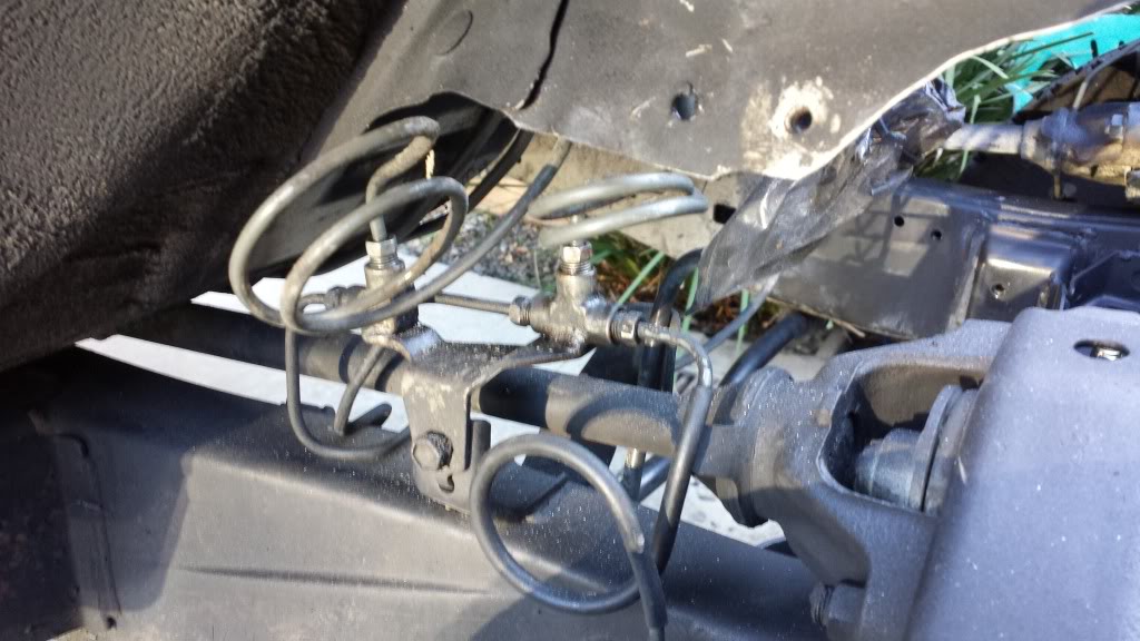

Brakes lines spun into the wheel well ares to create more clearance for the exhaust pipe that will run close to the passenger frame rail. The fuel line will be moved to the driver side frame rail.

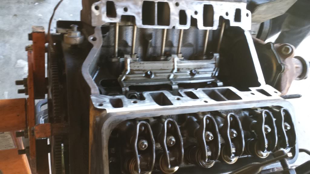

Syclone motor compression tested and intake manifold resealed. Vacuum hoses to be replaced, basic tune up, and various components replaced for peace of mind.

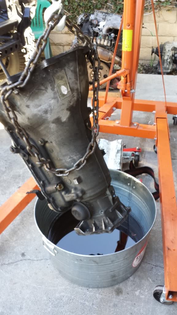

Draining the 700R4 for a fluid change...
tackwelded the mounts
this mount had to be shaved a bit to give clearance to the starter
finished welding the mount. this isn't going anywhere. there was a slight "tilt" upwards in the rear of the mount which was the optimal angle for my particular install and combo of components (4.3, 700R4, NP241).
