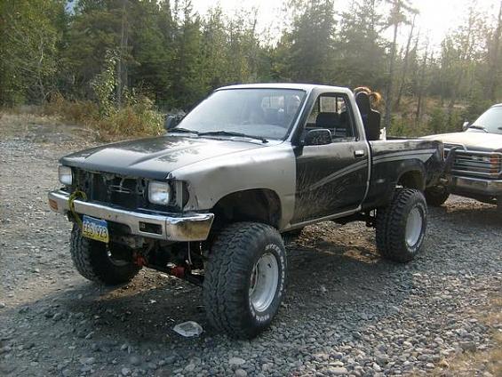

well after some thought on what i want. I chose to do a ford 289 swap in my 1990 toyota pickup. ill be picking up the motor tomorrow after noon it comes with a c5 trans. but ill be using the toyota v6 trans. with the ford 302 bellhousing adapter from north west offroad. should be a fun and different swap, i just got tired of being past on the road with my 22re. dont get me wrong i love that motor and ill keep it and look for a truck that needs one because they are the best for offroad in my opinion. ive gone farther than any other truck with that motor, but i think this will be a really fun and cool truck when its done. ill also be painting my truck either gloss blue or gloss red with a black bed liner strip on the bottem. havnt figured that out yet so if guys want throw me some paint colors theres a pic of how the truck sits now 4 inch lift with 33s

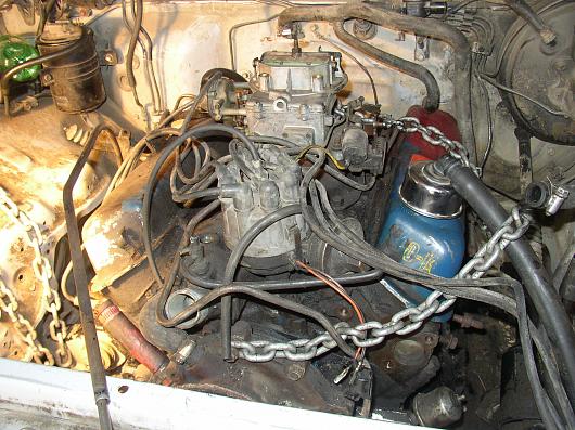

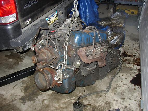

well i picked up the motor today. its a ugly blue but ill get that fixed with some paint dont know what color. probably red but we'll see. it turns over freely and feels like its got good compression.it came with a c5 3 speed auto transmission, so i don't know a lot about the ford trans. but from what ive read the c5 is pretty much the same as the c4 just beefier lol so can anyone tell me if the tranfercase adapter from advanced adapter would fit http://advancedadapters.com/product/1710/50-4400.html if it does it would cheaper than buying a bellhousing adapter and save me some money.

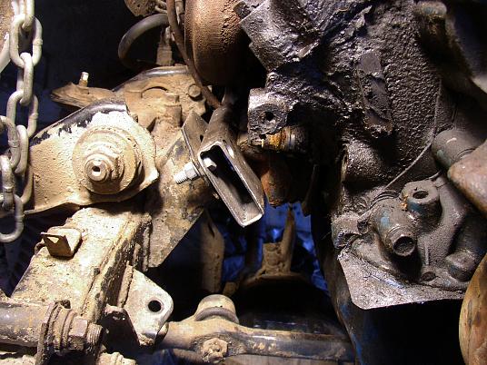

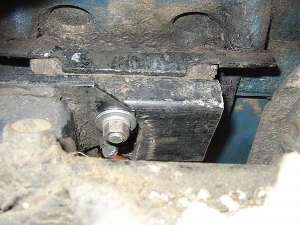

after a couple months of not working on it i decided it was time to finish it. yesterday a friend of mine made motor mounts the bolt in to the stock toyota frame mount. i just need to figure out how to get the electrical and radiator in heres some pics of the motor and the mounts.
