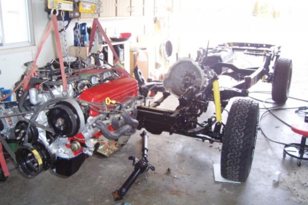

I am just completing a 5.0 efi swap on my 84 sr5 pickup. Here is a few things I've learned so far
1 use the mustang flywheel but realize that it is smaller then the truck flywheel normally used in the kit. You will have to modify the starter flange my drilling a new hole and moving the starter inboard and in my case grind a little off the nose of the starter to clear the flywheel teeth at the revised angle.
2 headers - I tried to use the stock ford mustang headers and ended up just cutting them all apart and making new ones with the pieces and some new j bends, if your headers are still rust free and solid this works good but allow some time to fab the new headers (it took me 20 + hours)
3 the slave cylinder will be very close to the exhaust on the drivers side especially the line which faces straight forward. I made up a tight 90 fitting by welding two brake line fittings together and also added a tin heat shield to deflect the heat.
4 the emergency brake cable needs to be moved or changed. I went to the wreckers and got one out of a newer model and made it fit. It has the cable running inside the floor pan. even then I had to reshape the floor pan to provide clearance for the drivers side cylinder head.
5 I`ve been told that a stock v6 rad will do the job but I ended up using a sprint car rad from speedway motors as I plan to tow my bike trailer a lot with this truck. I used two pusher fans designed for corolla air conditioned cars. They are an add on to the corolla when the dealer installs air. I used two and mounted them side by side between the grill and rad. Currently I have less then quarter inch of clearance between the rad and water pump pully bolts. I plan to make up some flush mount bolts to help with this but if I was to do it again I would try to find a later model mustang motor with the shorter waterpump and pully setup or convert the engine to this settup.
I actually reused the toyota power steering pump by making a plate and mounting it to the Ford bracket and machining the Ford pully to fit. I think I would just use the Ford pump next time....this was a lot of work and hard to get lined up.
If you plan to use the stock alternator bracket plan to use a rad with the top hose on the drivers side. This might mean using a 4cyinder turbo rad as I am not sure of the configuration of the v6 rad hoses.
If you need more just PM me or see my website
funfactorfab.ca
Another 302/5.0L swap post-trucks-tractor-pics-008.jpg
Kevin
