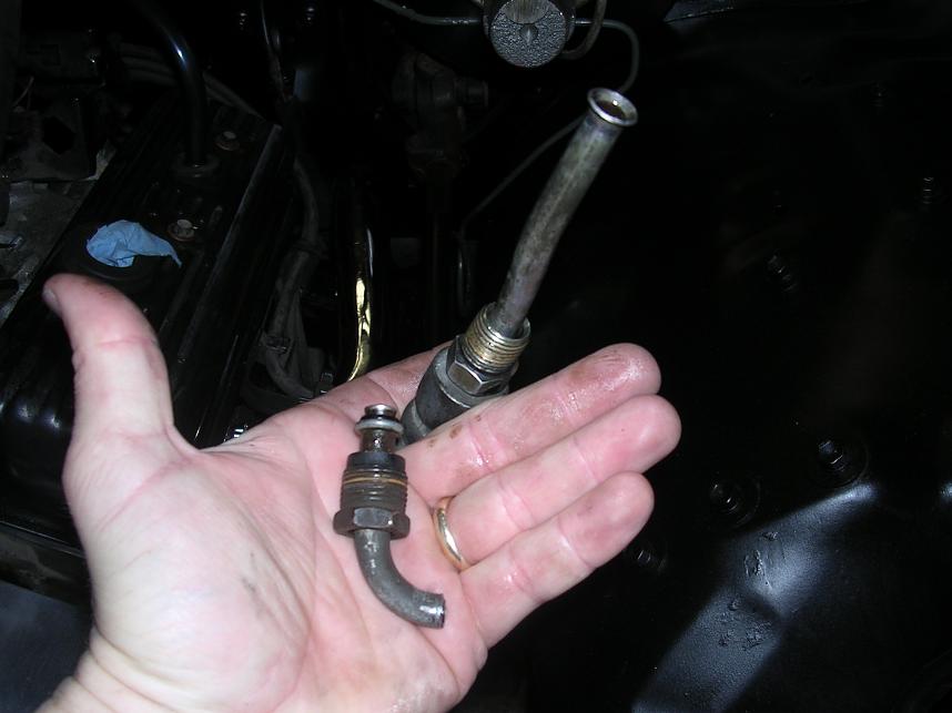

Today we reflared the PS line but experienced a little cracking on the edges. Not sure what to do to remedy that yet but any other tips would be appreciated. A couple of months back I had planned on purchasing some of these things like the p.s. hardware from Downey but they went kapoof and I can't find any of their parts all of a sudden. Anyone know where to get a hold of some of the Downey stuff? I was also planning to buy their coil springs and a few other things. Who has some Downey inventory out there? All that stuff had to go somewhere didnt it?
