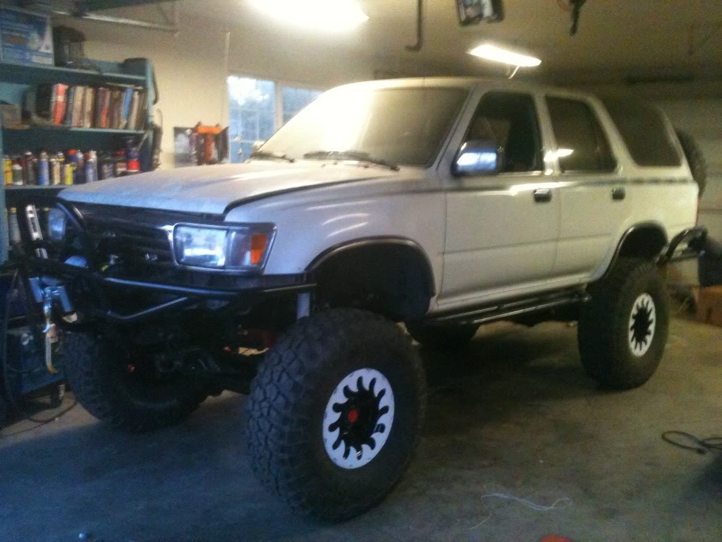

I went with a 95 cpi . They make 195 hp . The tbi is about 160 hp .Yes the spider injector can leak but they are very easy to fix.
Plus i think they look bad ass.
Old Feb 24, 2012 | 09:49 PM
James Woods's Avatar
Joined: Oct 2010
Posts: 1,626
From: Down by the River
That is one sweet looking 4Runner.

yea the 4runrun is pretty sweet but i hate the wiring for fuel injected especially when i can hook up like 4 wires and have a built carb'd tbi motor with like 300hp and half the headache. im gonna get my 4.3 bored .030 over with new pistons, heads fully rebuilt, headers, 450cfm quadrajet carb, and exhaust. looks good but im all about simplicity and performance. let me know how the 4runner gets down

thanks for the link. i think i had that one bookmarked before but haven't been there in awhile. when i purchased my motor i got a full set of gaskets that i'm going to give to my machine shop which probably cut of like 100 bucks. and james92toy is your hood just not closed or are you going to have to add spacers?
Old Feb 28, 2012 | 05:02 PM
james92toy's Avatar
Joined: Jan 2012
Posts: 151
Hood is not closed. Everything clears just fine except exhaust y pipe flange to manifolds comes close to frame.

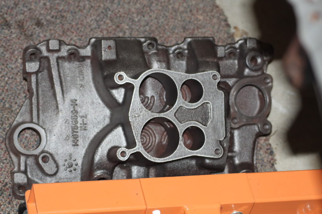

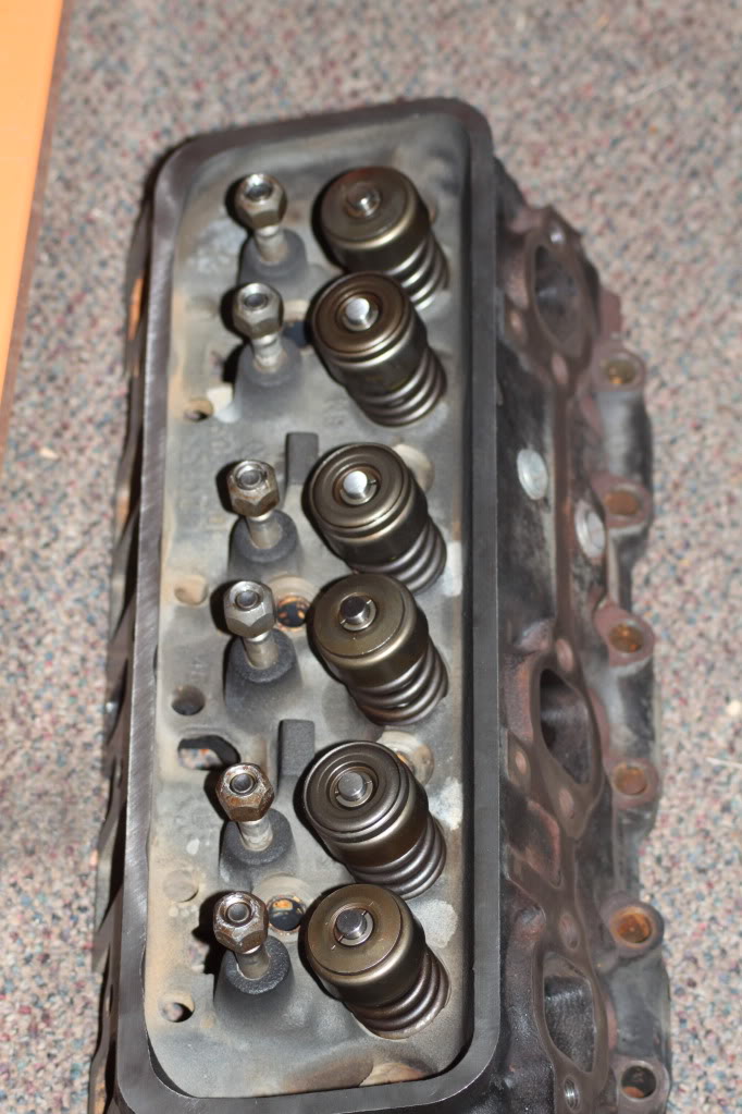

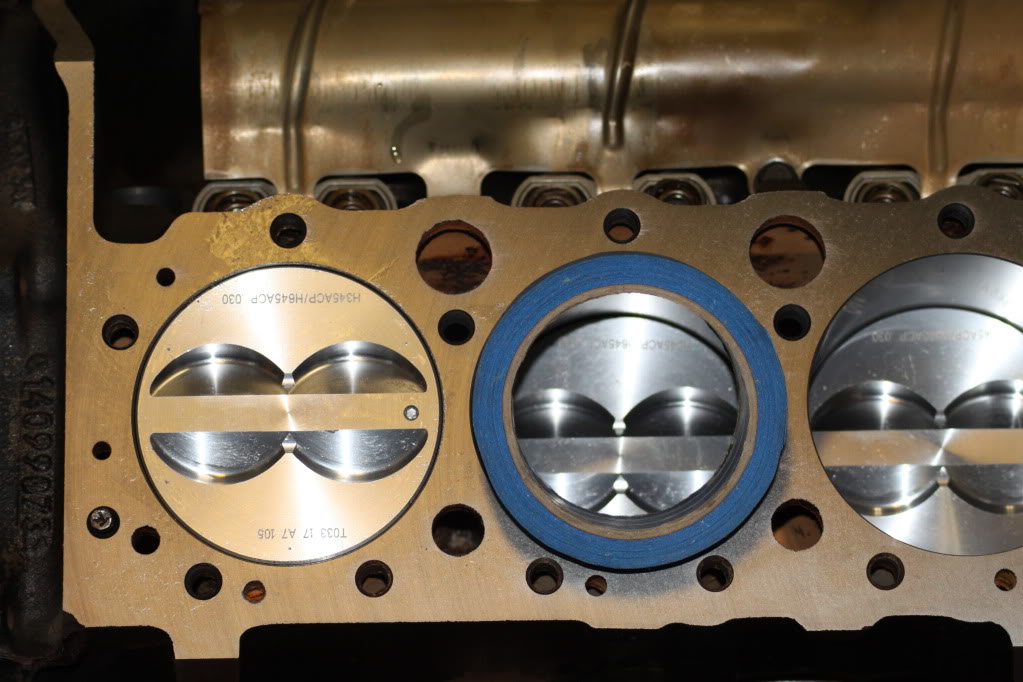

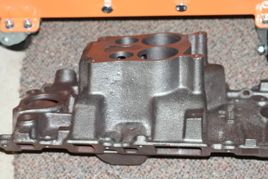

Old Mar 22, 2012 | 09:32 PM
thatsmyYOTA89's Avatar
Joined: Sep 2010
Posts: 64
From: Yorktown, VA
All times are GMT -8. The time now is 08:02 AM.
