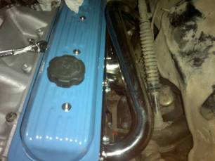

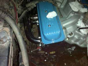

I'm new to the yota forum but this past September I completed a 355ci swap into a 1994 yota with the stock 5 speed manual. If you have any questions feel free to ask.

What kind of headers did you use

Tight squeeze on the steering? Or just optical illusion? lol. NICE!

I used the hugger headers from Northwest Offroad, and to be honest it was the only good thing I got from them.
Yes the steering was actually too close, I ended up cutting the ends off and replacing the middle of the steering with a solid metal rod that was a little smaller. Then I ended up adding 2 washers to the back 2 bolts holding the steering box to the frame which pushed the steering out to the side allowing me enough room. It was one of many complications I ran into.
