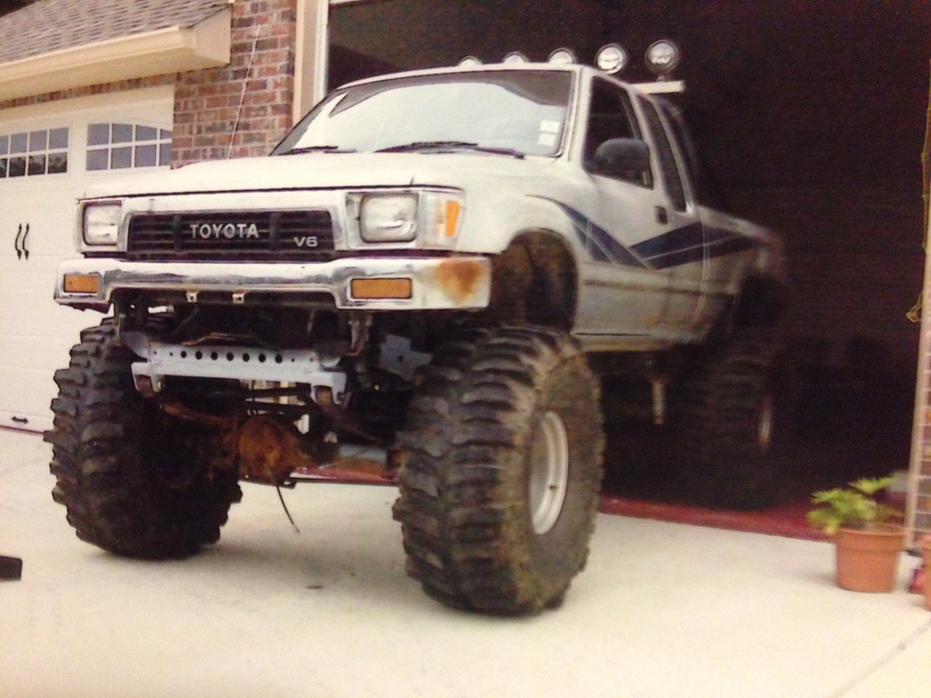

After a few months with this setup I got a screamin deal on a set of 39.5 boggers. A friend offered to buy my 35's and as soon as he gave me the money see swapped them out. In came a 3" body lift to fit the 39.5s.

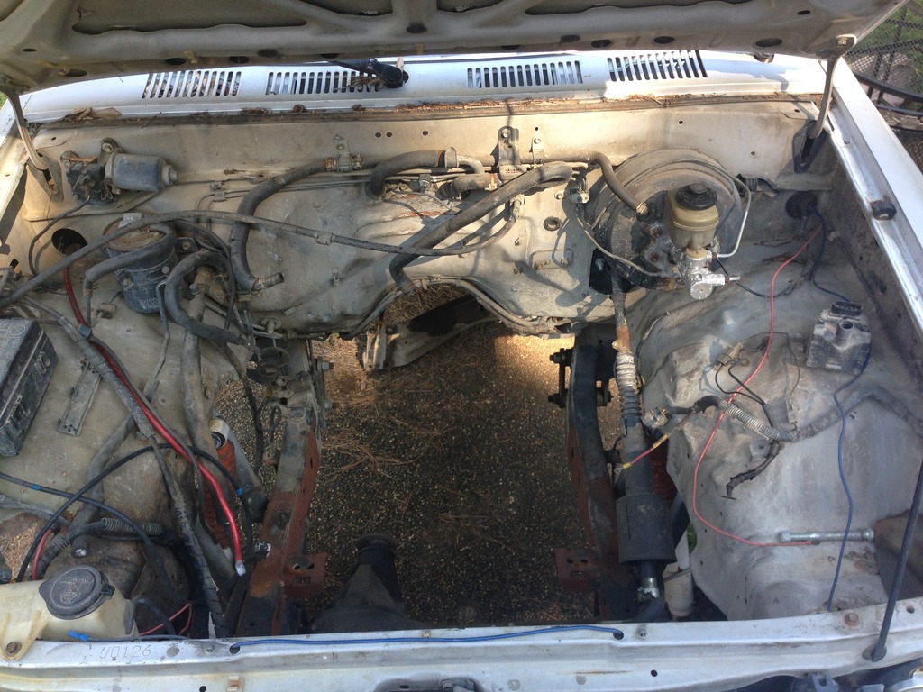

Just pulled engine to move engine mounts. They were only tacked in. The body lift is going to get cut down from 3" to either 2" or 1.75". The smallest I can get away with.

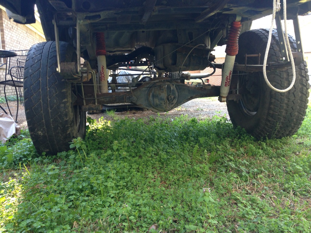

Plans are to reinforce the frame with a from the front most body mount of the cab forward. I'll remove the shock hoops to do this. If I have clearance I'd like to make a brace over the intake manifold from shock hoop to shock hoop.
Here's the front axle and high steer. It came with that nifty little skid plate. I somehow managed to find the matching one for the rear axle. I don't know if I'll keep them once I do the u-bolt flip kits.

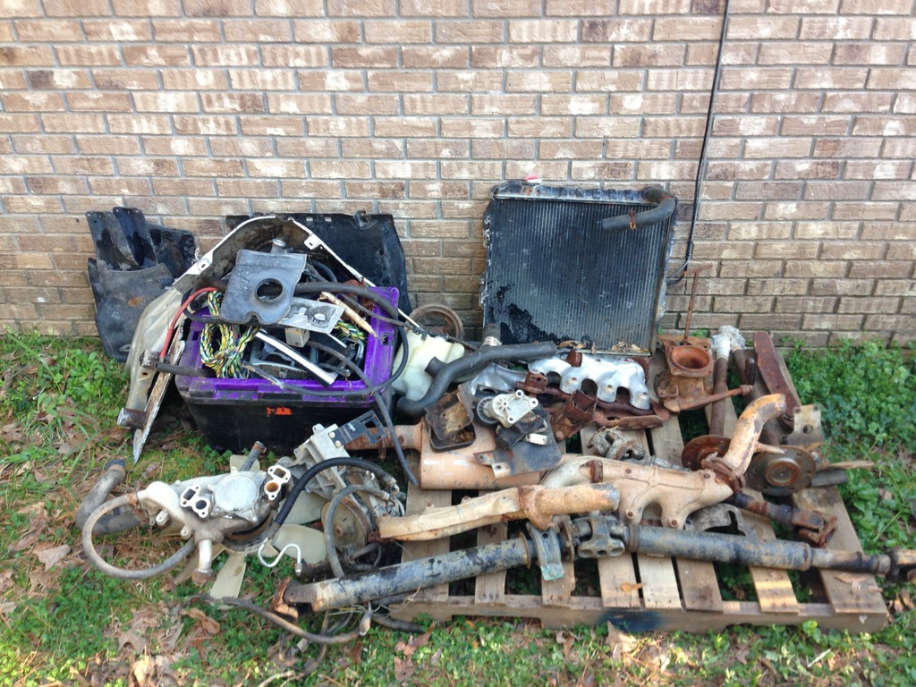

Here's about half the crap I have accumulated for this thing. I bought a set of front and rear chromoly axles and birfields. The rears are for pre 1989 models and are too narrow for my axle. If anyone wants the, I'll make a killer deal.

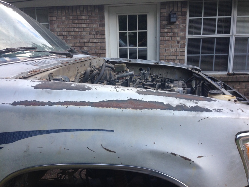

And here's the engine compartment. Oh so ugly right now.

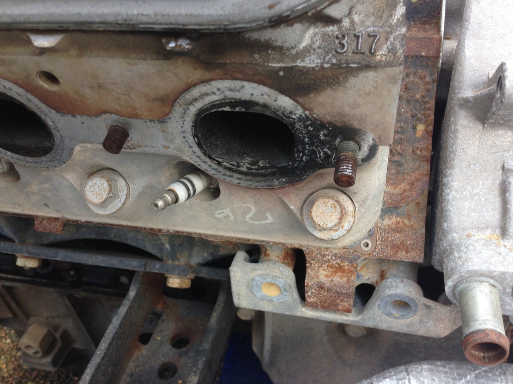

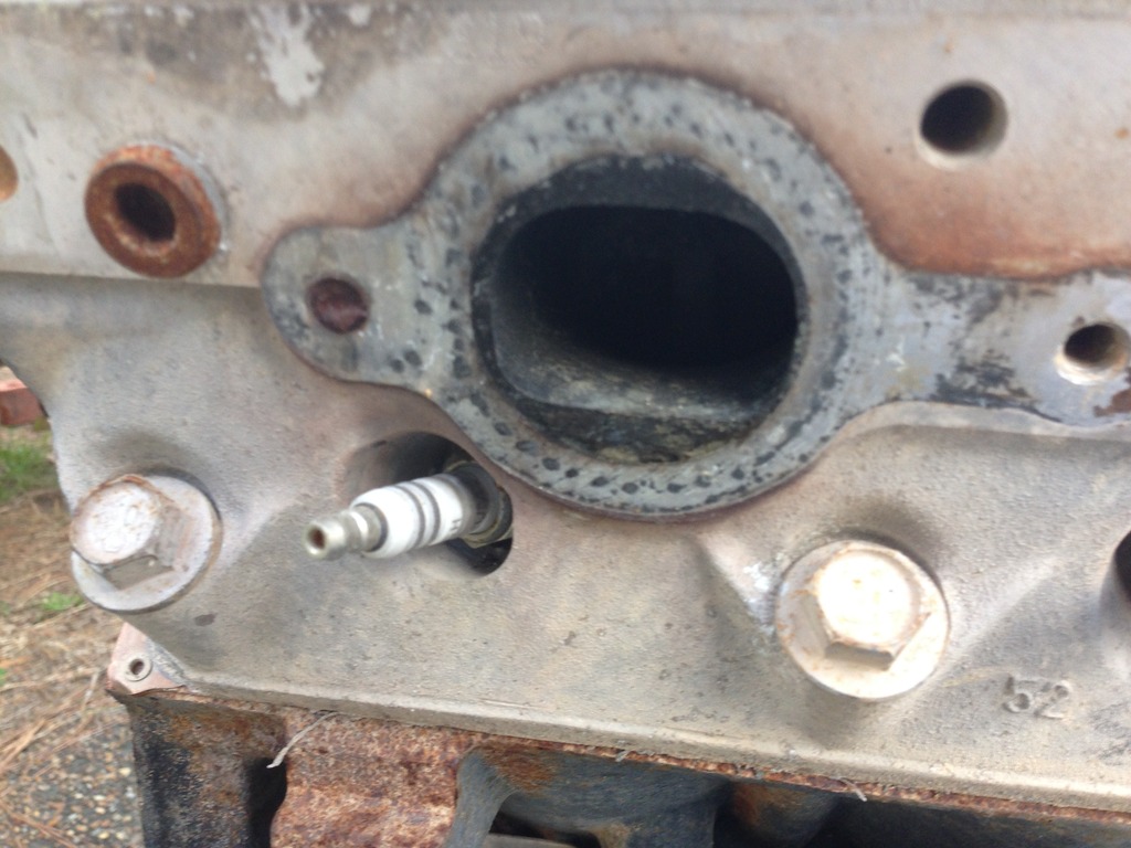

These two broken manifold bolts ca,e out pretty easy with some vice grips
This one not so much. Broke an easy out off inside the bolt, now my drill bit goes every which direction but right. Guess it's off with the head and a trip to the machine shop this is before pic. Too mad to take after pic

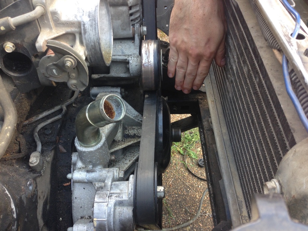

Took some pics today. I'll check out those headers. I used a set of flowtecs for a 1st gen camaro when I was doing the conventional small block chevy and they fit perfect. $130 from advanced auto.
I'll also have to relocate my brake lines I think. Picking up a fuel cell this week, already have a Waldron 255 inline ready and waiting. Ordering hp tuners this week as well, and if the pocket isn't hurting too bad the ideal 63" chevy spring swap kit from ruff stuff.
Engine is slightly crooked right now. Engine mounts haven't been adjusted yet. I still have to go back with it about an inch +

Clearance for ps pump and steering box. Should increase slightly when engine moves back

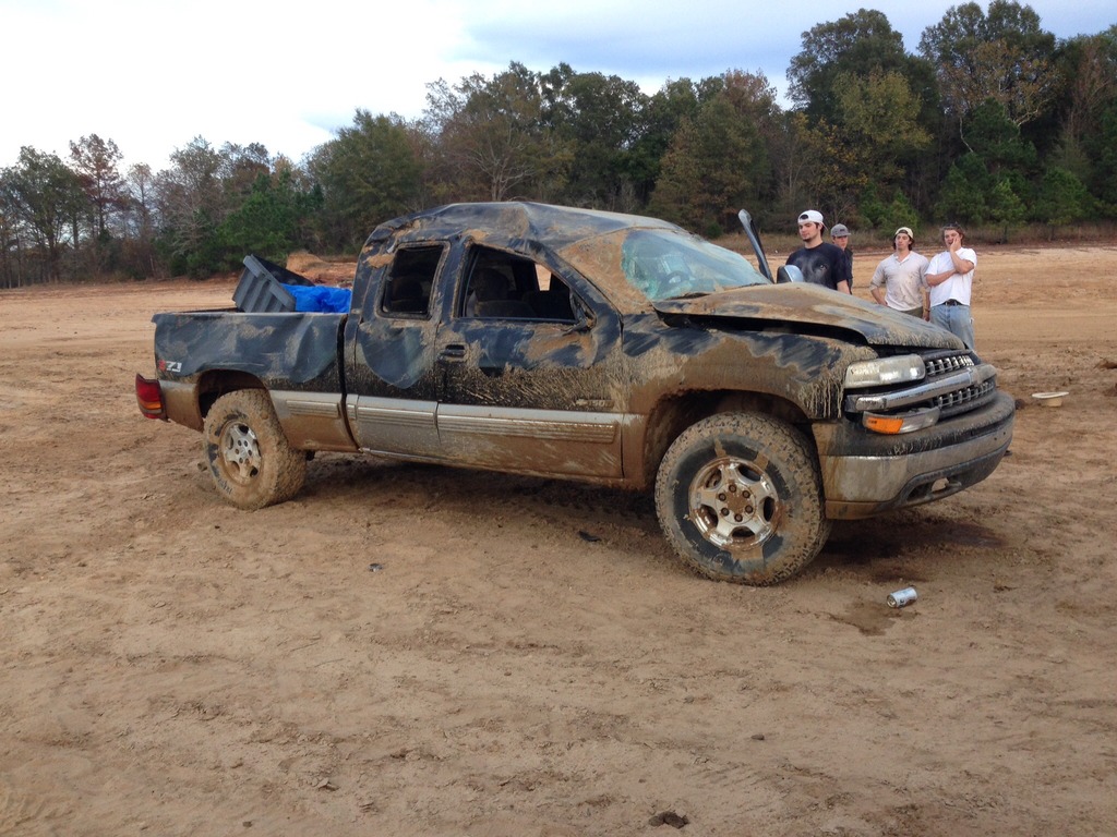

Here's a pic I took of the donor truck right after the guy I bought it from flipped it. Wanna try and pick out the previous owner?
His biggest disappointment was probably the wasted beer poured out on the ground…
