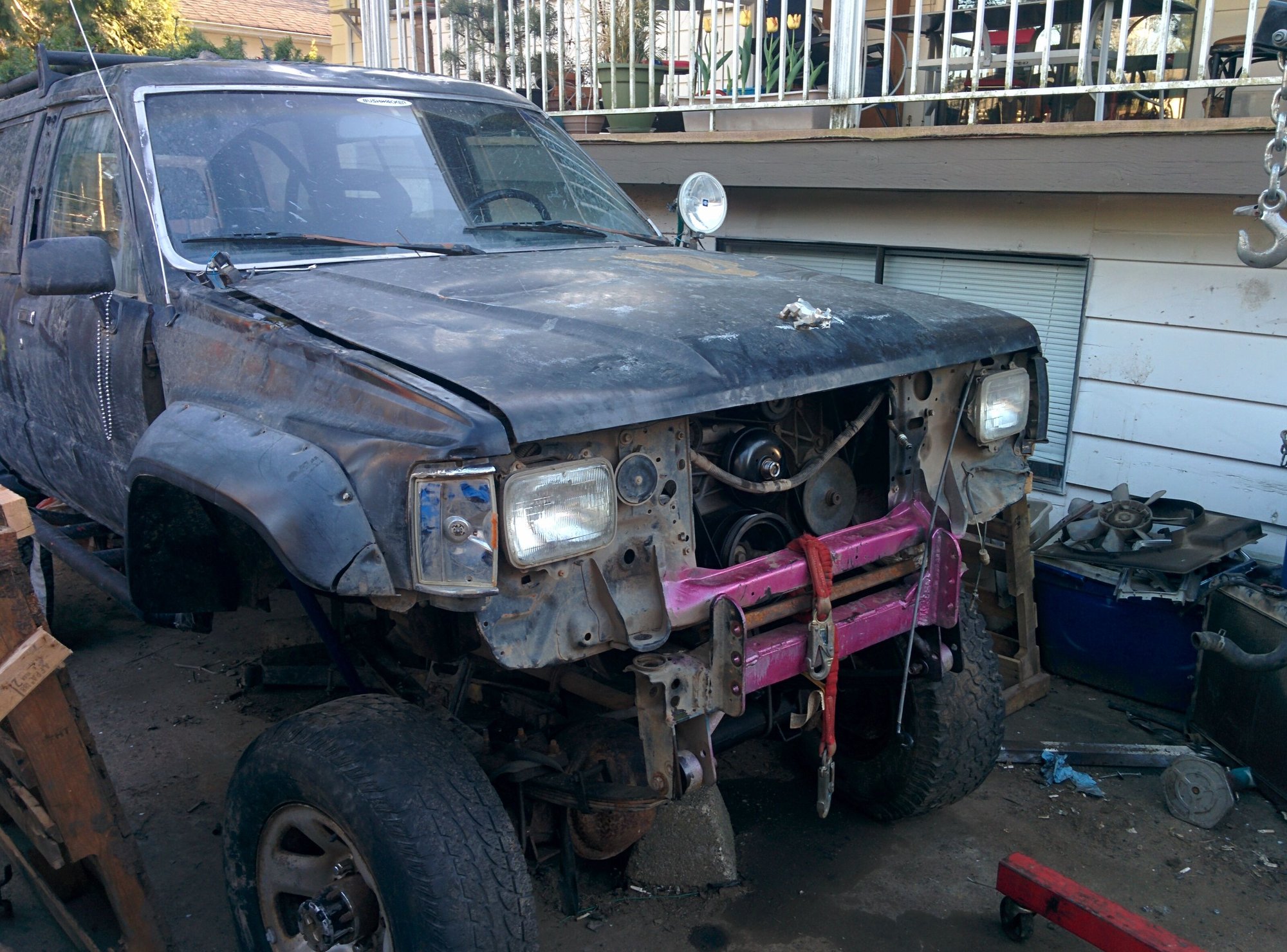

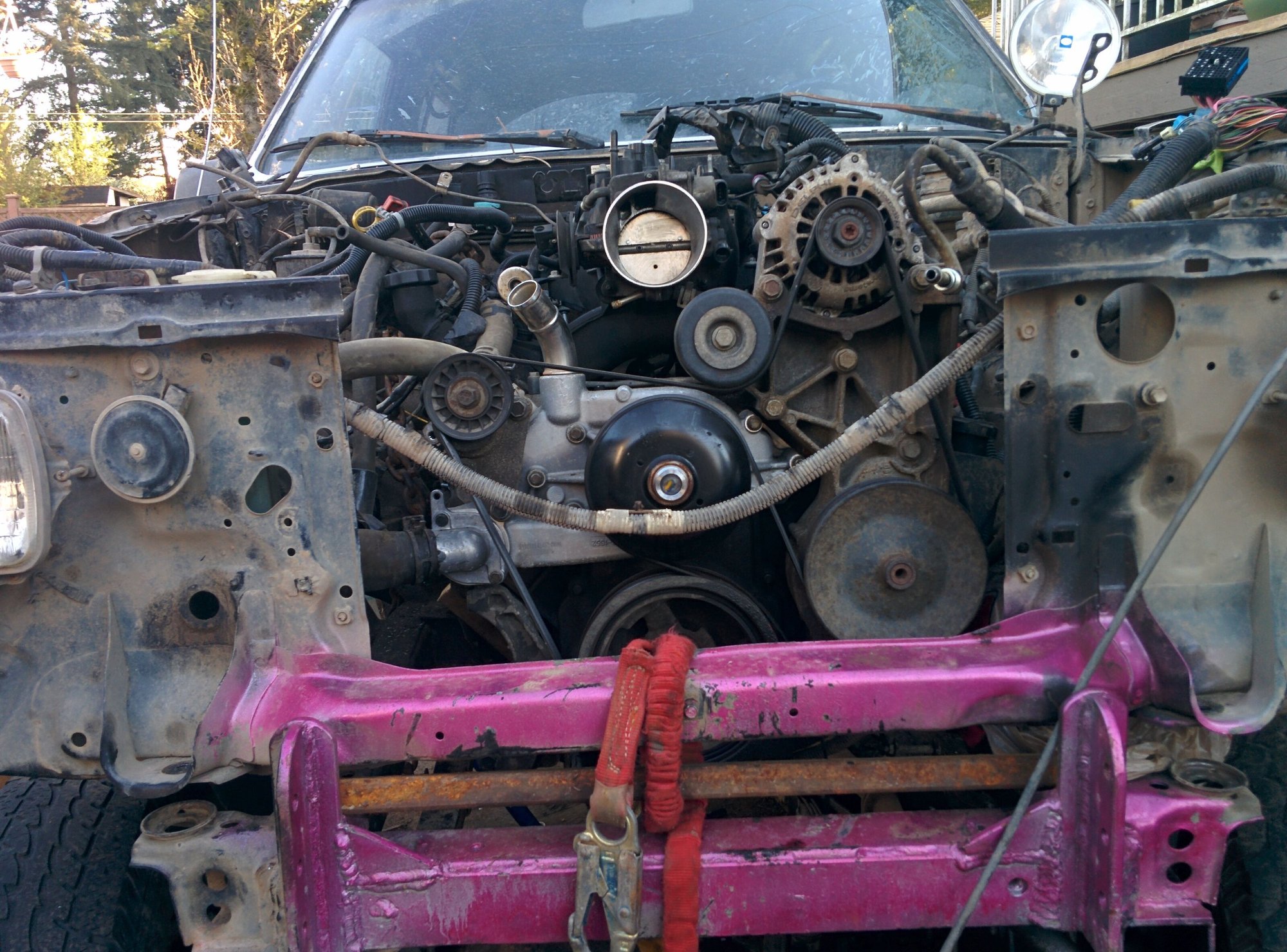

Stuck the motor in today for test fitting and this is where she sits:
So the hood closes. That's a good start.
I've got the motor just set loosely right now. Motor is wedged into the stock frame mounts with some 2x3" blocks (3" between mount and motor). Bank 2 head is 1/4" from the firewall where the bulge for the HVAC fan is. Currently I have about 1.5" clearance from the front of the fan pulley to the front of the cab. I've seen pictures of other swaps where guys manage to stick a 2" thick rad plus a puller fan behind it and I'm completely at a loss as to how they have that much room. What am I missing?
Header clearance same issue. A set of block huggers would be a tight fit, but I think I could make it work. Probably have to extend the header so the flange exits a few inches further back on the passenger side, and wrap the driver side behind the pan. Still, I feel like my positioning isn't quite right as other guys seem to have more clearance.
As for axles, I've got 2 front BJ60's, 1 rear BJ60, and 3 rear minis. As I haven't got proper shoes for mock up, I'm not widening them yet. Will decide that once I've got some 38's available. Plan to cut/turn the knuckles and point the pinion proper.
For the rear, I've heard lots of guys say they run the BJ60 rear offset to a center out case, without vibes. Is this true? Should I bother centering the rear right away, or just run it and see how it feels? I'd prefer an offset rear output, but that really limits my case selection, and drives cost way up. I've got a line on a 231 doubler mated to a d300, with a chev trans adapter for $750 which is hard to turn down.
Thoughts/input for a complete toy n00b?

Yes, a swap typically takes me a few days at this point, assuming I know where I want the build to go before I start, and have all my parts on hand. I spend more time tracking down parts (cause I have to order everything from the US because Canadian vendors are useless) and looking for my ˟˟˟˟˟˟˟ sockets, than I do actual swapping motor. The 6.0L swap we did a few weeks ago pretty much took 2 full days of work.
Higher COG unacceptable. The entire reason for this build was because I wasn't happy with my XJ's side hilling stability. It's already pretty damned good, and miles better than most rigs I wheel with and/or run into on the trail, but I know I can do much better. The XJ's motor ended up 1-2" higher than I'd have put it except that when I did that swap, I didn't know what I was doing and ordered conversion mounts from Novak. They put the block arbitrarily high. Compound that with the Unibody being top heavy and having a suspension that actually articulates (most XJ builds are stiff as hell), and I just don't feel comfortable on anything > 40 degrees at all.
But, I did manage to get the motor very low. I've currently got the top half of the stock chevy motor mount bolted to the block (just so I have something for reference, and to support the motor temporarily). The motor is far back enough that the stock mount is actually 1mm behind the stock yota frame mount. This gives me enough room to put the stock runner rad in front of the motor, though probably not enough to put a decent flowing e-fan behind it. Not sure what i'm doing about that yet. May chop the firewall and bring the motor back another inch or two.
But for now, I've got clearance everywhere, and the hood fits, with no body lift.
These are the same headers I used for the last 6.0L swap in the 1500. They're block hugger shorties with rear dump. Impossible to find in Canada, absolutely everywhere in the US. Picked these up from Amazon for $180 -
Amazon.com: LS1 LS2 LS3 LS6 LS Conversion Swap Headers (Camaro, Chevelle, Nova, C10 Trucks): Automotive Amazon.com: LS1 LS2 LS3 LS6 LS Conversion Swap Headers (Camaro, Chevelle, Nova, C10 Trucks): Automotive
They fit almost perfectly. Had to trim some of the inner fender just to lose some of the annoyance. The collector clears the frame rail, but the flange ring does not (I was expecting this). I'm going to just chop off and extend the collector 2-3" so the ring is below the frame.

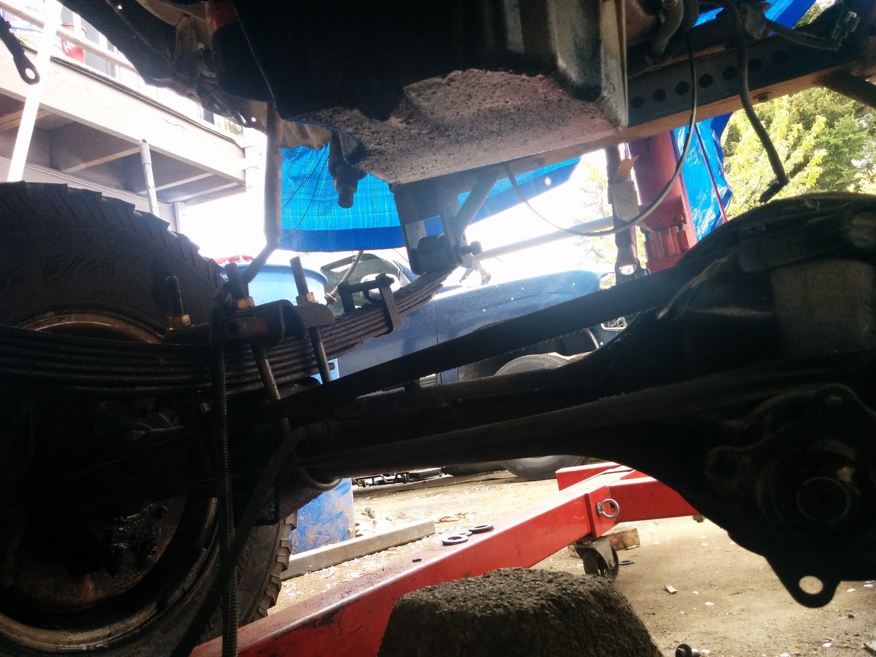

Okay, so I've got the motor placed and temporary motor mounts mocked up. I've got clearance for headers to sneak through, everything clears under the hood, oil pan to diff clearance is good (with a driver drop). But I've got a problem.
Flipping the LC 60 axle around for driver drop 1. because there's way more DS clearance on the driver side and 2. I can't find a pass. drop case with a front output far enough out from center to clear the trans pan without running the DS right under the trans.
I pulled the front axle again and stripped it, and cut the front cover off as it'd have to be spun 180 for the now rotated third/ring gear.
I was planning to staying leaf sprung for now just because I want to see how far I can take a leaf sprung rig. I'll link it later, but for now, it's leaf.
The leafs are raked up at the front (just the nature of the toy frame), which puts the center of the pack (it's a rear back, so the center is actually a bit forward of center) at about 5-8 degree angle. With the stock axle perches, this points the pinion down into the ground (cause it's flipped). So I already rotated the knuckle balls (roughly) but now I've gotta rotate the perches and here's where I'm running into a wall. I've gotta rotate the perches around 20-25 degrees forward, but to do so, and keep the mounts low, I'll have to chop open the pumpkin to keep the perch at stock height (the straight line at stock height, goes about 1" into the housing).
So I'm looking for input here for two issues:
1. If I chop the housing up at the pumpkin, my plan would be to just cut the stock perch risers off at the angle and height I need, and just keep cutting at the same angle into the pumpkin, and just weld in some filler where it opens up. Is this going to end up weakening the housing overall?
2. I've no idea how I'm going to put ubolts in. The pumpkin side will neither be square nor round on the bottom, so I'm really not sure the best way to get a bolt in there. I was thinking of just welding up a rounded edge on the bottom of the housing to just run regular round u-bolts.
It's just seeming like a lot of work to stay with leafs. Realistically, it'd be about the same amount of work to just 3-link it.
Thoughts/input?

So this is how the one side sits now. Needed some paint to survive the rain tonight.
Then my buddy showed up with a spare drag link and a couple TRE's so I could figure out where I'm going to put the steering box. I think it'll be fine if it gets moved forward about 1.5", and tilted way back. I was going to clearance the frame for the castle nut to pass by, but looking at it flexed, I'm already near buried in the fender and those leafs cant' really go any further anyway, so I'm goona call this good.
Box is just resting there cause I ran out of hands and my GF has Zero interest in helping. Just pretend it's moved up as high as it can go and still have clearance for the castle nut to the frame. Should be more than enough room to clear the tie rod as well.
All in all, a pretty productive 3-4 hours today. Depending on how lazy I am tomorrow, I'd like to get the other fender done, and chop off the old steering box bracing and re-mount it in the correct spot.

No pictures from yesterday and it's raining now, but got a few things done.
Engine mounts are in. Took the GM mounts and cut the frame end of the mount off, and flipped the engine side around 180 so it points almost straight down. Drilled an enormous hole in it to accommodate an enormous bolt. Welded on a chunk of 2x2x0.25 tube and drilled a hole in it to match. Stuck a hockey puck in between and torqued down. I think it'll work.
I had some wicked oil leaking from the donor motor. PO said it was the rear main, so pulled the trans to replace, but the seal looked good and I don't think that's where the oil was coming from. Thinking it may have just been the oil pan gasket. Oh well. Did the rear main while I was in there, as well as the valley cover and valve covers while I was at it.
Bolted up the np243c to check fit. I think it'll work. It has the 1350 yoke front output, which I'll probably swap out with the 1300 series flange (the long flange, cause that's what I've got, but I'll do a shorty if I can find one). Then I can probably use the GM DS flange and just swap out two caps for toy caps, and mate a Toy double cardan up to the GM flange. I THINK this will work.... If not, I'll be on the hunt for a GM double cardan again, and just swap out the caps on the diff end.
For fueling, I think I'm going to just run a hose from the toy pickup to the bottom of the tank, then pass that to an inline 255lph pump. No idea if this is going to work, but it's cheap/easy and if it works, it should work fine. I've never used an inline pump so I have no idea if they have trouble priming.
