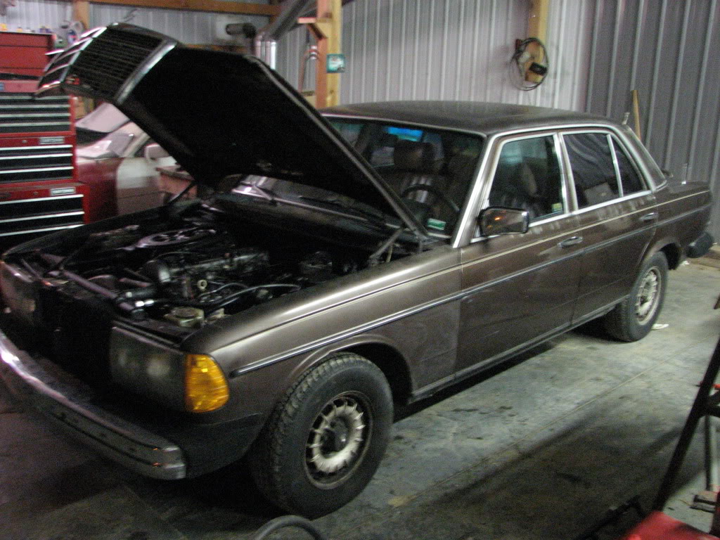

Here is the Benz on the trailer bringing it home.

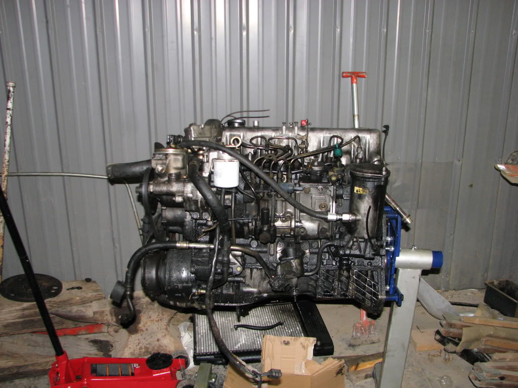

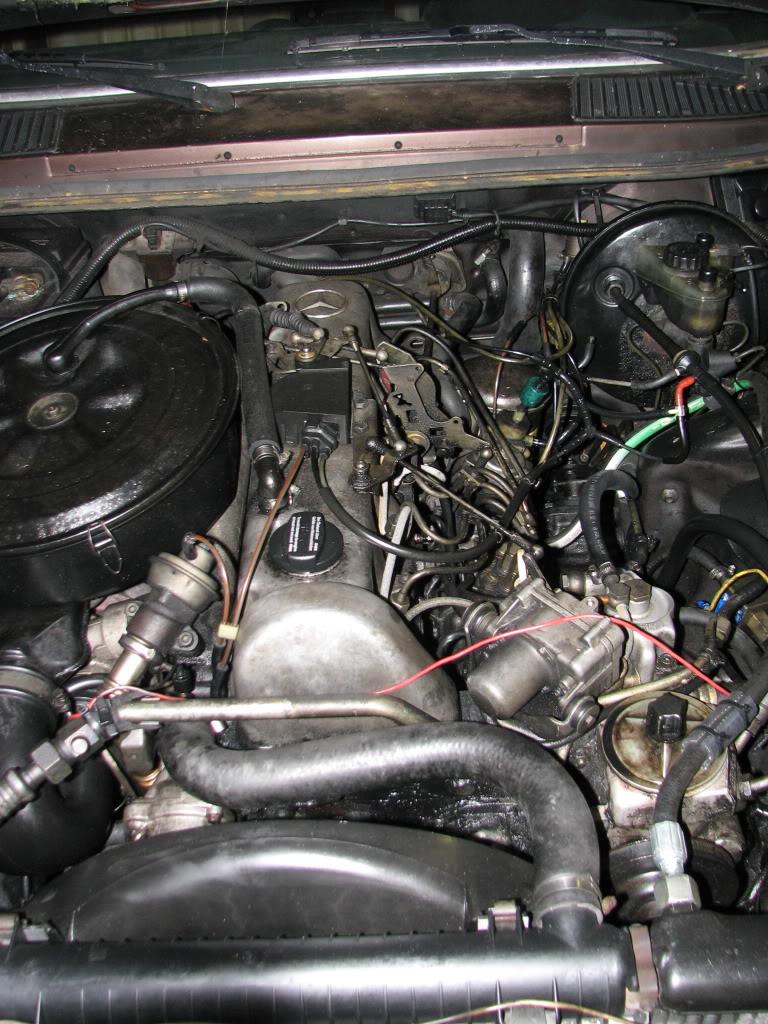

The 3.0 5cyl OM617 Turbo

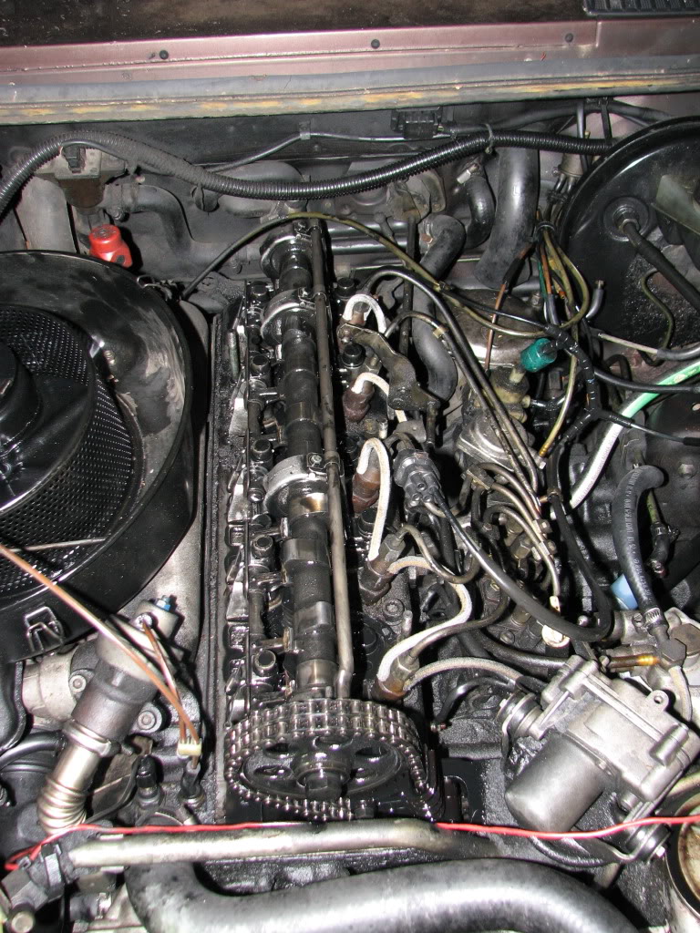

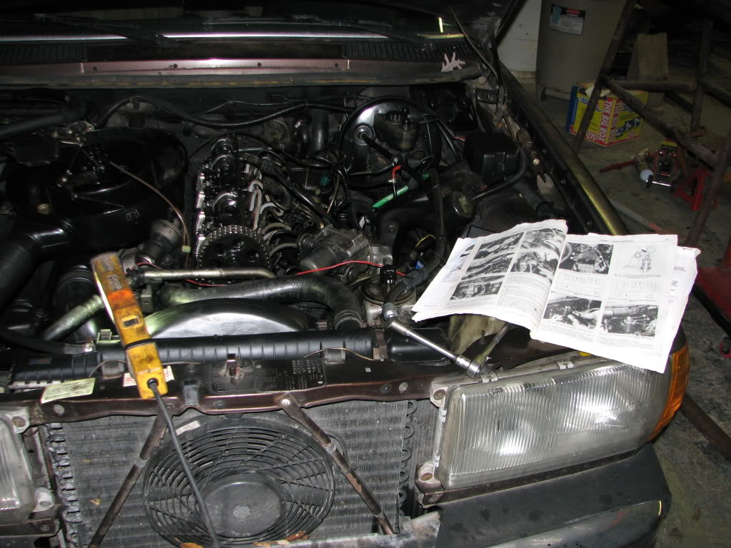

I decided to go on and check the valves and re set them.
And that is where I am at for now. I may work on getting the engine out this weekend. I'll have to see what time permits me to do. My goal is to try to start work on the adapter by Thanksgiving. I hope this thread proves useful to someone and you guys enjoy it. If you have any questions I'll do my best to answer them.

You should be able to part the rest of the car and get all your cash back out of it. The body looks very clean. List it on the MB forums and you should have no problems getting rid of it all.
Nice clean looking truck too... Welcome to the family.
btw check the hood hinges on the MB there should be a little trigger type button on each one. Press them and you can lift the hood all the way past 90* and have complete and easy access [at least you can on 87 and on or so not sure about yours.]

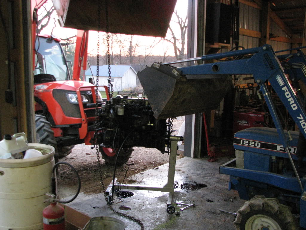

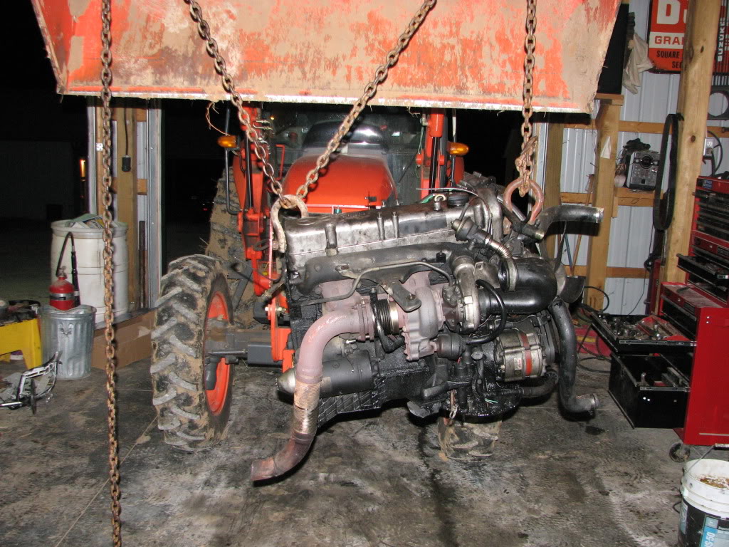

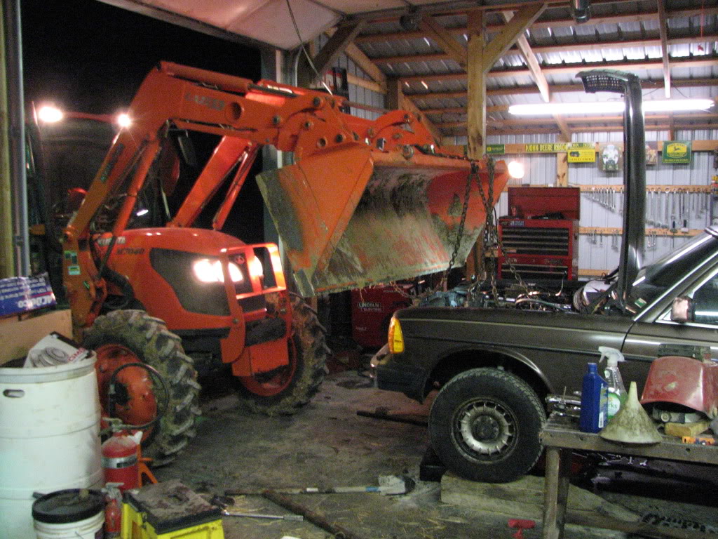

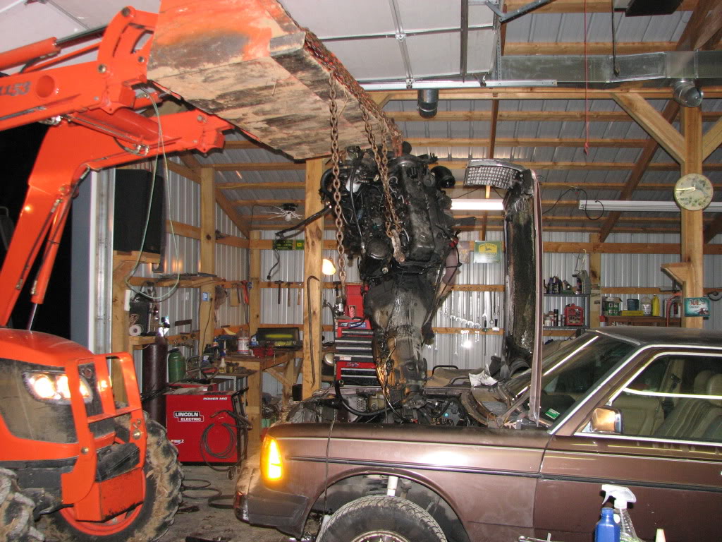

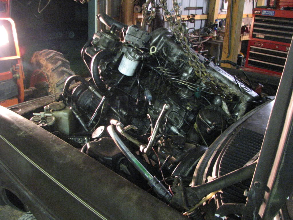

Well today was a VERY crazy day but I managed to get the engine out of the car. I decided to take the trans too because the two Hex bolts that hold the starter on were in there real good and I didn't want to risk stripping them. If you are squeamish to car carnage I would look away now lol.
Thank you aviator for the tip on the hood. I did the valves last night and was ready to kill that darn grill! Keeping to the budget build I was too cheap to go but an engine hoist. The tractor and loader method worked pretty well, but I think that I may use a single tree to put it back in to try and level it a bit better. Time will tell on that one. I am going to try to part the car out eventually. I was hoping to get the engine on the stand tonight but I had a guy with a Dodge Cummins come in the shop wanting a trailer plug put int he bed for a gooseneck, simple enough right?, well the person who wired the trailer plug in the bumper used all one color wire so a 30 minute job took 2 hours. So hopefully in the morning I'll get it on the stand and be able to get the car out of the shop.
Westjohns its interesting you mention the Cummins idea. I thought about it myself too and many many people have asked me why I didn't do it. Honestly the sheer weight of the 4bt was enough to run me off. I have a feeling the Benz will get better mileage and the rpm range of the Cummins is so much shorter than the MB that I would have had to regear the truck. A 4bt swap would be an awesome undertaking though. I don't mean to sound rude I just thought I would put my on the subject out there. Ok its time to crash.

Well today I got the engine separated from the trans and got it up on my stand. I'm going to try to tear into it sometime this weekend. It sure is an oily mess. I can't wait to get it all cleaned up.

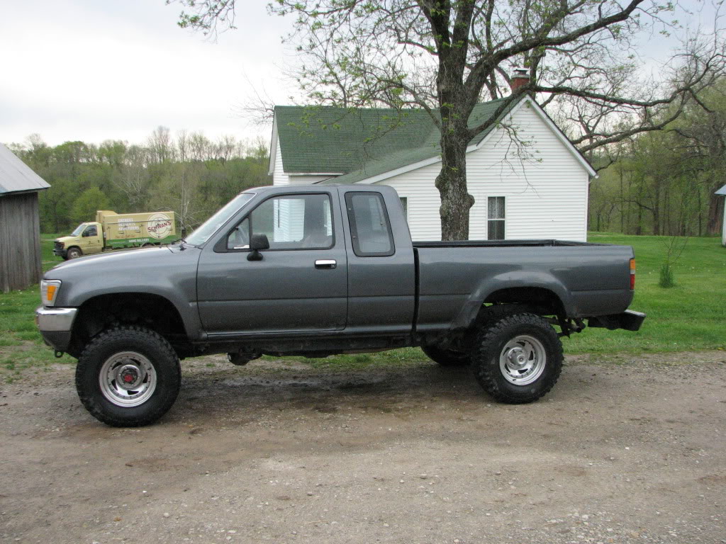

I think folks around here have noted that you may have to do a 1-2" body lift to clear the bell housing or the top of the eng. but I'm not sure... if it's the eng. maybe go for a "power bulge" hood mod. maybe an SC style hood type thing... that would allow increased cooling...

Aviator- My truck has a 3 or 4 inch body lift on it I cant remember. Name:  Toyota002.jpg

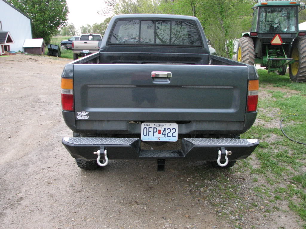

Size:  201.3 KB You can really see it in the last picture as I just welded the bumper to the stock mounts after I built it. I was in a hurry to get it mounted as I needed the hitch. I am going to move it closer to the body soon. I had thought about a CAC but I think for now I am just going to mod the pump a little and see where it gets me, especially since the radiator is going in the bed and money is tight. I'll be sure to go do some snooping on the MB forums. Thanks for the tip though.

Nice rear bumper where did it come from?

Aviator- Thanks for the complement! I built the bumper out of a tool bar off an old IH cultivator we had in our scrap iron pile. Its made entirely of 5/16 steel. I threw it together one weekend because the stock bumper rusted through in the middle where the hitch was. I put a trailer on it one day and ripped the ball clean through the bumper. Therefore a new bumper was in order so this one came to be. I am not too worried about the tick now. I am thinking my vacuum pump needs a rebuild and that has been known to cause a tick too. I've used that engine restorer in the past and it actually did a pretty darn good job. I'll have to see about this MB once I get it rebuilt. I am going to start collecting parts this week for it. Thanks again for your input aviator I really appreciate it!
