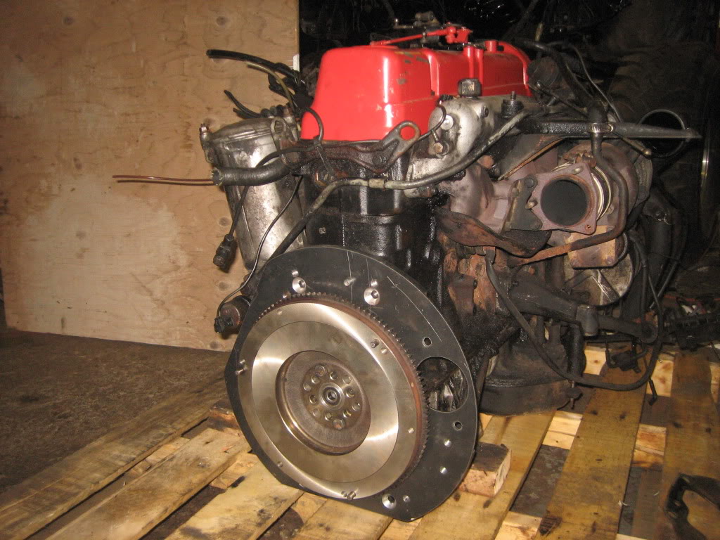

little bit of new info, I picked up an 89 v6 gen1 2 door 4runner
and I'm slowly working on it, (got a block lift in the rear last night)
now gotta crank some torsion bars....
so there have been talks about a new plate possibly being made
but I'm gonna step it down a little and go with the 4cly Benz for mine
more or less to have a little more space so i don't have to move my rad
then a med to big turbo added later
Old Oct 20, 2010 | 09:07 AM
  #27
crazy_85's Avatar
Joined: Aug 2009
Posts: 46
also with the new plate I'm gonna be anal and make some new motor mounts that line up with the toy stuff to make it a little bit more of a bolt in kit,there will be lots of pics with info and descriptions added once the build begins, if all goes well there should be an almost bolt in kit for the 4cly Benz motor by mid spring to summer .....

the only issue i have with the 5 cyl is the space, if the truck was a v6 your gonna need to move the trans back, your gonna need a 2 inch bodylift to clear the top of the motor, and that was on an ifs beast ill post some pics of the two trucks we've done the swap on, there both having there own issues.
sas, 3 inch body lift, 7 inch springs
i cant find any of the ifs beast atm
