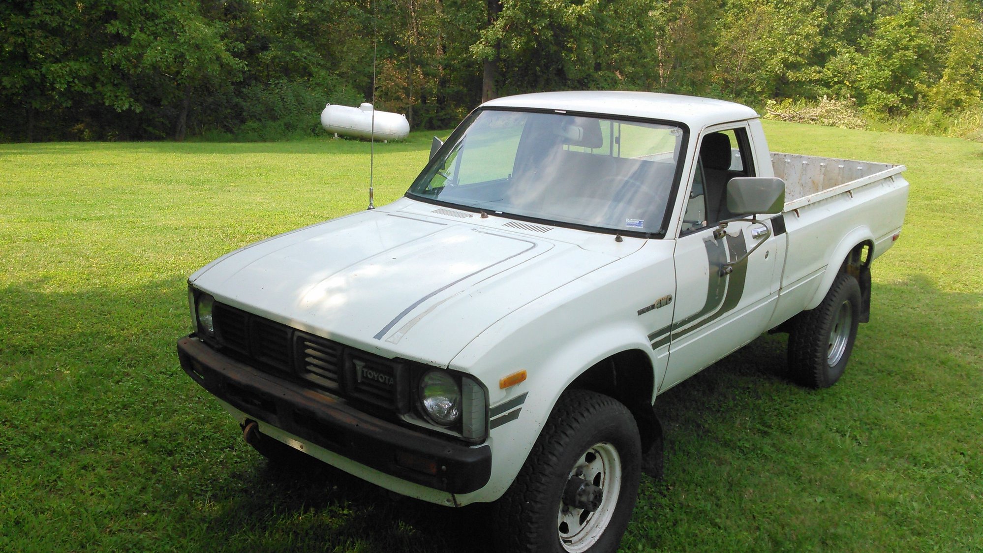

It's been a while but, after a few years of daily driving my 1st Gen I'm finally going to get started on some updates for it.

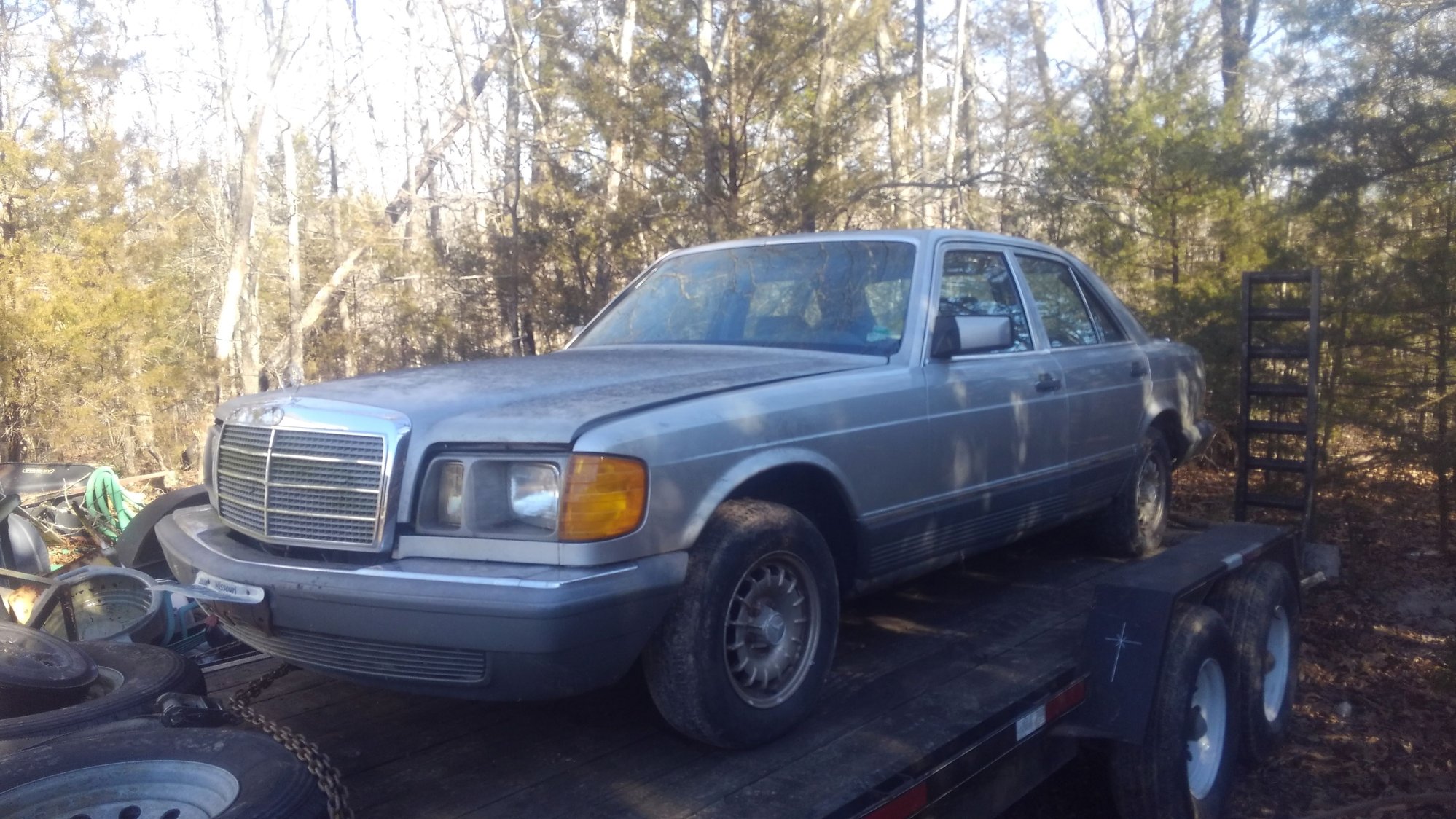

I was going to just freshin up the 20R in it but then I came upon this guy for $200.
I changed my mind.
It's complete, (I drove it on the trailer) with about 150,000 miles.

Here it is as I pulled it in the shop, Like I said, its pretty complete, I had a video of it running but I must have deleted it.

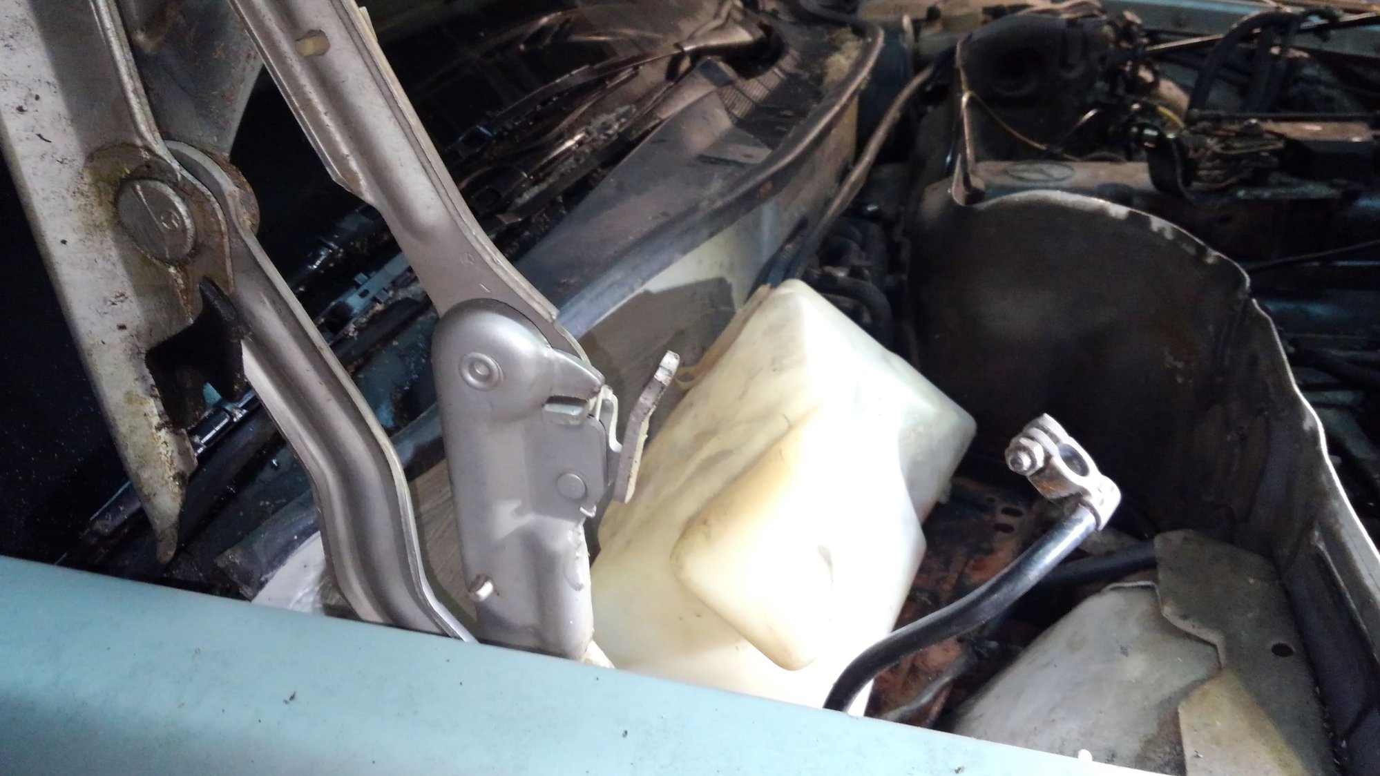

I started on the passenger side pulling hoses and wiring. I've had a little bit of experience working on European cars when I was over there in the service. I'd forgotten how nice it was compared to American cars of the era. things like the junction blocks for the engine wiring.
And two position hood hinges, so you can pull the engine with hood still attached.

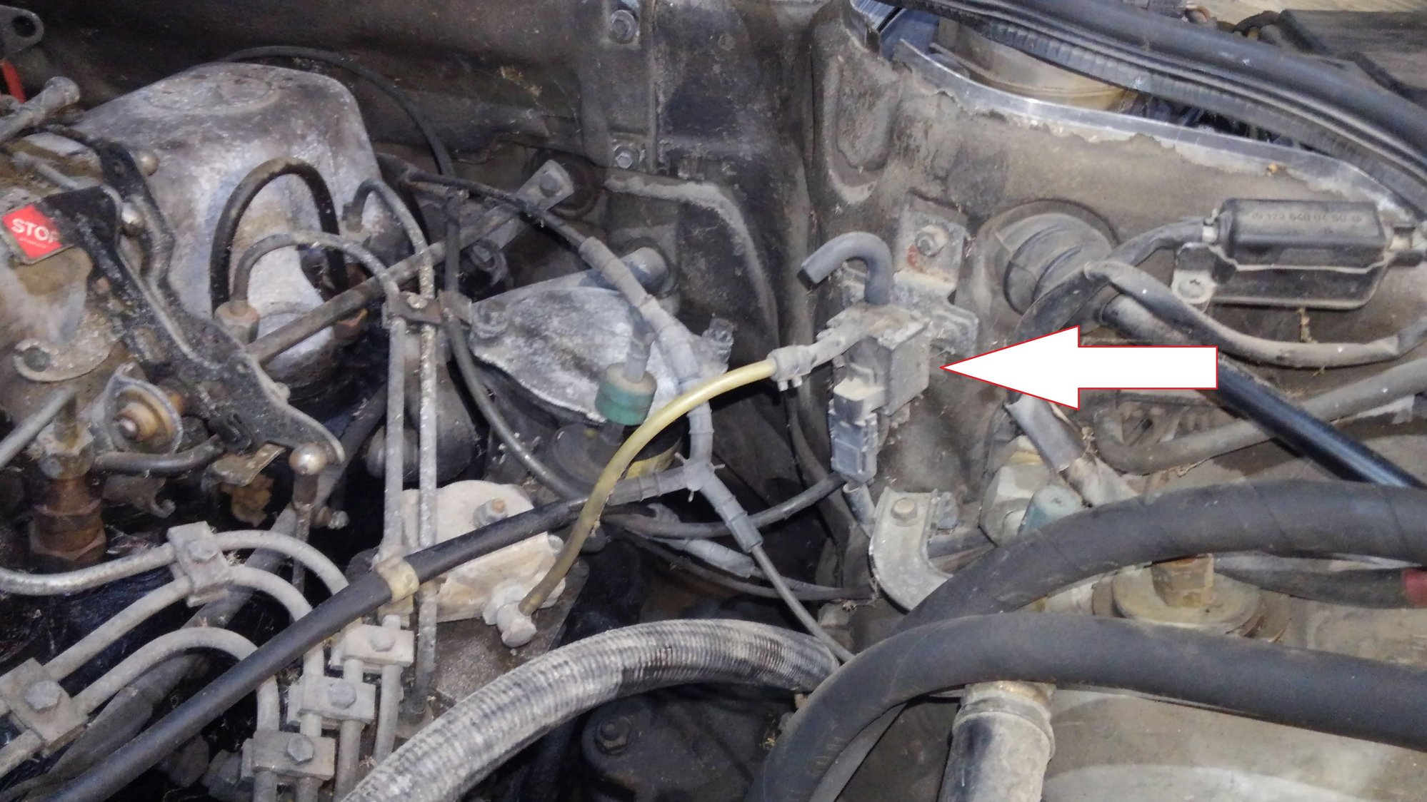

Can anyone tell me what this is hooked to the ALDA? Is it a vac switch that I can somehow use to for the fuel shutoff?

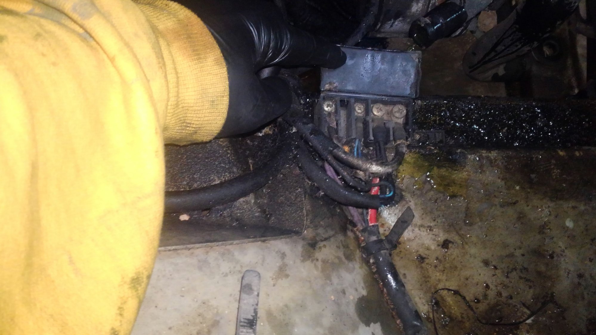

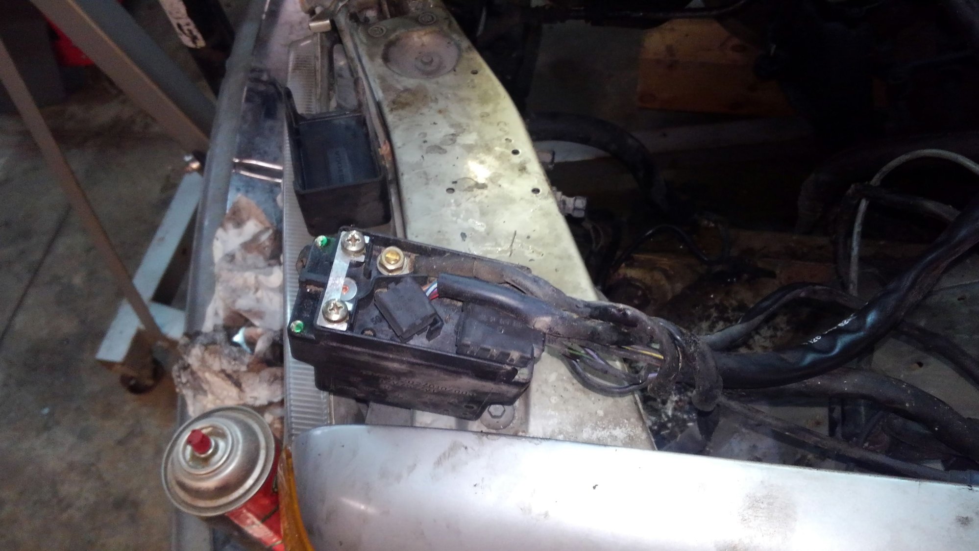

Glow Plug relay.

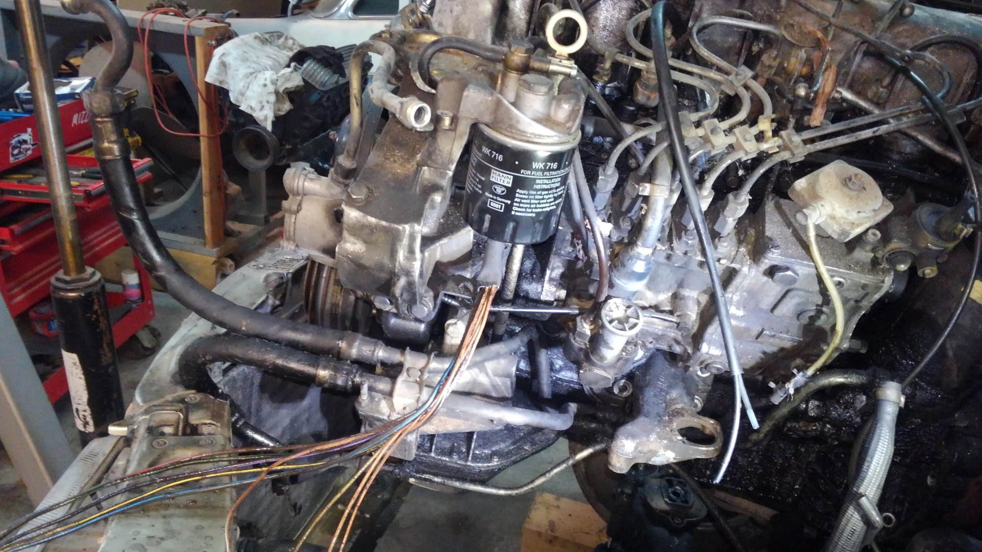

Out and free!
Saturday turned out Sunny and about 40Deg, with no wind so I figures I could try to clean it up a bit. After plenty of Simple Green and some time with the power washer.
That's it for now. I've got a gasket kit coming, then I'll start getting into it a little more.
I probably wont pull the 20R out of the truck until the late March in case the weather turns again.
