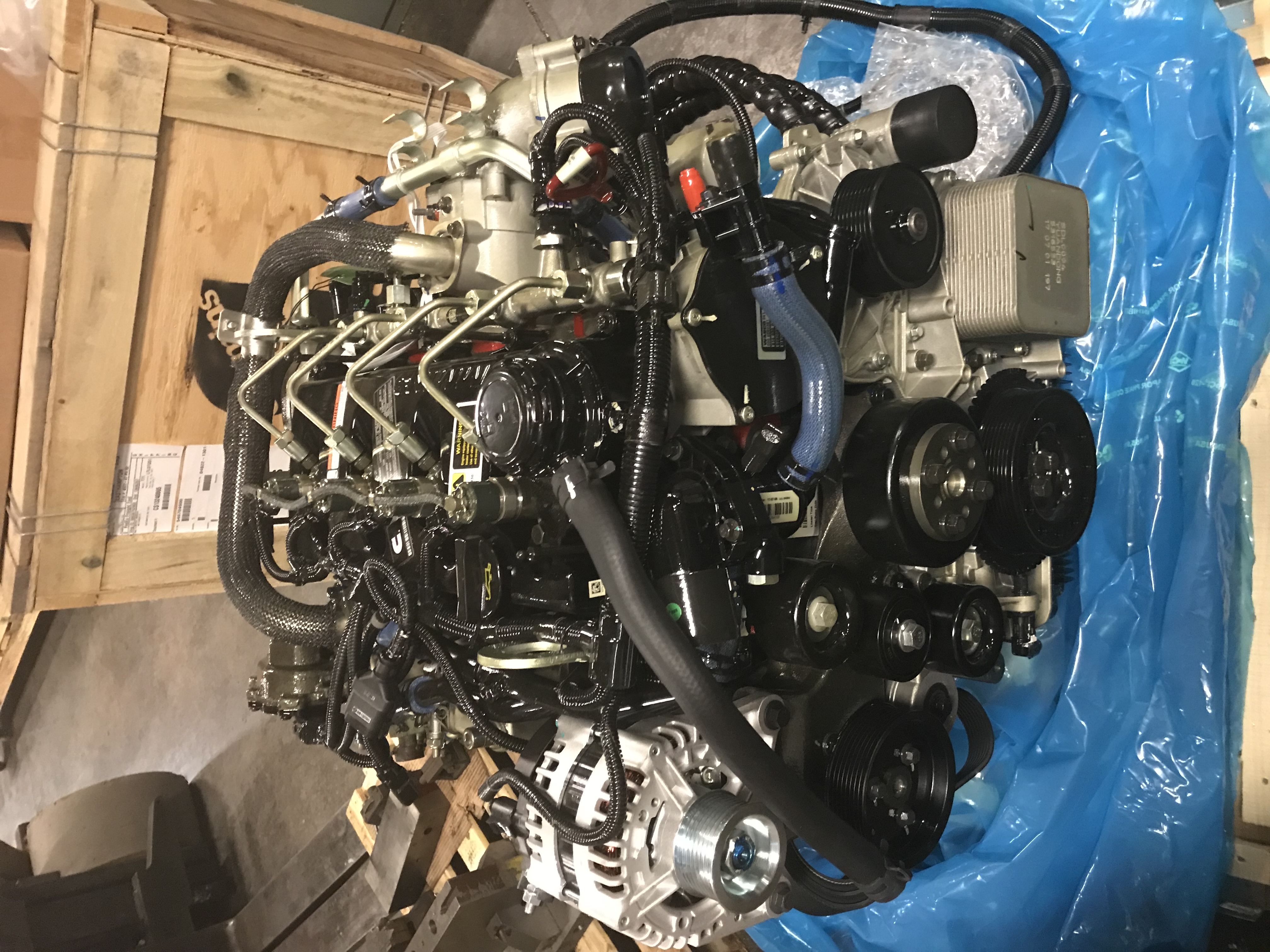

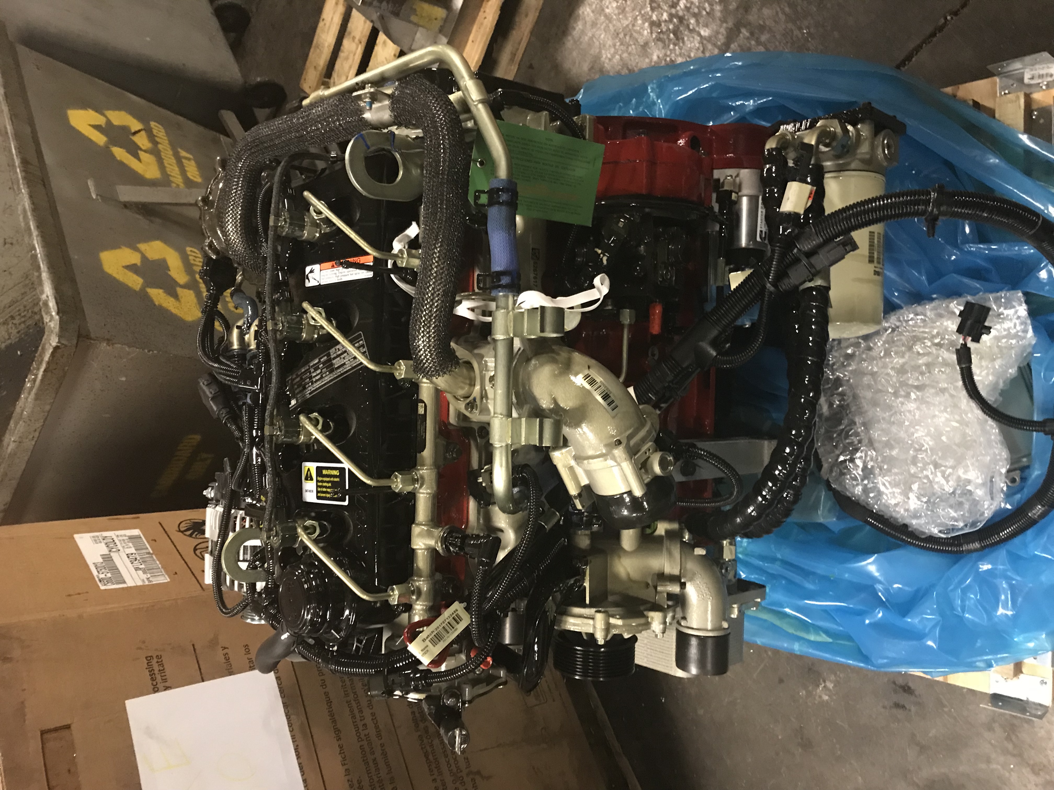

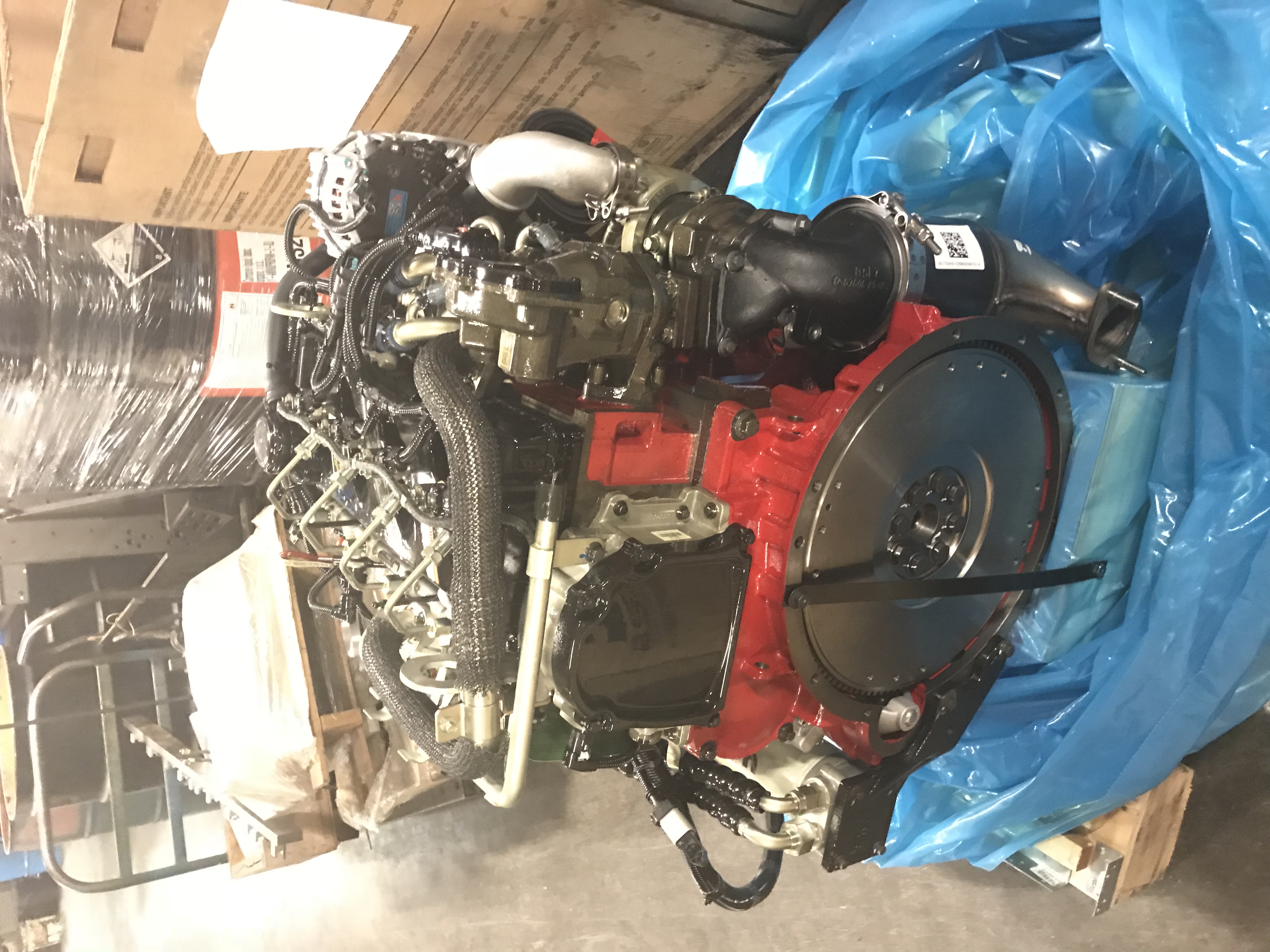

I’m currently in the process of engine swap with the all new Cummins R2.8 diesel motor. How many people would be interested in me posting my progress on here about what I’m doing with the swap? I’ll post stuff here and there about it but if people want more info and more pictures I’ll be happy to spend the time and help others out.

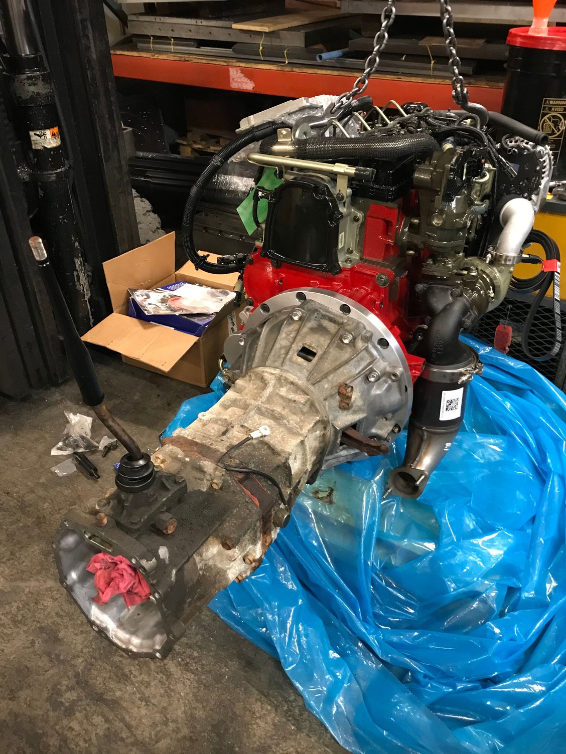

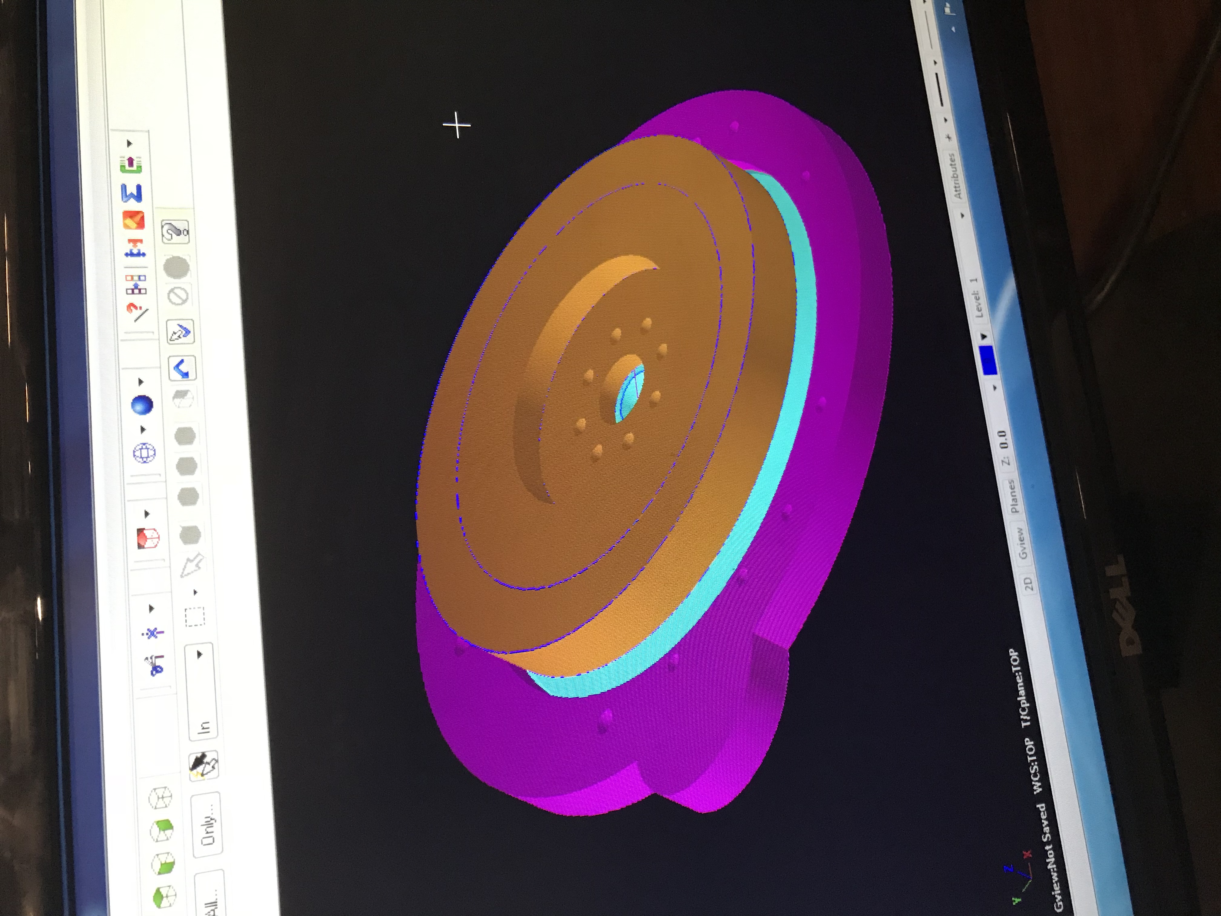

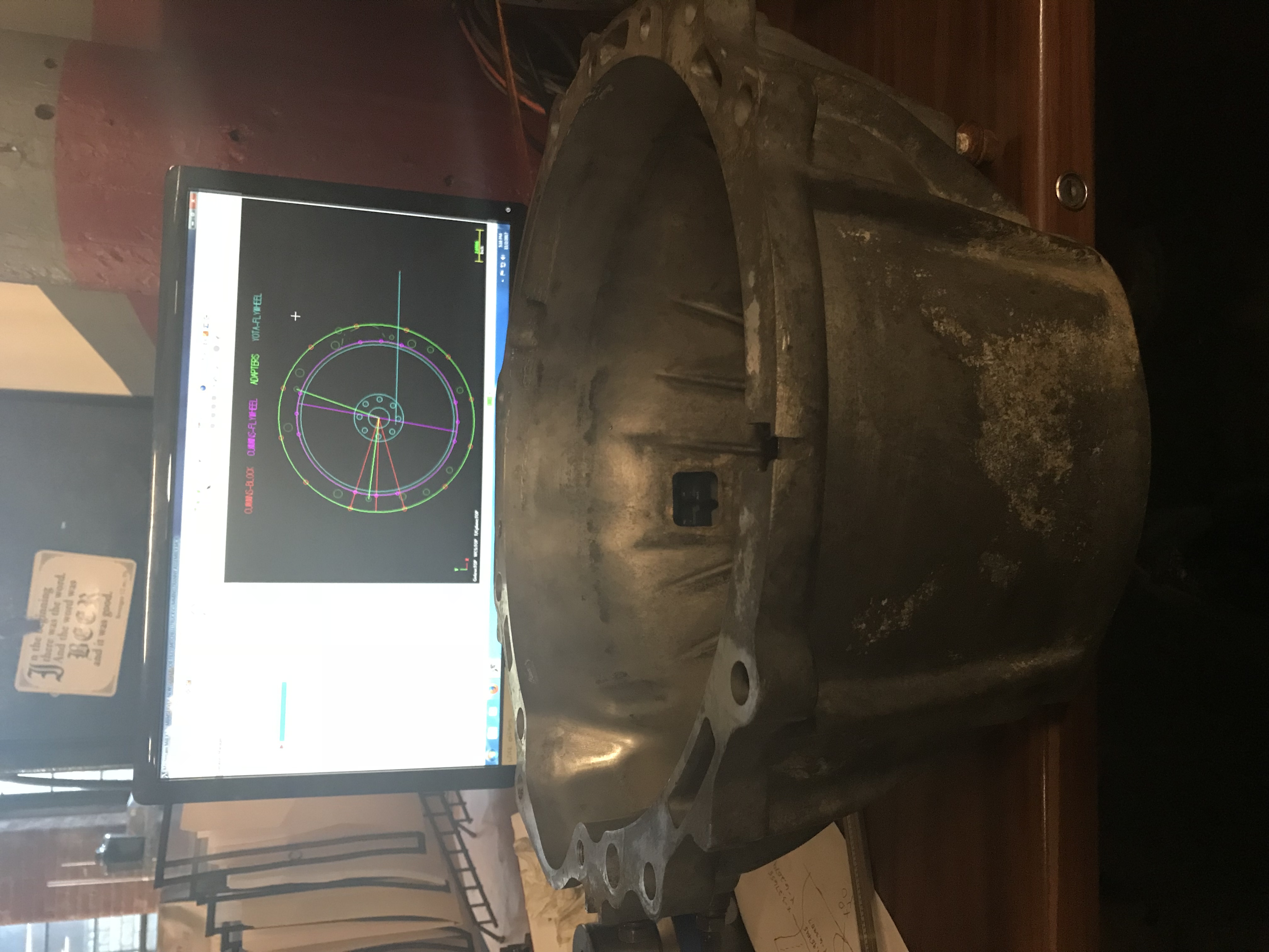

In the middle of design and engineering the bell housing and flywheel adapters for my r150f transmission

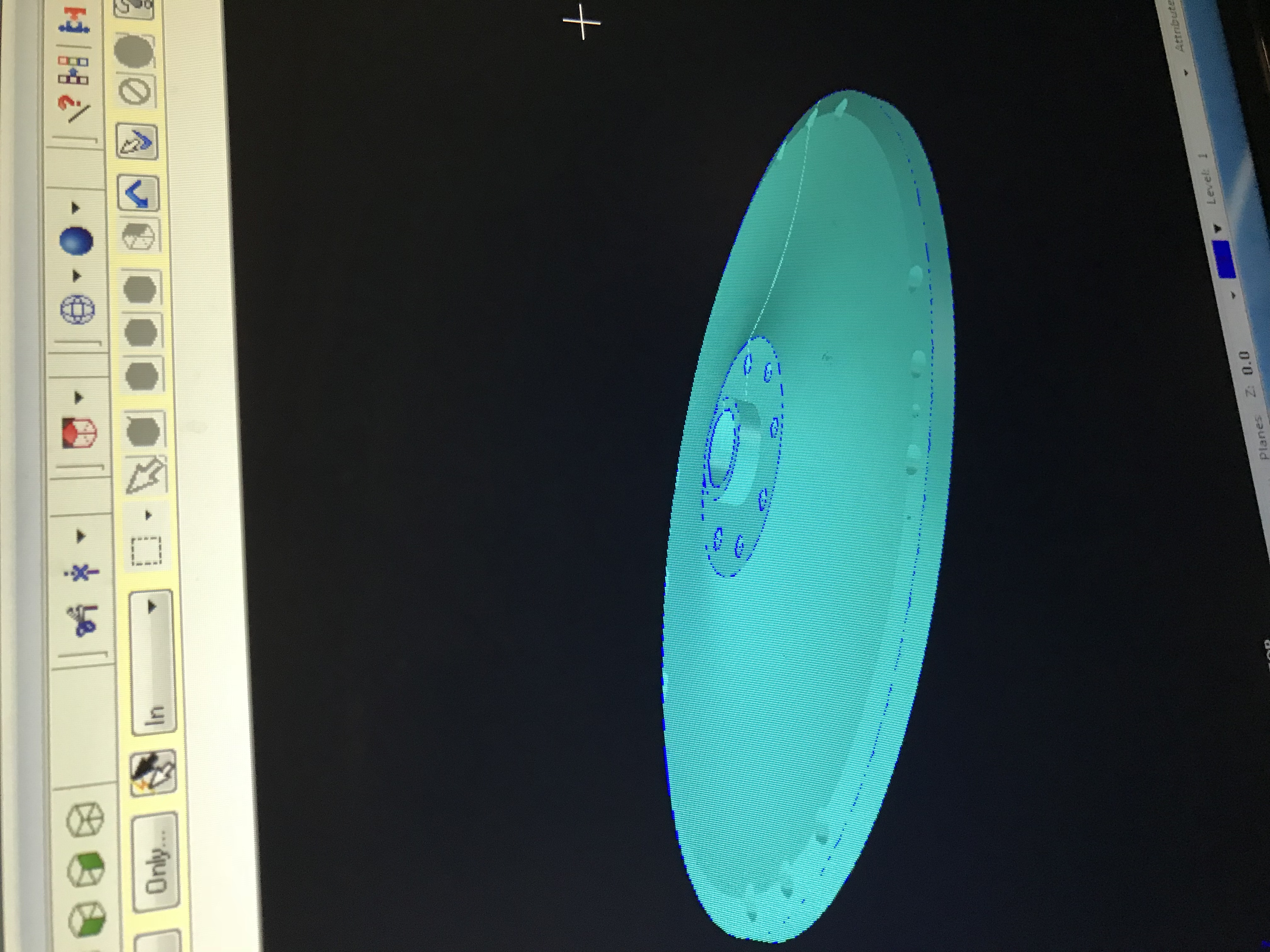

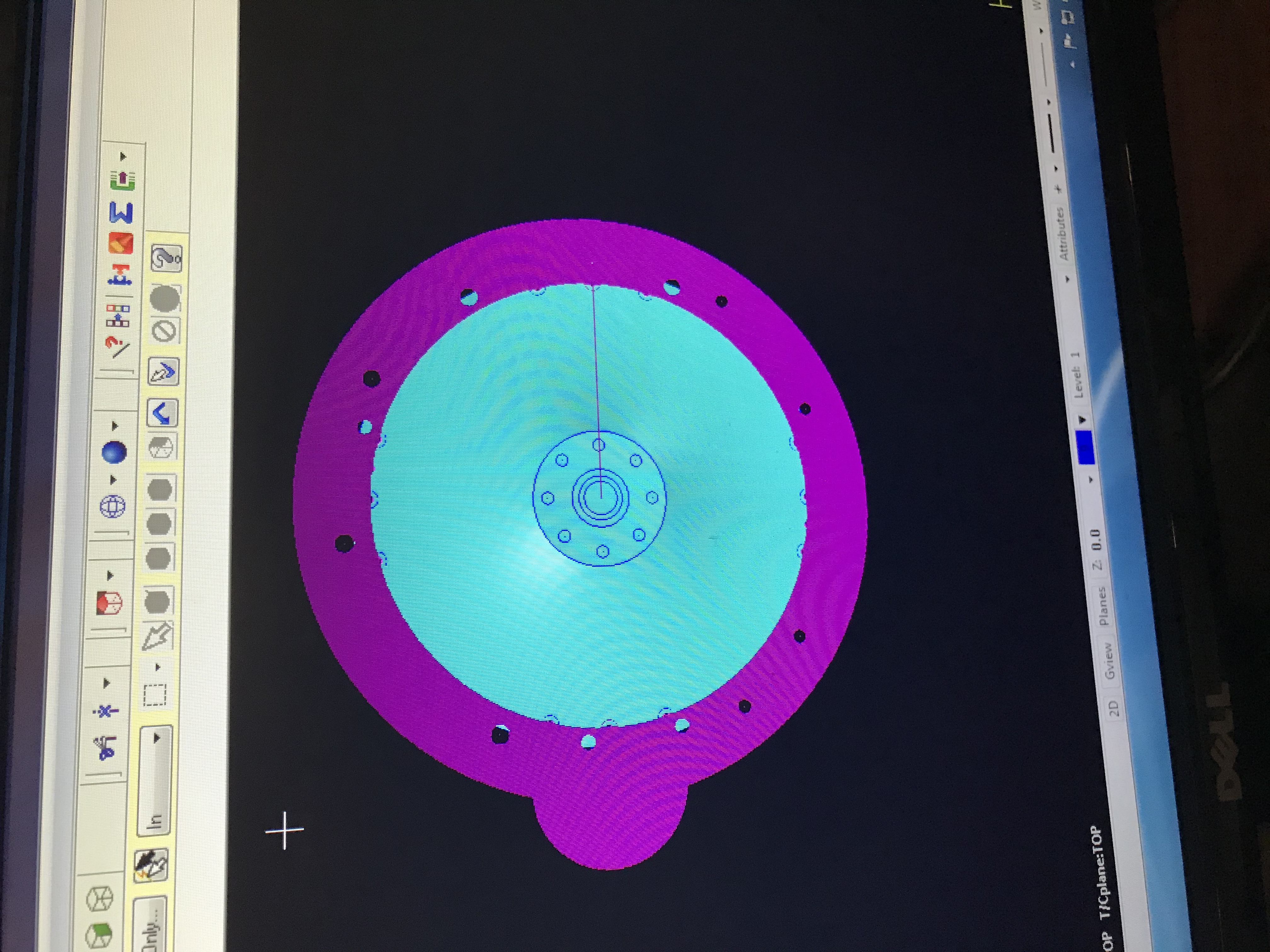

Got all the designing done finally and got all my numbers. Been slow going but finally got it. Now I just need to make the adapters.

Two flywheels... oof, that looks heavy!

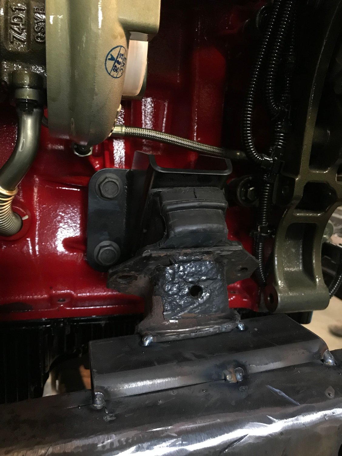

Sorry for being quite lately. I don’t get notifications so guess I need to come on here more even when I’m not working on the truck. But finally had more time and money to get stuff done. So far no hiccups just more and more planning and figure out the best options for what I’m trying to go for. Right now got the motor mounts all made up and welded on. Had to push the transmission back 4 in so there would be room for the radiator and fan. So I guess you could consider that as a hiccup but I already fixed that. Also got the dash gutted out to.

me and someone else at my work designed the adapters for the tranny and flywheel. I programmed and made the adapters myself.
