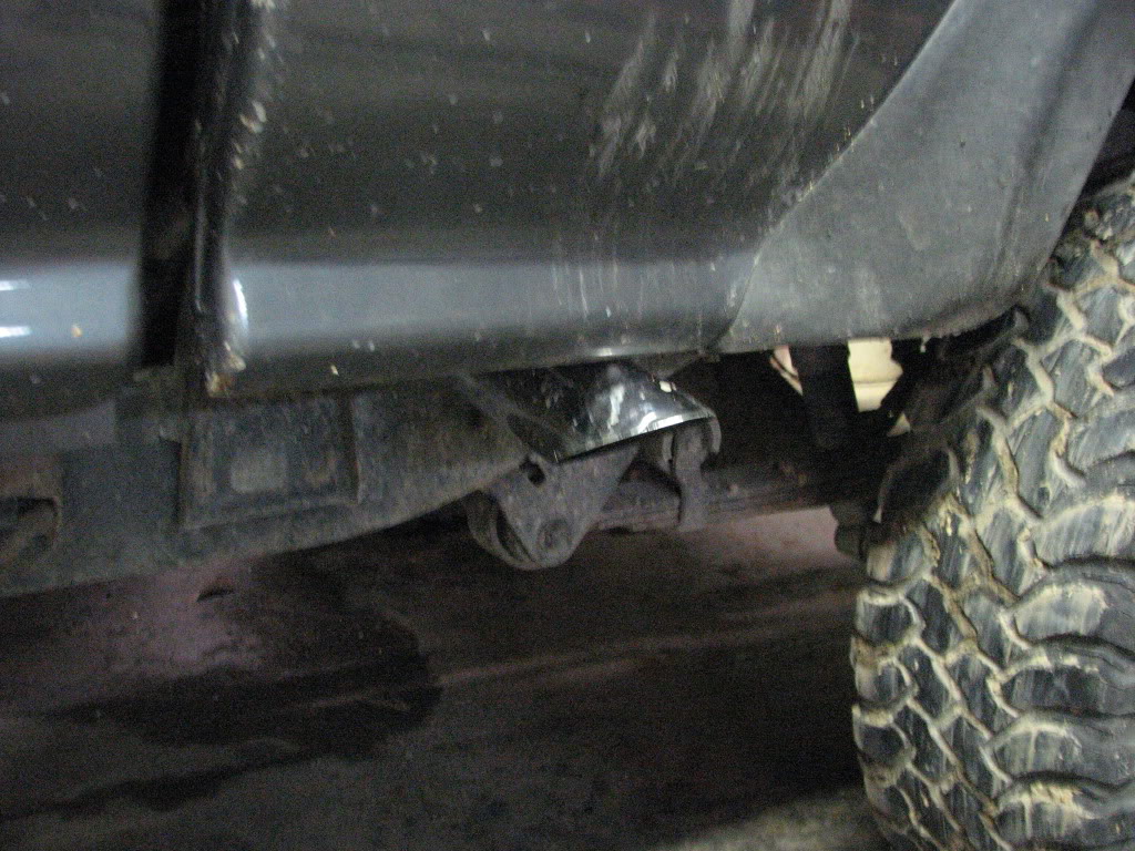

how are you guys routing your exhausts? i am curious....

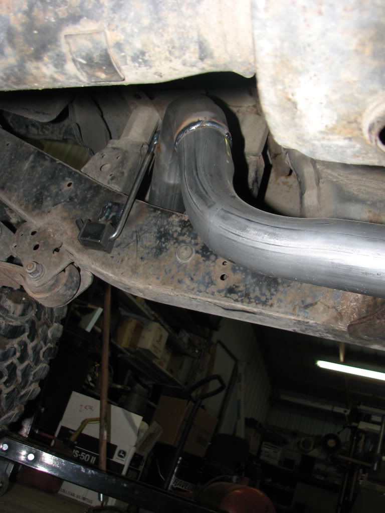

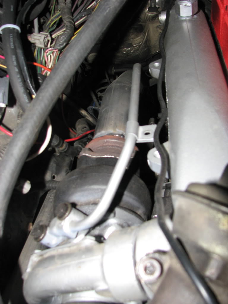

Mine is a little wacky but I am happy with it. It probably isn't the best for hard core off road things though.

Is there enough room to run the exhaust over the crossmember? I'm guessing no, is the e-brake in the way? I will need to to something similar when I swap to the 1kd-ftv.

do you have a cat or a muffler on that?

No mine is all pipe and its really not loud at all in the cab with the windows up. Down on the other hand its pretty noisy. There isn't enough room to get the exhaust over the crossmember.

thanks for the info Joe.
the exhaust is on the top of my list of concerns, di u relocate any lines or hoses? how close the the starter is that pipe?

The pipe actually runs way over the starter. It goes down next to the firewall. I finally got a little free time so I'll grab some good pictures soon for you. Here you can sort of see how the dp is routed. Name:  IMG_1367.jpg
Honestly I stewed about the exhaust for the whole build. I took it to a local muffler shop here in town and told him sort of what I wanted. He really exceeded my expectations. and It only cost me $150. I will have to look more closely at the X-member in the morning as It might clear on your truck. I had to move mine back and the frame is a different width where I moved it.
I didn't re locate any hoses that I can think of. Its pretty much the way it came out of the car. Being that you have the adapter it should be a decently straight forward swap. The motor mounts are a PITA just because of where they are. Did you order a flywheel too?
