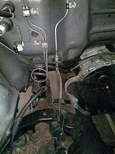

Ok, so i pretty much fell off a cliff with this project, just haven't had any time for it. I am however trying to scam some time here and there to continue. I have a couple questions ...
Before i drop the motor in for fit and to fab the engine mounts i am thinking i need to relocate a bunch of item... this picture shows where my exhaust needs to go.
looking at that it seems i might have to relocate the clutch lines brake lines and fuel lines... The fuel lines i may replace with lines designed for bio diesel.

your fuel lines to go to the othe side of the motor, you can route your clutch however you need to clear you exhaust, but keep the flex/rubber hose, these motors shake a lot, your brake lines should be ok, you can also wrap your exhaust down pipe with some insulating wrap which should be done to keep heat off the starter. are you going to relocate your trans? I moved mine back as far as I could to gain clearance in front of the motor.

relocate the transmission? no i dont think so. i was just looking to see if anyone else had relocated any of this stuff. i'll maybe make a heat sheild if i keep the brake lines there.
did u send the fuel lines up the other side then?
