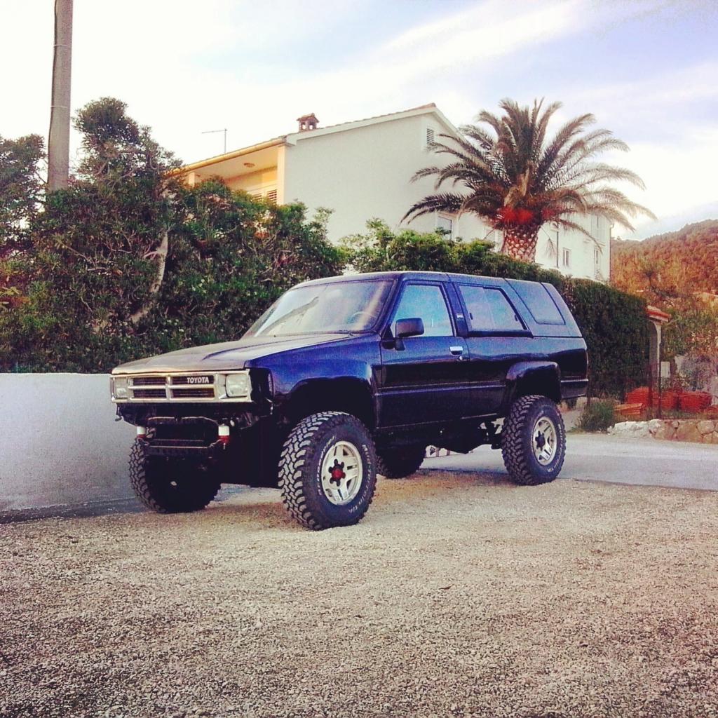

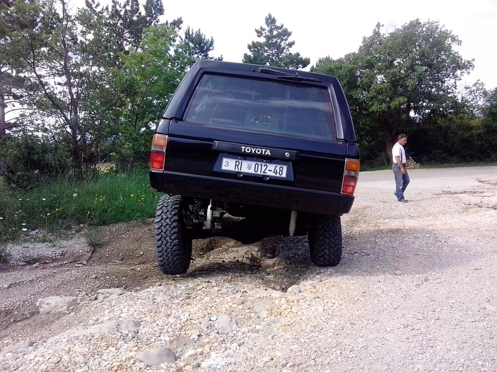

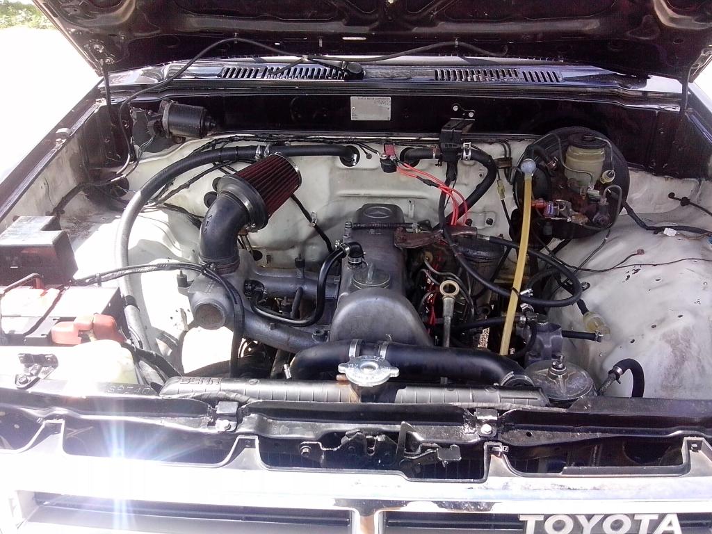

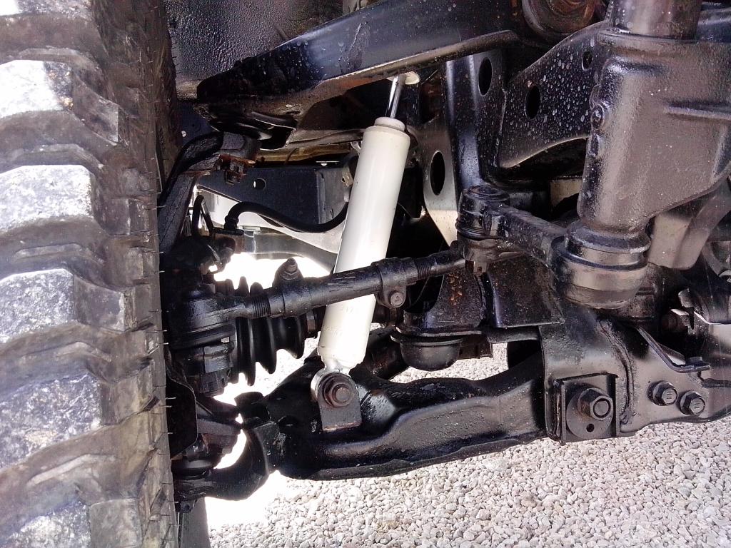

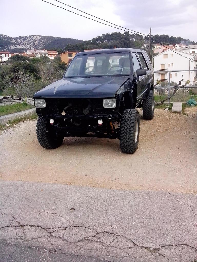

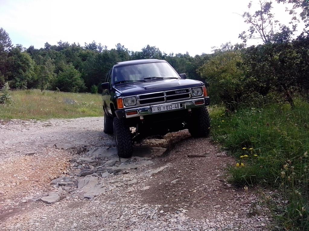

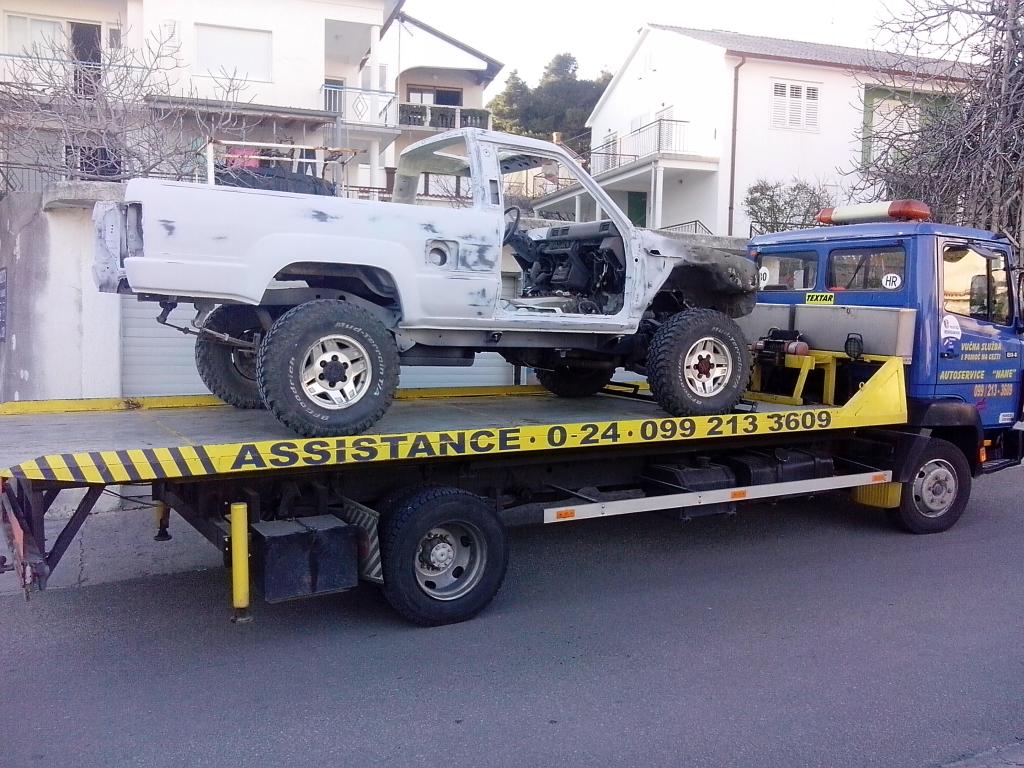

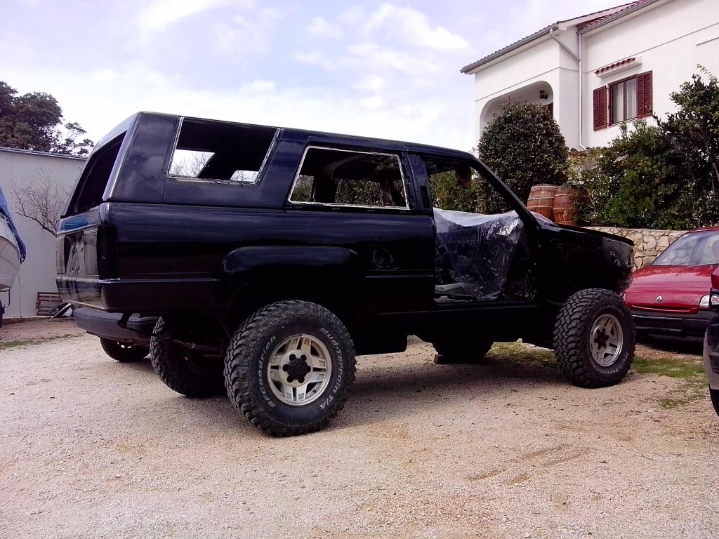

short update, this month is my swapīs 1st birthday so i figured i should share something:
all i can say is that OM616 with A340H stock torque converter is a REALLY weak combination, i canīt go over 90km/h downhills and uphill is struggle to achieve 50km/h.... i am searching for r150f tranny because i want to do the auto-to-manual swap... stay tuned

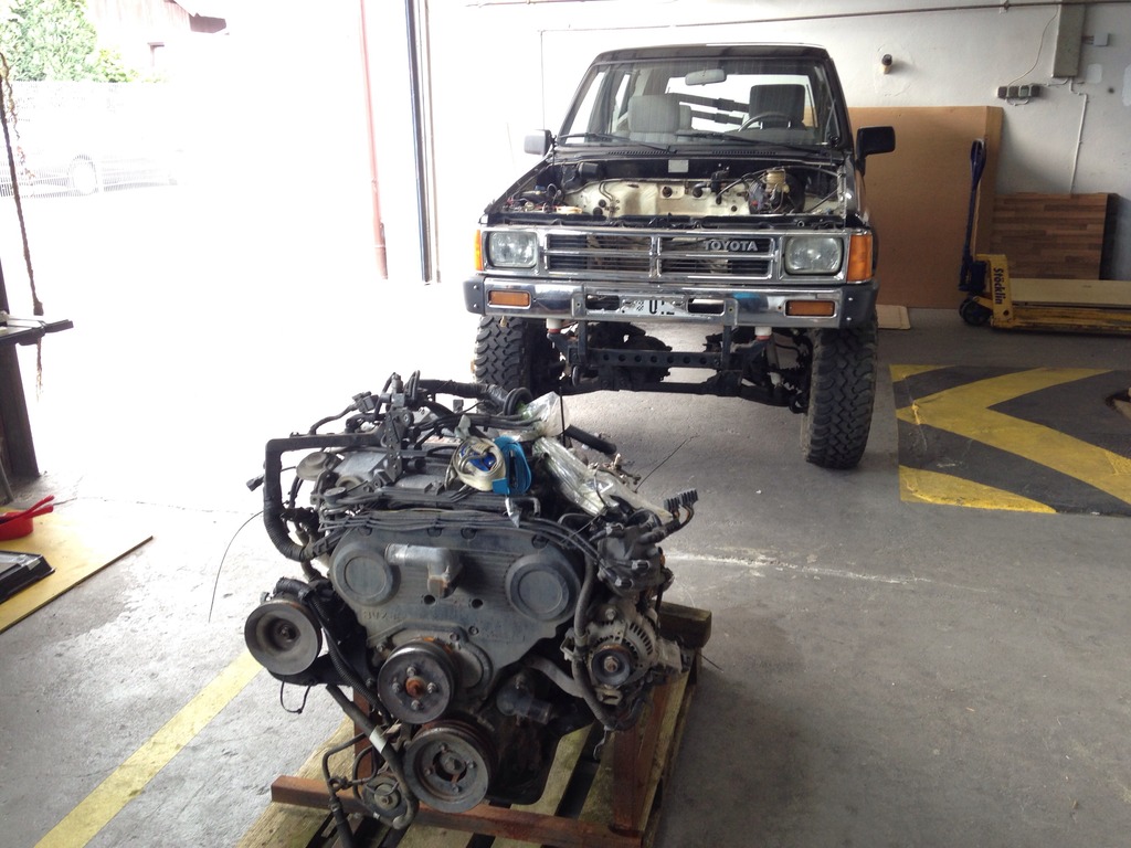

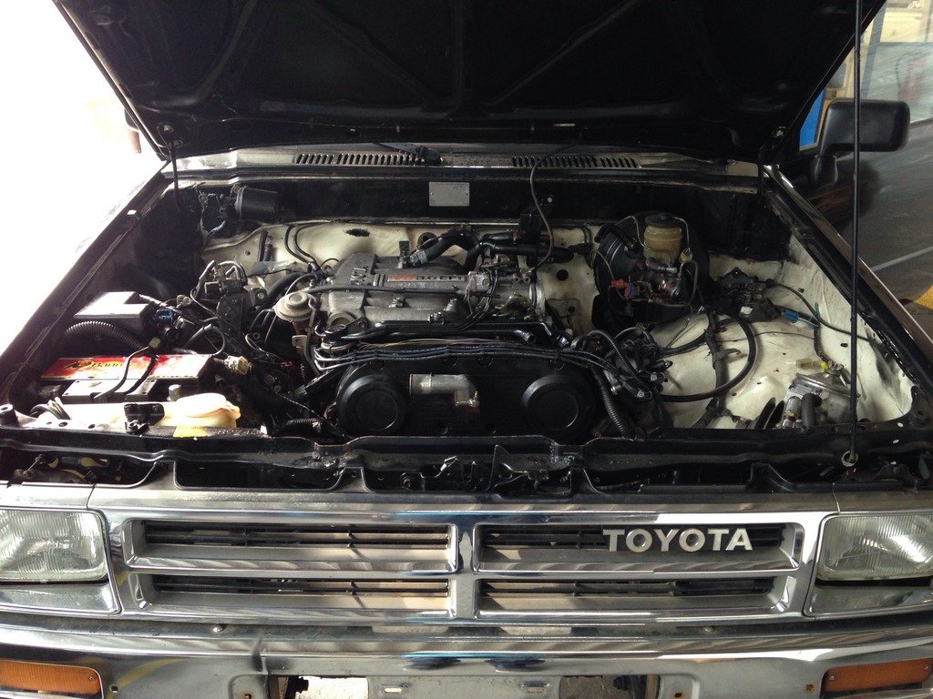

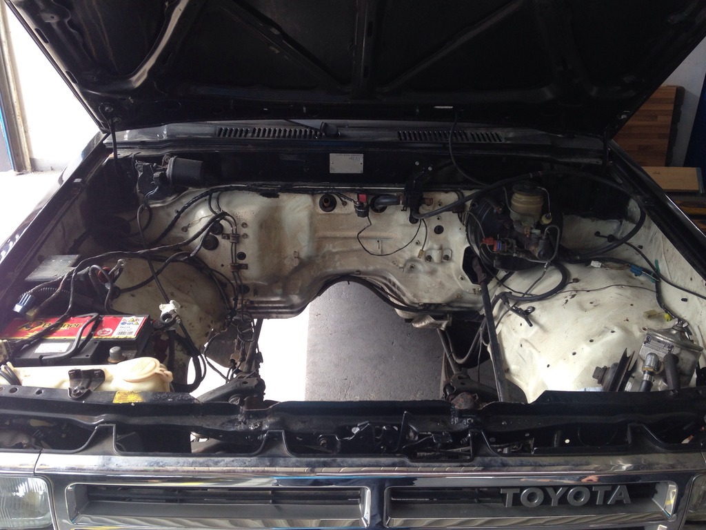

another update,
since i couldnt get my 4unner licensed with that OM616 inside (Germany, donīt ask), i have reswapped OM616 with 3VZE again haha... but this time 3VZE in "good" condition
i guess that this thread as "diesel swap" is for now closed
