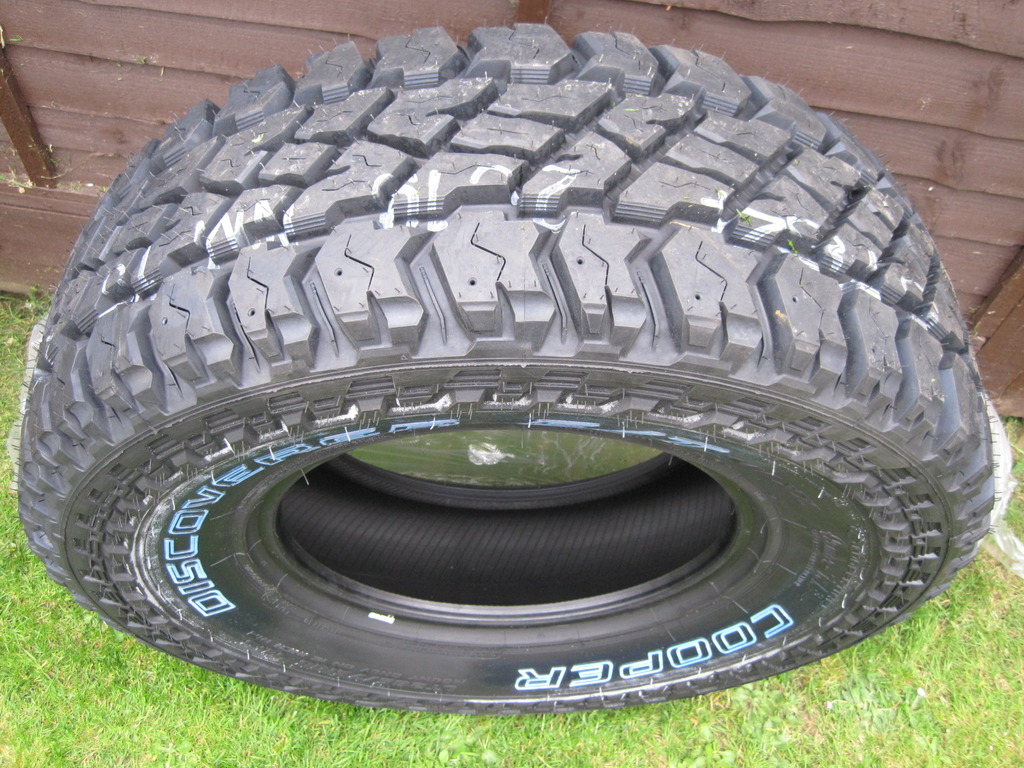

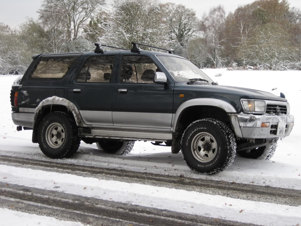

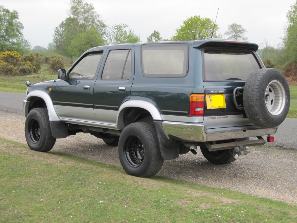

I've finally got my rear into gear and got moving on the conversion. The first thing I did was the body lift, but whilst I was waiting for a LS400 to come along, I thought I'd do a couple of other things to it such as replacing the rusted out rear quarter bumpers and some clear indicators. (At the moment I have no intention of replacing front/rear bumpers). I also managed to get hold of some wider, deeper wheels, (freshly powder coated) and new tyres to replace the road oriented ones. Here's some pics:
As it was
Now with 2" body lift and shiny, rust free rear quarter bumpers and clear front indicators (got the repeaters to fit)
Got these to fill the arches
