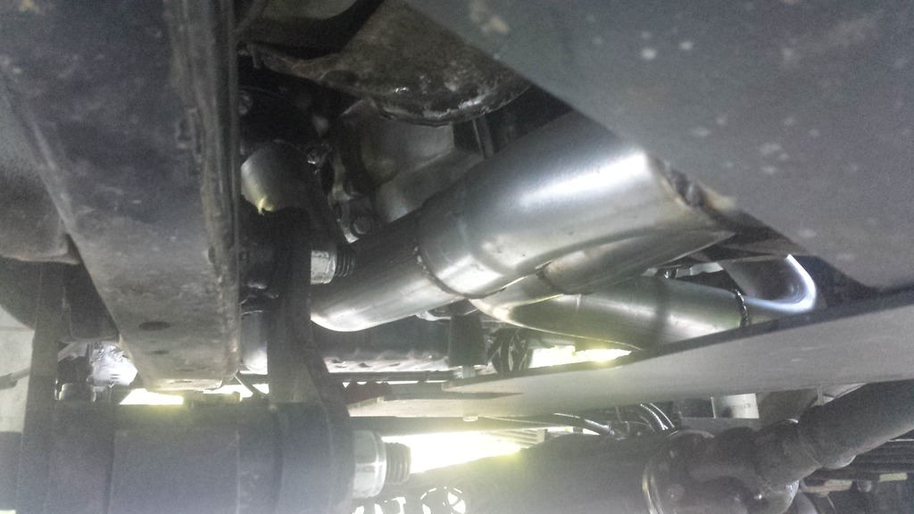

2.25" crossover to 3" exhaust
I have a 1994 4runner originally the 3.0 V6. It has the original R150 5 speed. I installed a 1994 LS400 1UZ mated to the R150 transmission. When I originally did the swap I was IFS. I have since upgraded to a SAS. I am running Yukon 4.88's front and rear Elocker rear and high Pinion elocker front. I am running 35" tires. I average about 16 mpg. I am heave as I am fully loaded for overland expo, bumpers, winch, a lot of recovery gear, chain saw, etc.
