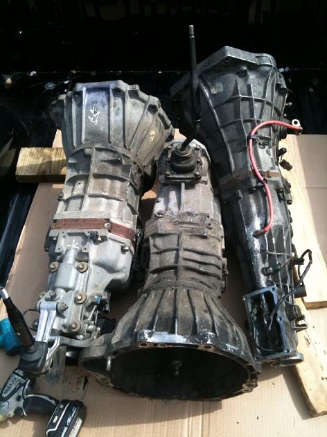

I dont want people to have to weld on their trucks. Not everyone has that luxury and it's not really necessary. Here's the first 3 tranny's loaded up for measurement. I should have the 150 trans next week.

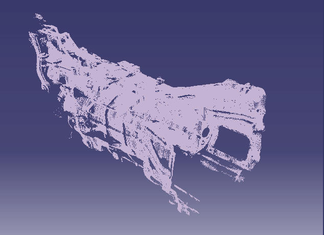

So this isn't a huge benefit but here is our initial scan of the R154 transmission, which is one on our list. It's not the priority, but just happen to be the first one we got done. I should have the W56 gearbox data done this weekend, and the R150 data and the scan of the engine bay done by next weekend. Something to look at for now, but at least putting some wheels on this project :-)
