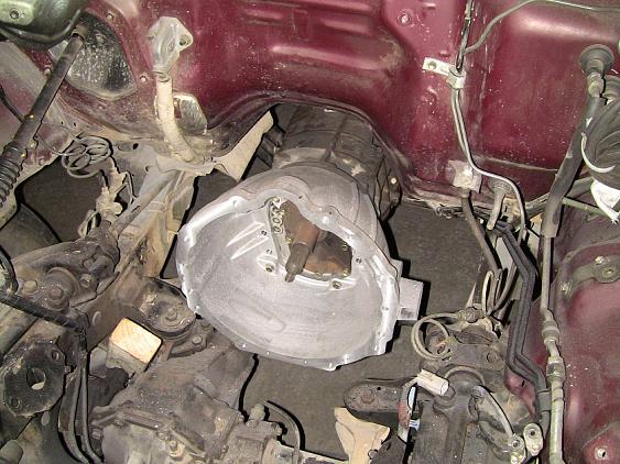

oh.. oh...OH!! r150->1uz For the freakin win! Its about damn time
You mean like this..
Gearbox is in stock location, we use a spal fan http://www.spalusa.com/store/main.as...&item=30100385 it works quite well.

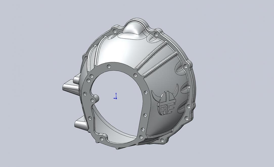

Those are beautiful bellhousings, is that a Dellow or Castlemaine or someone else? I think between those 2 companies you could swap just about any engine to any transmission :-)

Asgard's Avatar
Joined: May 2010
Posts: 6
From: Sydney, Australia
It's our bellhousing, the casting was done to our drawings, fully machined in house here. More info will come shortly
Is this something you are going to be manufacturing for resale?
Yes, We had 50 cast as a first run batch.
We have been busy with other projects for our parent company, I hope to be back on this on Saturday, working on the machining jigs for the remaining castings of the batch.
