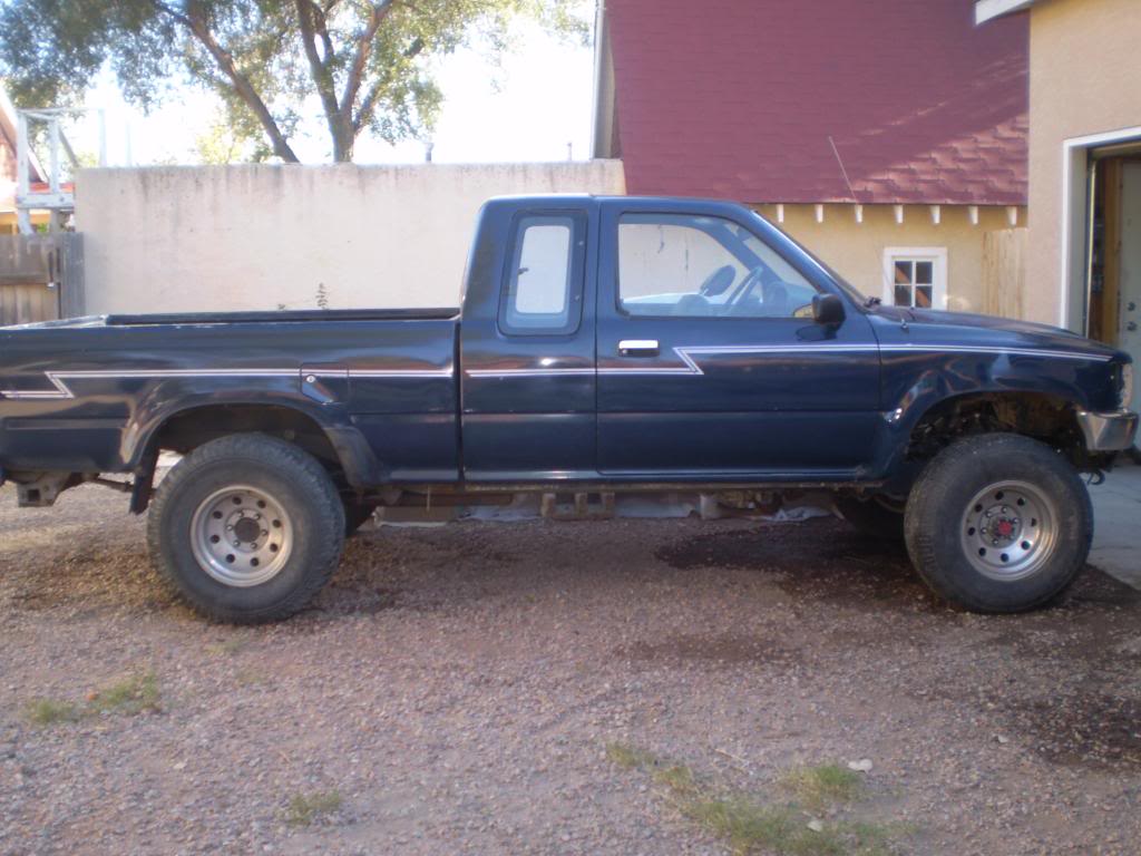

This is my 1990 Xtra Cab S.A.S., 1UZ-FE, Dual Tcase build
I've built so many different toyotas with different engine, transmission/tcase, and axle combinations, I thought I'd build something different.
I didn't put this in the solid axle swap forum because there is nothing special about it and there is plenty of axle swap builds.
So I thought I'd put my build in the engine swap forum.
Here's the truck I picked up for $400

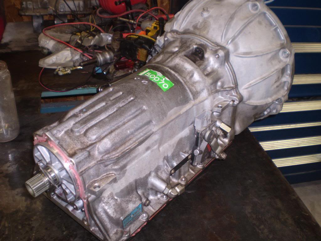

The V8, came from a 93 LS400

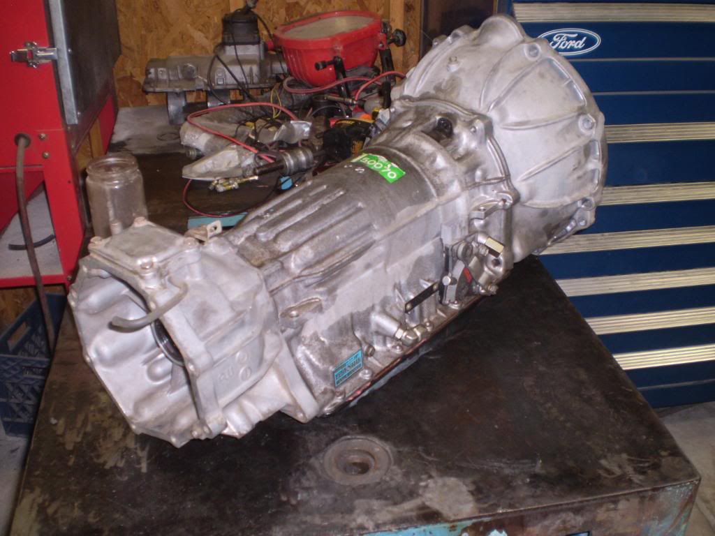

The output shaft and tailhousing from a 96 4Runner to convert the Lexus trans.

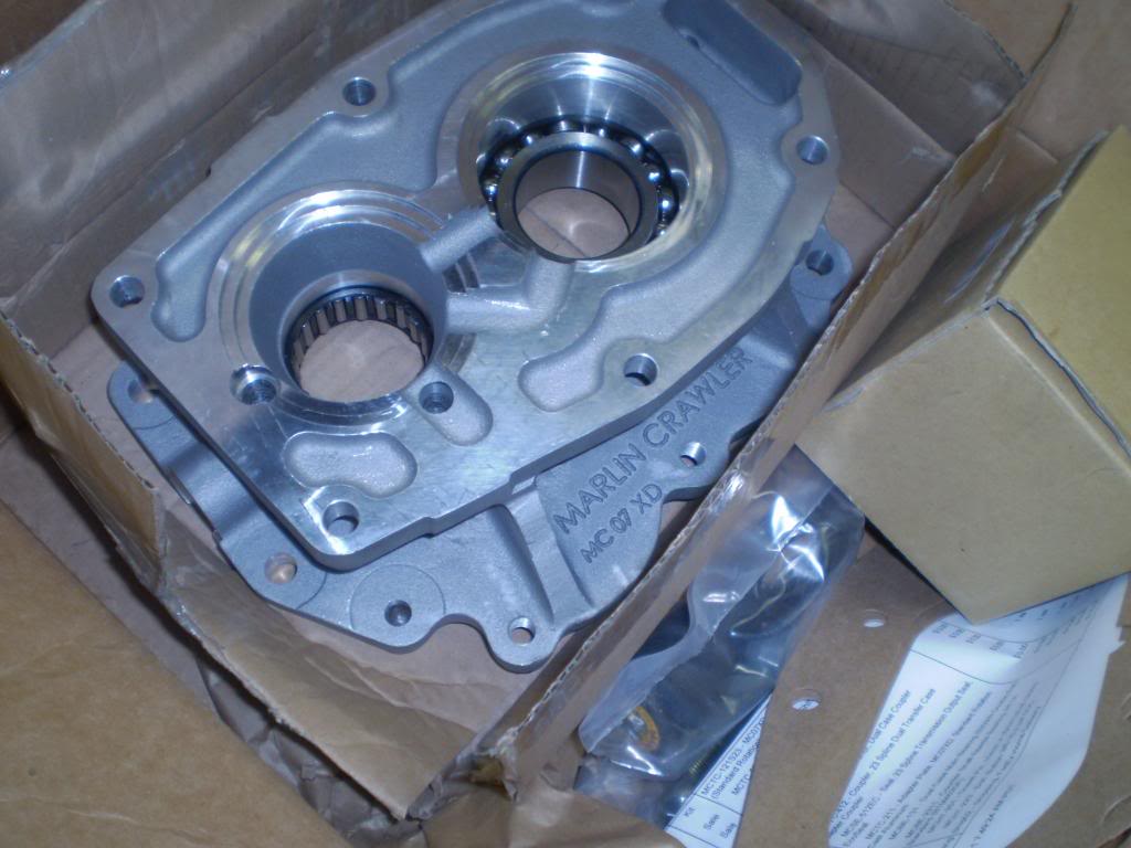

Just got the dual Tcase adapter while it was on sale

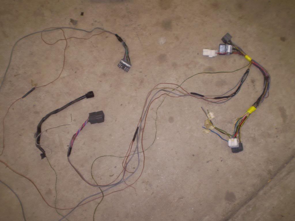

Just finished the plug and play harness.
Now I'm waiting for my SC400 oil pan, oil filter adapter and exhaust manifold.
Once I get these parts I can drop the engine in!

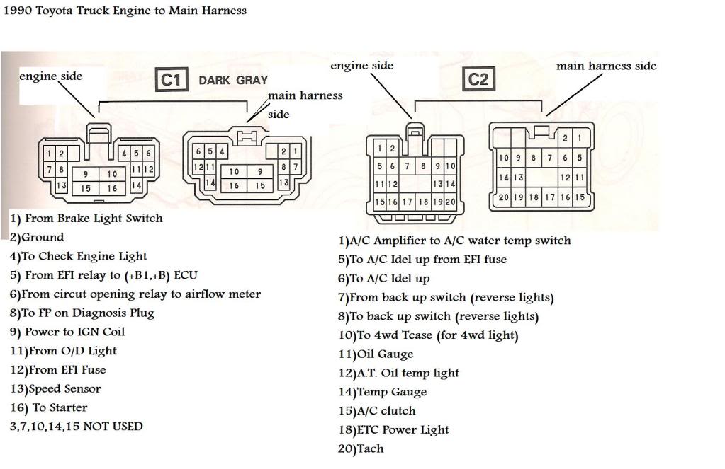

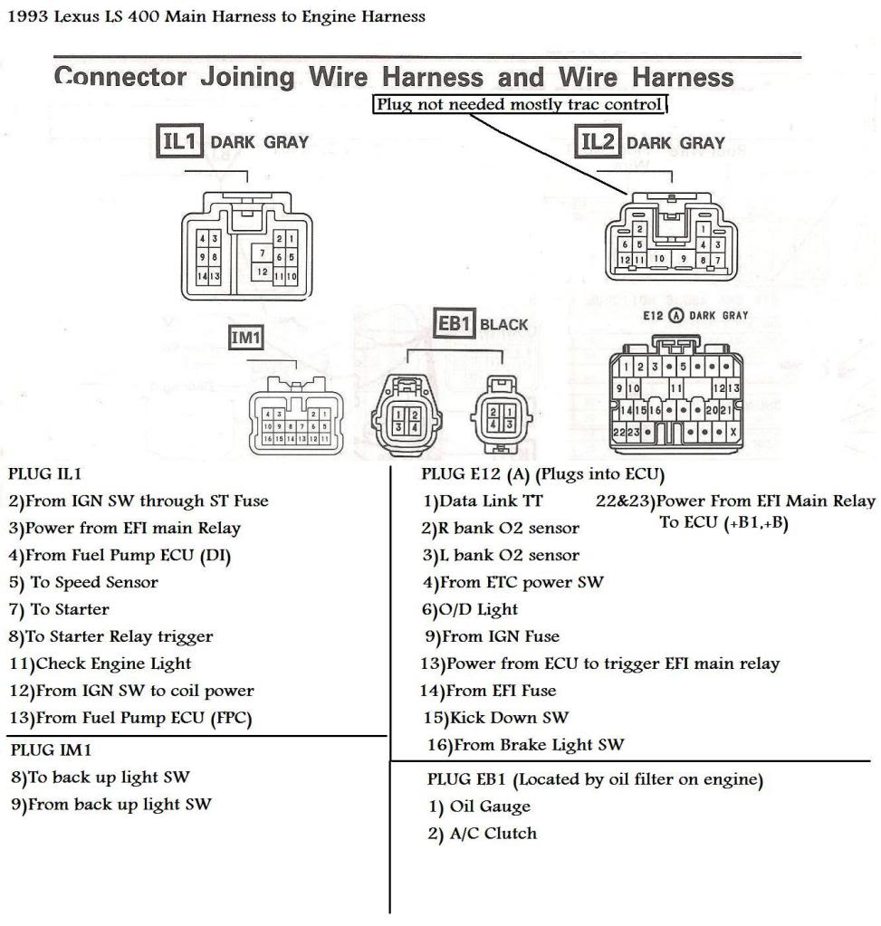

Here's some plug pin outs if this might help somebody.

hey man doesnt that extension housing clock (or whatever you call it ) to the driver side ?
and nice job on the connector pin outs.. i just noticed the 93 has the fuel pump ecu unlike the 90-92 ls 400 just uses a relay and no di.. the 93 ls 400 is like the sc 400's..

Yes its for a drivers drop case, thats why I have to buy this adapter from Marlin at the link below.
http://www.marlincrawler.com/transfe...v6-drivetrains
As far as the Fuel ECU, I didn't know what to do so I just left how the fuel pump is wired up with the truck EFI main relay.
so your just using the fpc off the lexus ecu to trigger the relay ?
im not really sure either as to how NOT to use the sc fuel pump ecu so im just gonna use it , .. the 92 ls ecu is so much easier just one wire the fc from the ls ecu to the fc on the 3.0 COR,done .. simple.

I don't know how important it is for the main ECU to run the pump, but the way I have it wired, when the main EFI relay turns on, so does the fuel pump.
I would of kept the pump ECU, but I scraped the car before I realized there was one. I guess if it don't work, I'll have to go to the junk yard and get one.

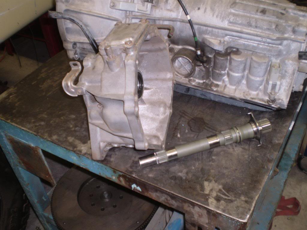

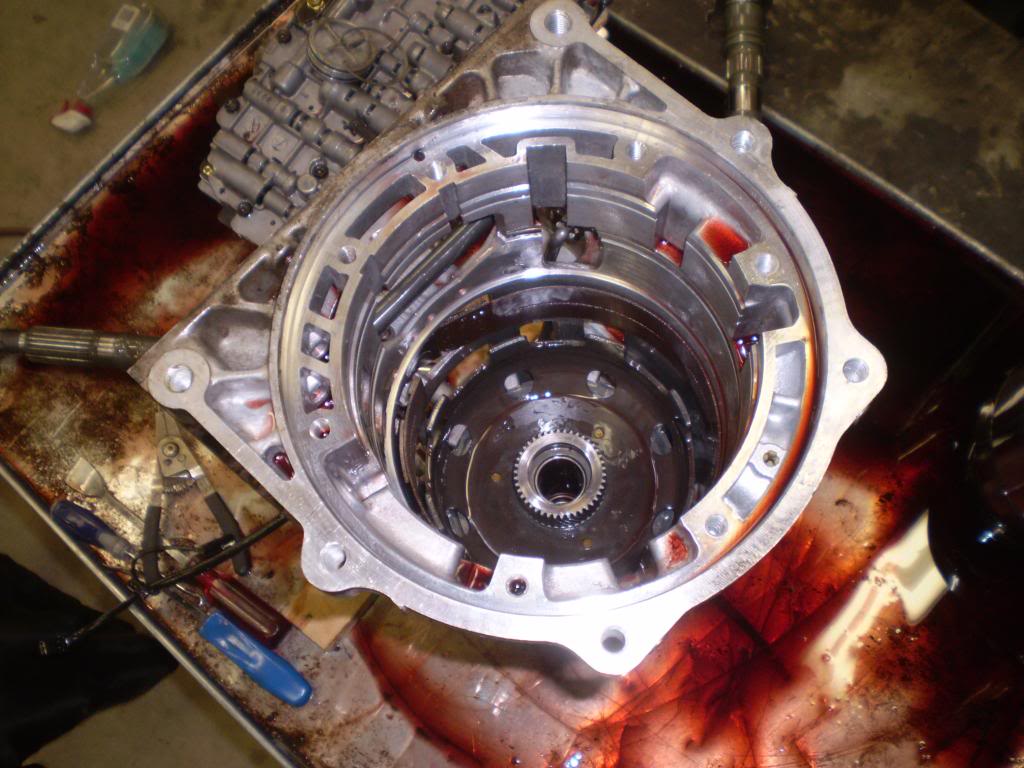

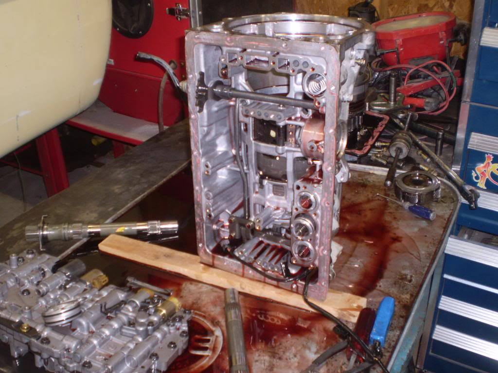

Since I'm waiting for money, I decided to swap the output shaft on the lexus trans.
All the guts tore out and output shaft removed
There it is, back together
It's now officially a 4wd.

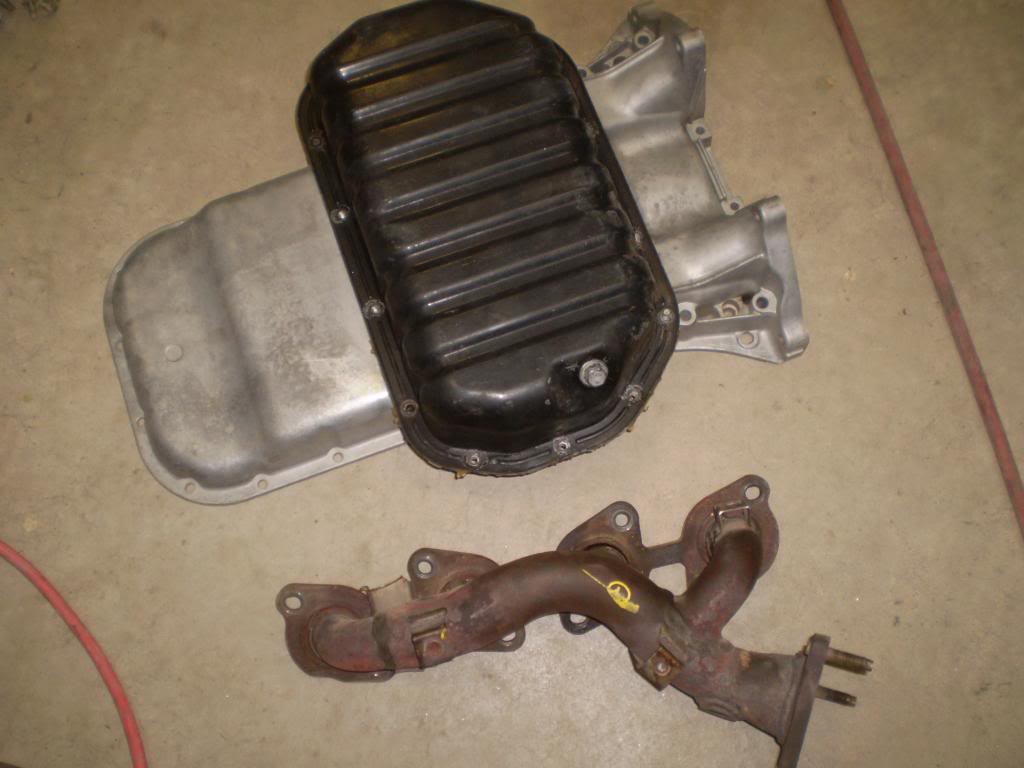

I finally got the SC400 parts, Oil pan, left exhaust manifold, and Oil filter adapter. I had to drive 350 miles to a Upull and Pay down in Albuquerque, NM. I got all this for $80 plus gas.

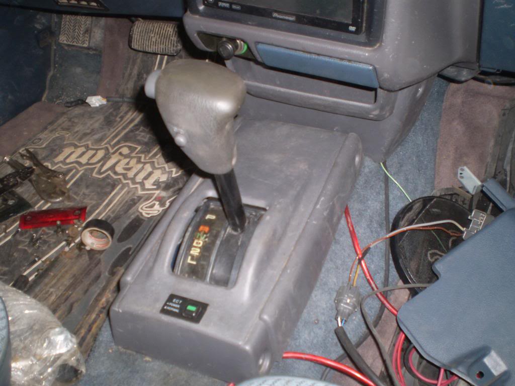

This is what I'm going to try for the shifter, it's out of a 95 2wd 4Runner.

Old 05-10-2011, 07:37 PM
toyminator2000's Avatar
Join Date: Jan 2008
Location: St. Louis, MO
Posts: 601
Received 1 Like on 1 Post
Did you get the dipstick & tube and the manifold heat shields?
Old 05-10-2011, 07:57 PM
TheMadScientist's Avatar
Join Date: Jan 2005
Location: Colorado
Posts: 28
Received 3 Likes on 1 Post
No I didn't get the heat shield and I was half way home when I realized I forgot the dipstick/tube. So I figured I'll make the old tube work somehow.

350 miles wow i know toyminator has parted out a few sc 400,s and may have some parts you need .. i also have some if you need any .. i may have the other sc manifold, i cut one up then decided not to use them and still have the other but not sure what side its from .. ill check if your interested .. i also have a few of the sc fuel pump controls if you want ,, did you get the oil pick up ?
Old 05-10-2011, 08:14 PM
RMA
RMA's Avatar
Join Date: Dec 2008
Location: San Jose ,Ca
Posts: 2,505
Received 16 Likes on 16 Posts
one mor ething , not a big deal but now the oil level and and oil temp are on the opposite side .. might want to extend the wires since you still have the engine out.
Old 05-10-2011, 08:28 PM
RMA
RMA's Avatar
Join Date: Dec 2008
Posts: 2,505
never mind on the manifold i have the same side as the one you have pictured .
Old 05-11-2011, 12:00 PM
Join Date: Jan 2005
Location: Colorado
Posts: 28
I'm using the truck cluster, so isn't the oil level useless? I did find an oil pan on ebay the the guy was selling all the pieces seperate, total price shipped @ $200. I then found one at a junkyard in Denver at 100 miles away, but they wanted $100 for the pan and $80 for the manifold + $$ for the oill filter adapter. So I figured driving 700 miles round trip was cheaper, $80 for everything and $80 for gas, total price spent $160. Yes I did get the pick up tube.

Originally Posted by TheMadScientist
I'm using the truck cluster, so isn't the oil level is useless? I did find an oil pan on ebay the the guy was selling all the pieces seperate, total price shipped @ $200. I then found one at a junkyard in Denver at 100 miles away, but they wanted $100 for the pan and $80 for the manifold + oill filter adapter. So I figured driving 700 miles round trip was cheaper, $80 for everything and $80 for gas, total price spent $160. Yes I did get the pick up tube.
well the oil level and temp are only for warning lights so maybe you can hook them up to a spare bulb in your cluster.. ABS or something ..
or just not mess with it...
