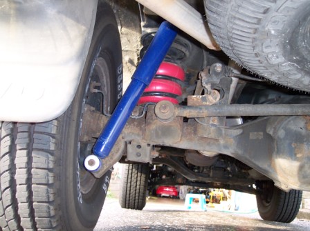

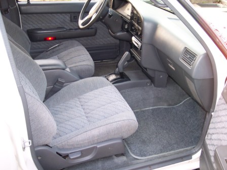

So this is the donor, she barely has any rust but the steering parts and suspension sure showed the 210k on the ol' ticker. The guy I bought it from swore the head gasket was squeezed and wasn't even gonna sell it. I told him it didnt bother me and he asked me if $1650 for both trucks was ok??? uuhh SOLD!! I drove it to the shop and it never over heated but does use about a pint of coolant every 100 miles or so. I did have to put tires, shocks, rear air bags, rotors, calipers and one CV. Still worth it to me. post more later

Originally Posted by maniacmotorsports
rear air bags
Rear air bags???????

yup..was the most cost effective fix for the "saggy butt". Had just tapped myself out buying momma a new car.

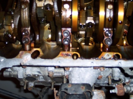

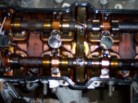

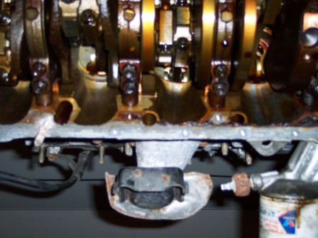

Things are not looking good on the motor, I got the valve covers and oil pan off as well as the plugs so I can rotate the motor and durring the rotation it hangs up like it has a piston stop in it. @#%&*!!!!!!!! this is the second motor in a row from a place I'll wait to name til I see how they handle it..again!! The first one was supposed to be a 75k one but when I popped the drain plug bout a liter of baby poop foam came out, after further inspection I found about 2in of silt and dibris in the intake valley and all the plug boots were full of water. Clearly to any tard they sold me a flood victim. They dropped me this one that supposedly has 116k, this thing is crazy corroded!!! This is 3 strikes for them in the same order because the putz that carried the transfer case carried it by the shift rods and the three tiny shift tabs and all the springs and balls popped loose inside it...guess they thought I needed some schooling on the VF1A. I know it inside out now.

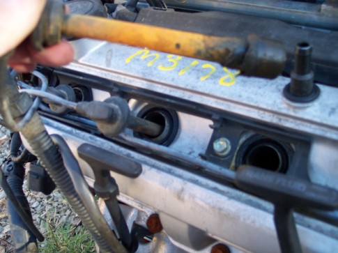

this is a few of the plug boots that was full of black sewer snot. They still havent come back to get this one so I'll prob end up trying to make a good one out of parts from both. Unless someone has any ideas as to what may cause the rotation to hang up like that in two spots, the same places in the rotation, then I will first remove the valve train and then the heads. Only thing I can think of is a misaligned timing belt causing valves to come in contact with piston tops. If you rotate hard and fast then it will jump past the snags.

i would maybe pull the cams, you could have a valve sticking. it looked pretty clean to me,
it might be a good idea to inspect the timing belt and pulleys.. t-belts should be replaced every 100k or 7 years.. or you could have a bunch of crap in the water pump?

much thanks for the reply Birdduck, I read your thread along with twisty, RMA and several others I cant recall. They have all been very very informative, almost too much info to retain.
The first motor looks pretty clean on the outside but the water and oil foam that came out the drain plug was too concerning to even dig into it. From my experience the only way to foam up oil that thick and nasty is to run the motor with water in the oil. The second motor has a very thick white corrosion crust all over it and some of the small tabs, bungs and edges are corroded away. Lots of bolts broke off in it. I haven't yet tore it down far enough to put my eyes on it yet but if the water pump is driven by the timing belt then it makes sense that it might make it hang up.(all pulleys and Alt are locked up) Durring several rotations I inspected all the valve stems through the exhaust ports and all valves were raising and lowering..still doesn't mean something isnt blocking a valve or two from a complete seat so I will dig a little deeper tonite. If the first motor turns out to be ok some how then I will at worst have a xtra set of heads to port/clean up from this crusty one.

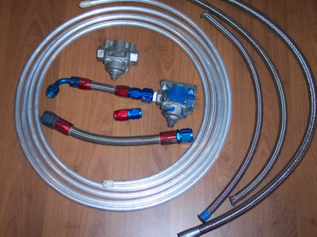

yeh..I was thinking running the main through something a little larger til it splits off into individual wire pairs. I have some stainless braided hose and aluminum A-N fittings along with a few holley fuel press regs with the guts out to act as junction boxes. Once done it should look like a nitrous set up on a pro mod. The injector wires would look much like a fogger set up with the hard lines run nice and tidy like the vacuum hard lines on the front of the 1uz intake. All this was intended for aesthetic purposes but I guess it sure would keep ur harness safe and dry.
