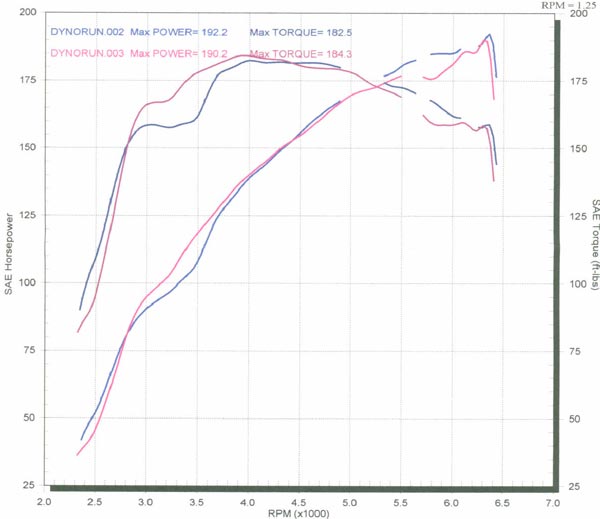

I don't have any practical experience to add to this discussion, but I did want to say that the below post from dark_fairytales appears to be incorrect, in that they claim the 5VZE engine makes 81 lb-ft of torque at 2100 rpms, whereas it looks to me from the dyno graph that the vehicle dyno'ed had an automatic transmission with an unlocked converter, so the torque curve at that low of an rpm is unreliable for comparison purposes. A quick google search tells me stock Taco converts have a stall speed of 1800-2200, depending on the year.
That's not to say that the 7m doesn't make more torque, but I don't think it's the 100 lb-ft difference at the same rpm. The torque from the 3.4L at 2100 rpms is probably closer to the 155ish lb-ft that the curve shows at the slightly higher rpm.
Also, the Supra dyno curve appears to have been from a manual transmission car, which will put down a higher number than the auto will anyways, all other things considered the same... and the Taco dyno probably was 4wd and had to go through a transfer case after auto tranny, which = even more driveline loss.
The point to all my jibber jabber is that comparing chassis dyno graphs between the two motors is pointless due to the extreme variences in vehicles... if you can find engine dyno graphs then that's fine, but to compare across the vehicles, I would build in at least a 20 lb-ft cushion, and understand that you're not going to get a reliable reading in an auto tranny vehicle below 2000 rpms unless the pull is done with the converter locked in the 1:1 gear.
