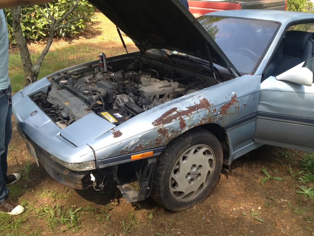

^I assume he used the 5mge/22r combo.
Dude that turbo looks awesome in there! It kinda makes me want to change my mind from an N/A swap. I'm in the same mindset as BMcEL; i don't know if i want to deal with a turbo engine. But....It's kinda too late to be having second thoughts now!! Lol.
Donor Supra!!
INFINITY>>>>> WE WANT VIDEO!!!!!!!!!!!!!!!! (X1000) <That's 16,000 exclamation marks right there! +1

Originally Posted by streetlancer
Donor Supra!!
Almost picked one up for $800 the other day. Just too much going on right now.
Funny you mention that; that's exactly what the owner was asking. I talked him down a bit though.
