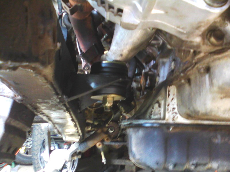

This is how I did mine.
I used the larger bushings.
http://www.energysuspensionparts.com...-Isolators.asp

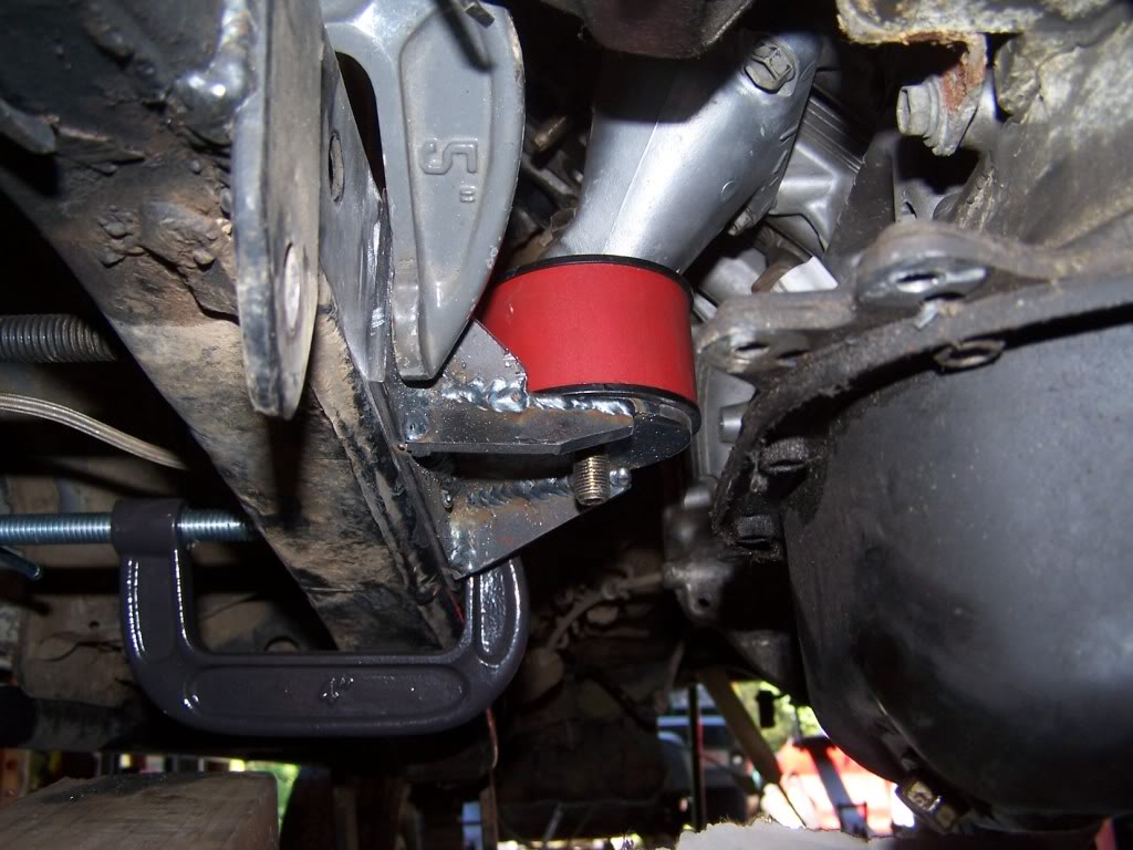

You can either move back the crossmember and make new mounts on the frame or modify where it bolts to the transfer case. Front Range Off Road make a good design if you want to make new mounts on the frame.
Don't need the traction control.
The 3vz radiator may work but I'd keep an eye on the temps. It just doesn't hold anywhere near the amount of fluid that the Lexus radiator does.
Here's my mounts.

At least I was on the right track with the mounts, glad to know you don't need the TCS, and thanks for the info on the cross member.
I was very skeptical about using the 1uz mounts. I like the urethane block style for 2 reasons; Near solid and smaller / can be made smaller.
Thanks for the reply.
