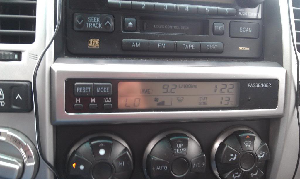

First of all.... the mileage that Toyota posts for the government website is under what it can get. I have seen many people get more then 17mpg on their V8 models in the thread that was posted and I am running a V6 that gets better mileage.
I dont know how people drive down south but I am getting my stats from actual real life experiences. I am running synthetic lucas oil in my rear diff and regular oil in the other locations. I have brand new Denso O2 sensors and I fill up at the same gas station making sure to get clean gas without any additives. My fill ups match what the computer says. I have seen lower numbers but the picture below is a 1200 km/750 mile trip. The only time i See numbers above 10L/100km is when I start/stop in town to and from my school. I dont even get to warm up the truck before it shuts down again. After 2 weeks of this and the ocasional trip across a 35mph city in stop and go traffic I average of 13L/100km which equals your 18mpg US. That is the absolutely worst mileage I get on the worst possible day.
My tires are goodyear duratracs, they sit at 50 psi all the time, I got the correct denso spark plugs from toyota and I dont punch the gas to get up to speed but I dont drive like a granny. I coast to stops instead of staying on the throttle till the last moment and adjust and hold my speeds before hills (and we have lots being British Columbia).
Maybe this will help others but I think the 5 speed auto with a slightly lower gear ratio behind the v6 would be the best bet. I will know more this summer since I am switching the transmission and transfer-case for a lower mileage 5 speed version. From what I can see its a plug and play.... and a couple bolts for fun :p
Ps. I am not being abrasive or defensive in this post. Just stating facts and answering questions
