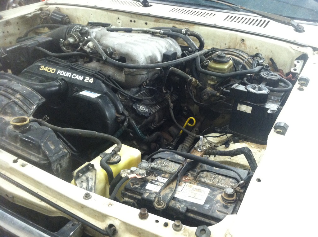

I've had a lot of Toyotas over the years. Whitey Lewis is my most recent '89 Xtra Cab Pickup. I've had great luck with the old 3vze in the past, and this one was no exception until it started the typical rod knock a month or two ago. Luckily the 3.4 gears had already been turning for a while in my head, for some reason I knew this 3.0 wasn't going to hold up. It had barely turned 190k when I pulled it a few days ago.

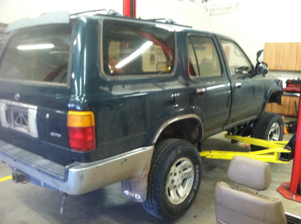

I happened to find a local YT member who was selling his project '94 4runner, complete with 3.4 and most of a SAS. As quickly as I could I headed south to pick it up and get rolling. The Runner was almost too nice to pick parts off it, but I had to do it. I still am sitting on the shell because the body and interior is way too nice to send to the scrapper.
So I lucked out, the 3.4 already had the proper oilpan/pickup/dipstick, an almost complete driver's side crossover pipe, completed wiring (unfortunately wouldn't work with my truck), new plugs and a fresh oil change. I threw new seals and timing belt kit at it and we were ready to rock. The only downside was the auto harness and ECU, which I figure I'll make work for the time being until I can find a manual one that doesn't cost as much as the truck.

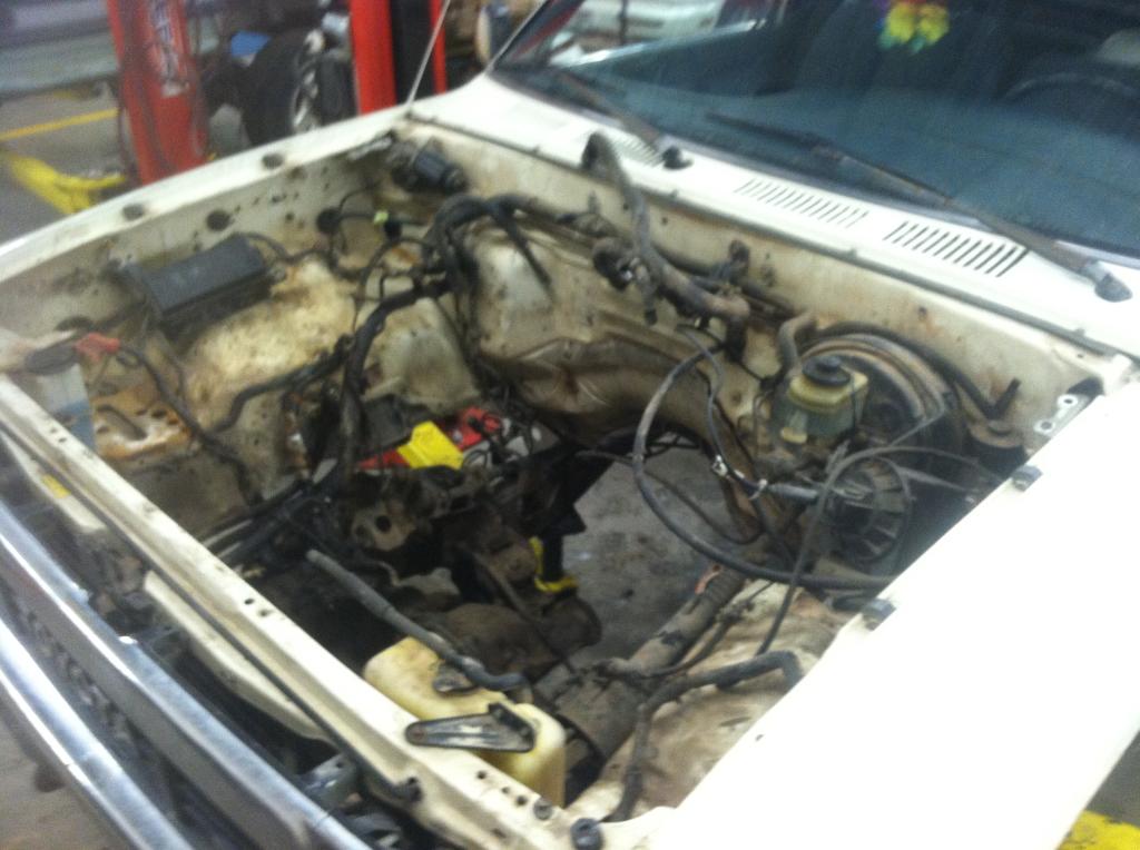

So I accumulated the last of the parts I would need, changed the timing belt stuff and crank seals last week, and drove the 3.slow into the shop one last time on Thursday afternoon. The motor was *almost* out in couple hours if not for a pilot bearing-stuck-to-transmission snafu that burned up an hour or two of cursing and prying and sweating. But it was free! And it resulted in my having to pull the trans as well which was actually kind of handy in the long run.
Of course I took this time to dutifully scrub Whitey's engine bay to a spotless shiny work of art. (just kidding, though I think I did pick a couple leaves and a dead bug out from under where the mass of vacuum hoses and switches once lived.)

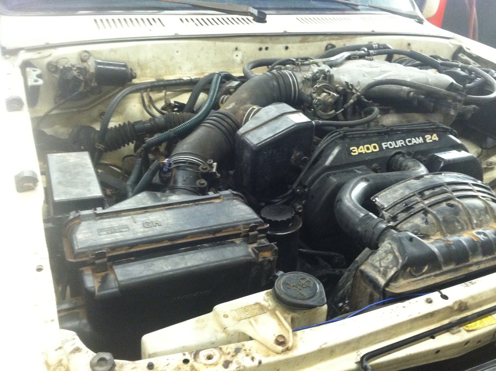

Got the cooling system burped today and life is good. Ended up switching fans with one from the 3.4, the 3.0 one was just grazing the shroud under torque. Swapped tachs with the one that Mike had already done the resistor mod to and it works like a charm.
Went ripping up one of our local passes at 80+ miles an hour- definitely never possible with the old wheezy 3.0. Here are some random pics.
I went with stock airbox:
Relocated the battery and made a quick and dirty bracket for the evap:

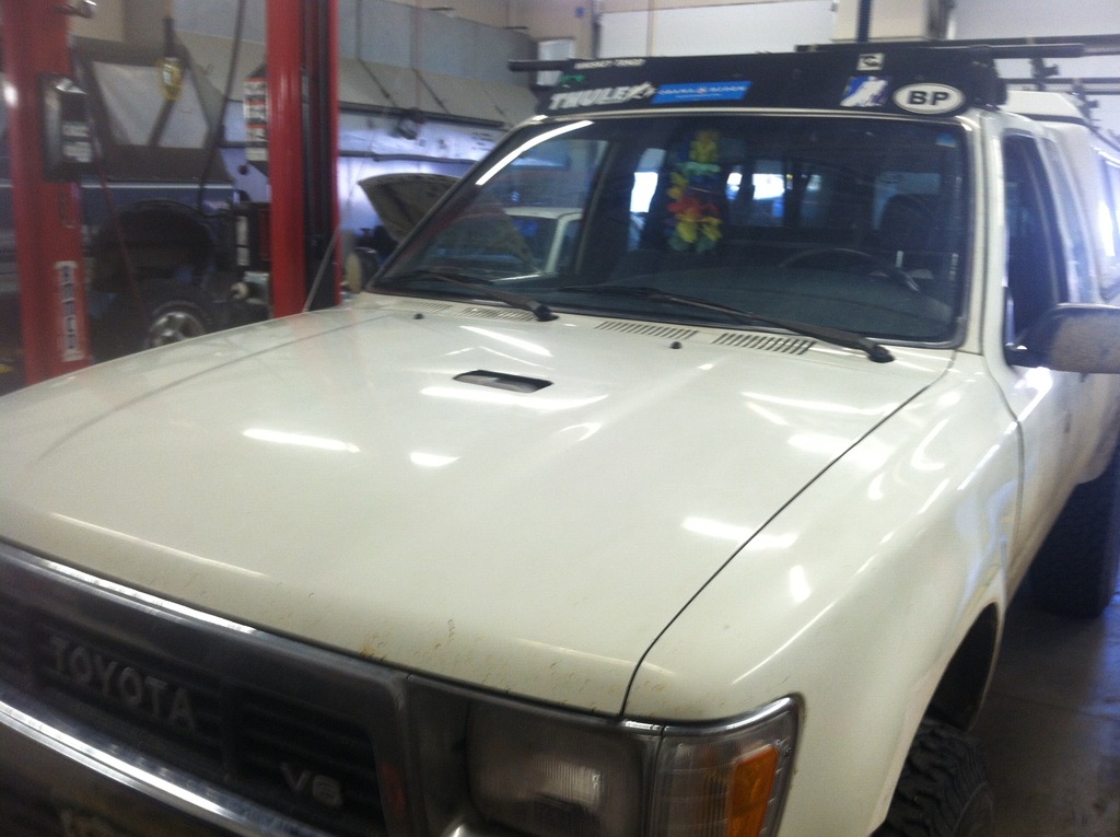

Typical hood cut, I'll work on a little bump or scoop this weekend:
