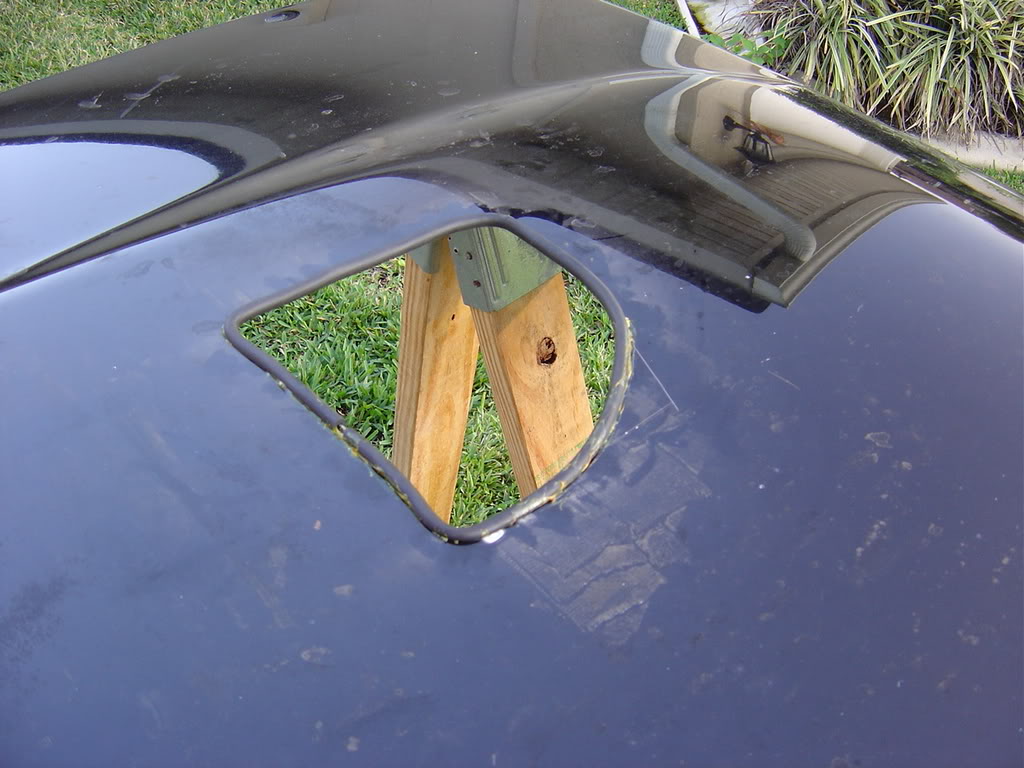

I ended up cutting a small hole. Simple enough for now:
I don't have a body lift or a supercharger.
Breknraj did a really nice mod to his hood also... but I can't find the thread about it. I thought it was in his 3.4 swap. Maybe he'll chime in or PM him for some more info.

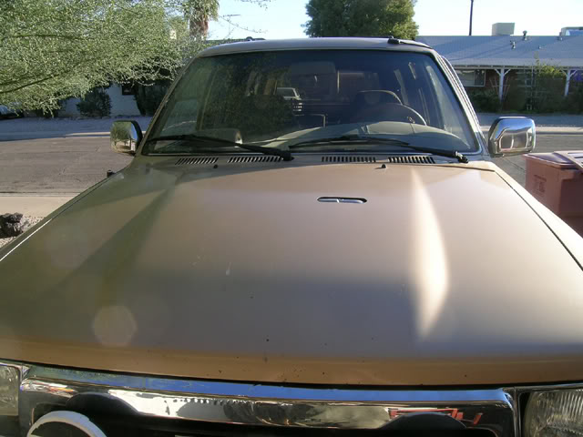

hood scoop
I used a smaller copy of the Mustang scoop (Evil-bay $40). Long-term plans call for a cowl-hood. I don't have any body lift, so I needed to trim about an 8x10 offset hole in the hood.
