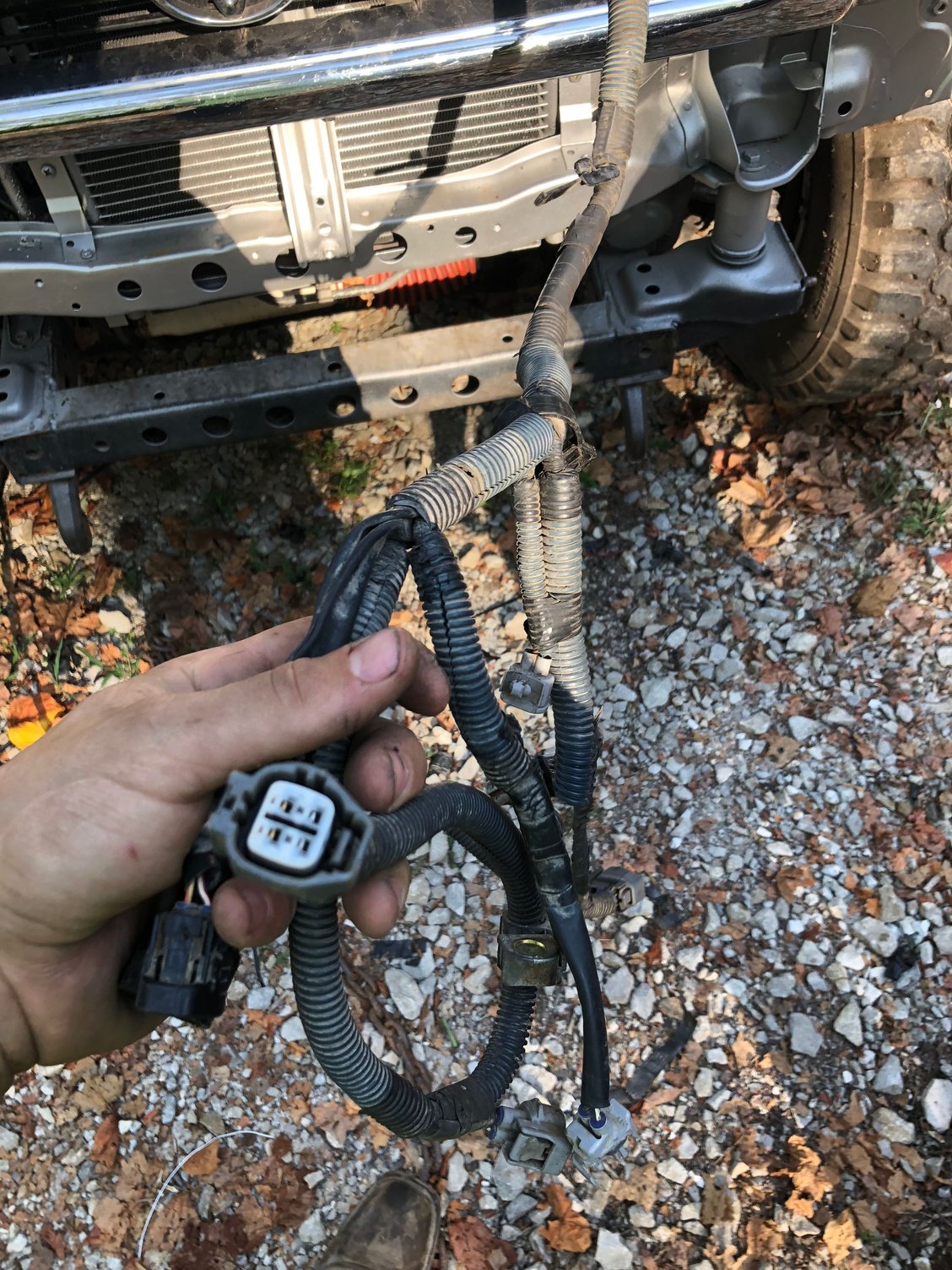

I’m down to the last little nitty gritty on my swap and was wondering if anyone could give me any information on what some of these vacuum lines run or where these wir s go. It’s a 1996 Tacoma auto 3.4 into a 1991 4runner manual

First pic I believe the hose goes to a 4x4 solenoid on the drivers fender, should come from a tee on the manifold
Second one not sure but looks like a charcoal canister
third looks like it’s from your old harness
fourth I’m not sure what your looking for on that but I think that goes to battery and alternator if that’s the wiring bundle I’m thinking it is
the rest is all auto transmission plugs and transfer case plugs and speed sensor stuff
the last picture I’m not sure, that’s coming straight out of your fuse box right?

It doesn’t show the end of it but that’s the direction it goes off in
