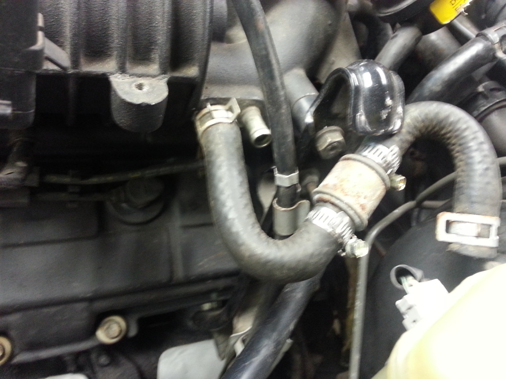

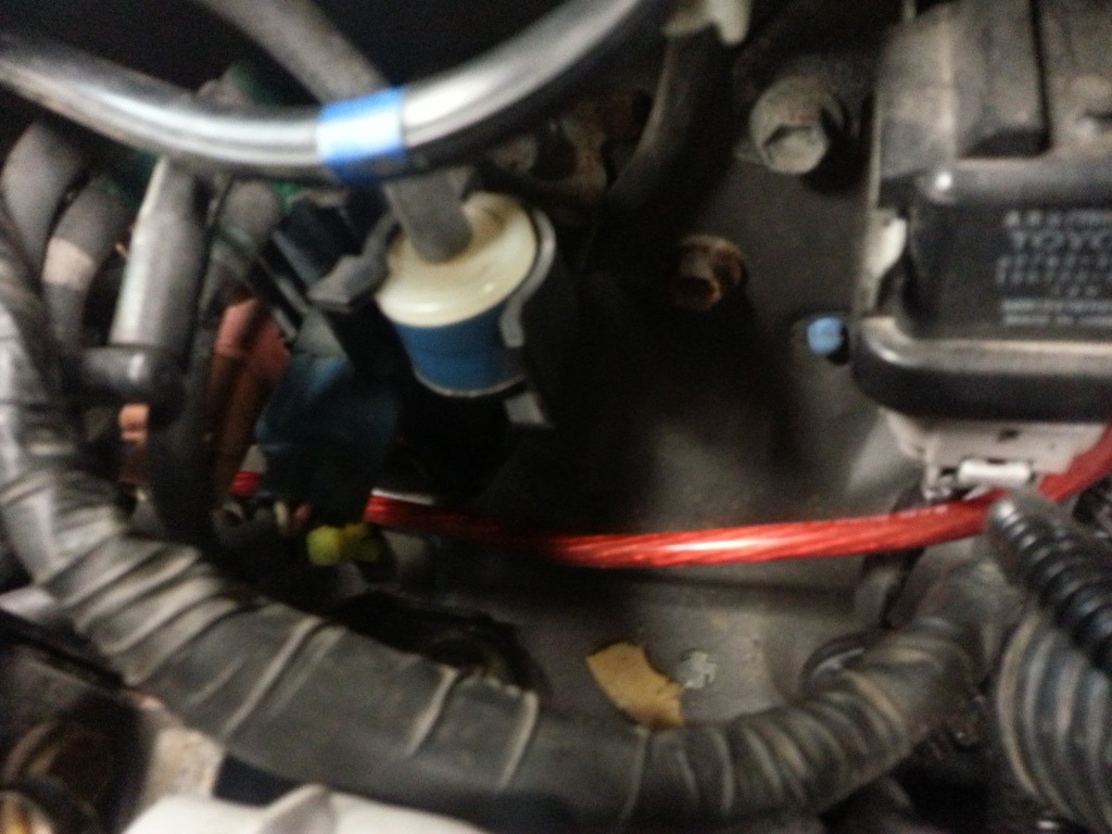

ok I want to post a few things tonight.. first off is it's alive, I started her up the other day and it runs good, considering no exhaust and one O2 sensor is not plugged in, let alone installed. I have to finish the evap setup next week, and get the exhaust fabbed up. I am likely going to keep the 3.0 cat installed, just move it forward, and then relocate the rear O2 sensor/bung after the cat. I got a couple of junkyard sensors and hopefully they will do the job. I have everything I need at this point to finish the job for the most part.. going to take it to a friends shop to put it on his lift and get the exhaust finished.. hopefully drive it home from there.
I have the electronic cruise, I hooked up the motor with the 3.4 cable, will that setup work without any further modification? I am using a 98 T100 harness/ECU.
I 2 images I took that hopefully someone can help me with. It's been so long since I disassembled the vacuum lines. I have been putting this thing together without knowing how it came apart as I bought the engine already pulled
The second vacuum port next to where the booster hooks up, since my evap is coming from the drivers side, and I will be using the ports on the throttle body, can I just cap that line, or does it serve another purpose? The vacuum line that sits on the drivers side rocker arm cover runs to the port on the intake line, I think?
and this blue/white check valve.. I need to know what this connects to. I'm embarrassed to admit I can't remember how this hooked up, that mess of lines that was there was a lot to handle 5 minutes after taking it apart, it's been almost a year since the 3.0 came out. Can anyone help me here? IIRC when tracing it's source it comes from a vacuum ball under the pass side fender.

Can't help you on the port by the brake booster as I don't have a SC, but the blue valve I believe is for the 4wd or ADD system IIRC. On my 3.0 there was a vacuum line that went from the bottom of the valve to a T fitting and then to the black two pronged fitting on the intake. So if I remember right I just put a T fitting on a vacuum line from the 3.4 intake and ran it to the valve. Glad to hear you got it started its going to be one sweet 4runner.

thanks, it was a relief that the engine started, and there was no oil smoke whatsoever, oil pressure came right up immediately.
As far as that blue/white check valve goes, it is connected back to the solenoids for the front diff, but I'm wondering if the bottom of that valve connects to something, maybe its a vacuum source for the canister in the fender? It is a one way valve, I can pull air through it, but I cant push any in. I will have to do a junkyard run to see if I can find one still assembled.
Also, on the intake, there is a curved line that did connect to a nipple on the front of the top section of the 3.4 intake manifold. There are a few ports on the intake silencers and the intake box that need connections or caps. Can anyone guide me to a diagram for those lines, or provide me a few pics of a properly set up vacuum setup on this s/c? Who knows if it was ever really installed properly at all.
