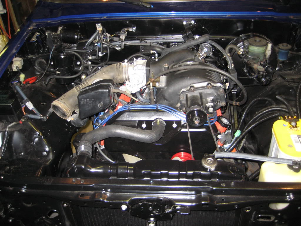

This is the one i used.... Name:  Engineinstall064.jpg
It said 88-89 4runner v6.... It was shaped different than my original rad and i had to drill some holes in the mounting tabs to drop it an inch or 2.... It may be a 90-95 rad....
