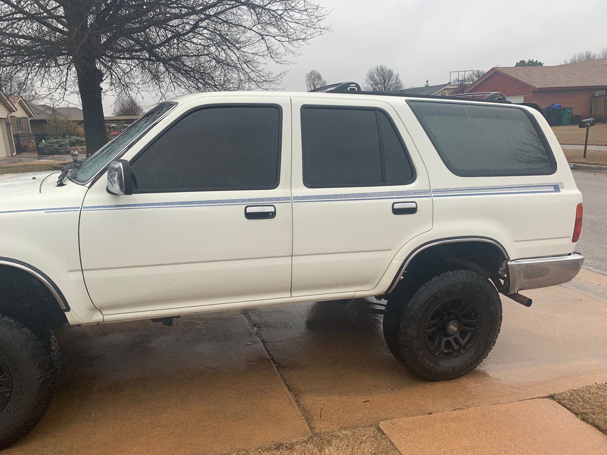

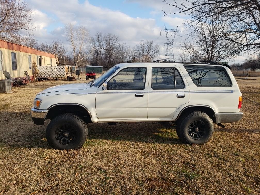

PS, this is what the 3.4 is going into:
95 4Runner 4WD Auto
(before and after tint)
