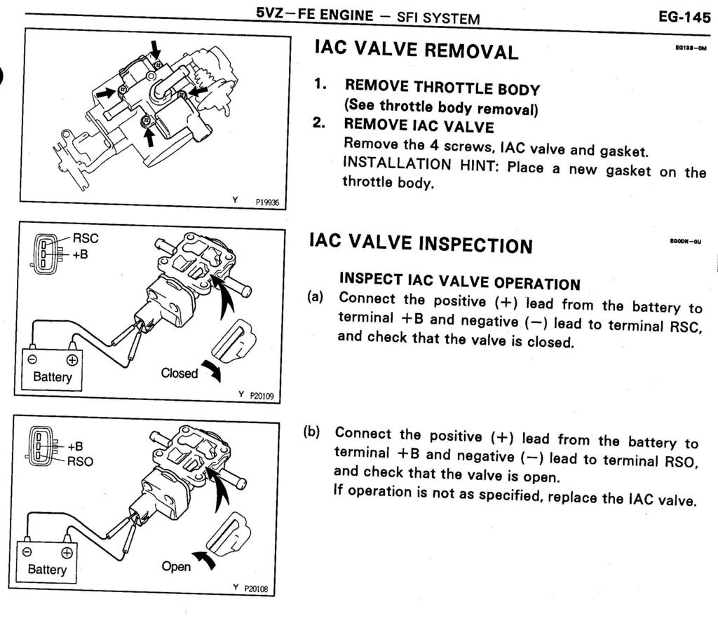

NO idle after swap.
Well, I got it back from the shop as they welded on my cat back and replaced the after cat bung 7 inches from the flange. Now it didn't idle. I limped it home losing power twice. I live only 4 blocks away.
So with my no idle and very choppy engine operation my first step was to re clean my MAF. NO change. I pulled some codes and had a P0120.....TPS. Replaced it, code gone still no idle. As it just seemed like it was starving for either air or fuel, it was time to check the IAC (Idle Air Control). I pulled the TB and removed the 4 screws at the bottom. THESE ARE VERY TIGHT. I suggest placing it on a table, using the correct head screwdriver, putting all of your weight on it and cranking on it to crack it loose. It all appeared very clean indeed.
Then I followed these steps to check it. Name:  IAC_zpsgxhuskjq.jpg
It worked fine. Then I decided to blow into the air inlet hole shown on the bottom by my finger. Name:  IAC2_zpslfxbqa4g.jpg
It was a clogged up like an old man needing to eat prunes. NO AIR would pass!! I closed off the tube, filled with throttle body cleaner and let it sit for about an hour. Removed the tube and it cleared the clog. A few more squirts and it was clean.
It starts and says running. Idle is a bit low. Maybe 600 RPMs or so, just barely hanging on. I think my throttle stop screw is to blame as it is out too far it seems. I got it from a yard and I think someone may have messed with it....Or was it me.........I can't remember. I'll futz with it tomorrow.
My suggestion to everyone is to pull this off and just clean it. Lube up the springs and action too using PB Blaster or something. Chances are good it was never cleaned by the previous owner who had your engine. This is a common reason for rough or NO idle and poor mileage from what I have read. It just might make trouble shooting a bit easier.
