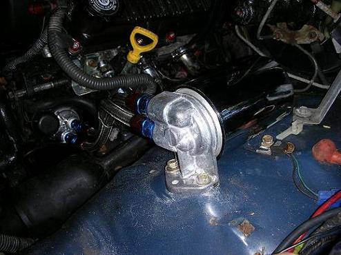

Old Aug 26, 2010 | 06:58 PM
theMonch's Avatar
Joined: Jan 2009
Posts: 453
From: NJ - 5 miles from NYC
Completed
So this is what I wound up going with. It is -8AN stainless braided hose. It is 1/2 NPT on the filter adapter plate end and 3/8 NPT on the filter bracket end. The filter adapter plate and bracket are both from permacool. It uses the large Ford style filter Fram PH8A. I have a WIX equivelent under that chrome cover for now.
I have checked clearance with both the headers and the back of the alternator and I should be good.
I still am a little reluctant to mount it higher that the original filter, but I will watch the oil pressure like a hawk for the first few weeks and make sure everything is alright.
This in combination with my quick release drain plug should make for some pretty easy and fast oil changes!

How has this worked over time? Any issues arise?
Old Oct 28, 2014 | 09:12 AM
theMonch's Avatar
Joined: Jan 2009
Posts: 453
Great!
It has worked out great. I have had zero problems with it. It makes doing the oil change really fast and easy. The only thing is having to keep a few rags underneath it when taking filter off to not mess up the inner fender well with residual oil dripping, but that is nothing compared to the benefits.
