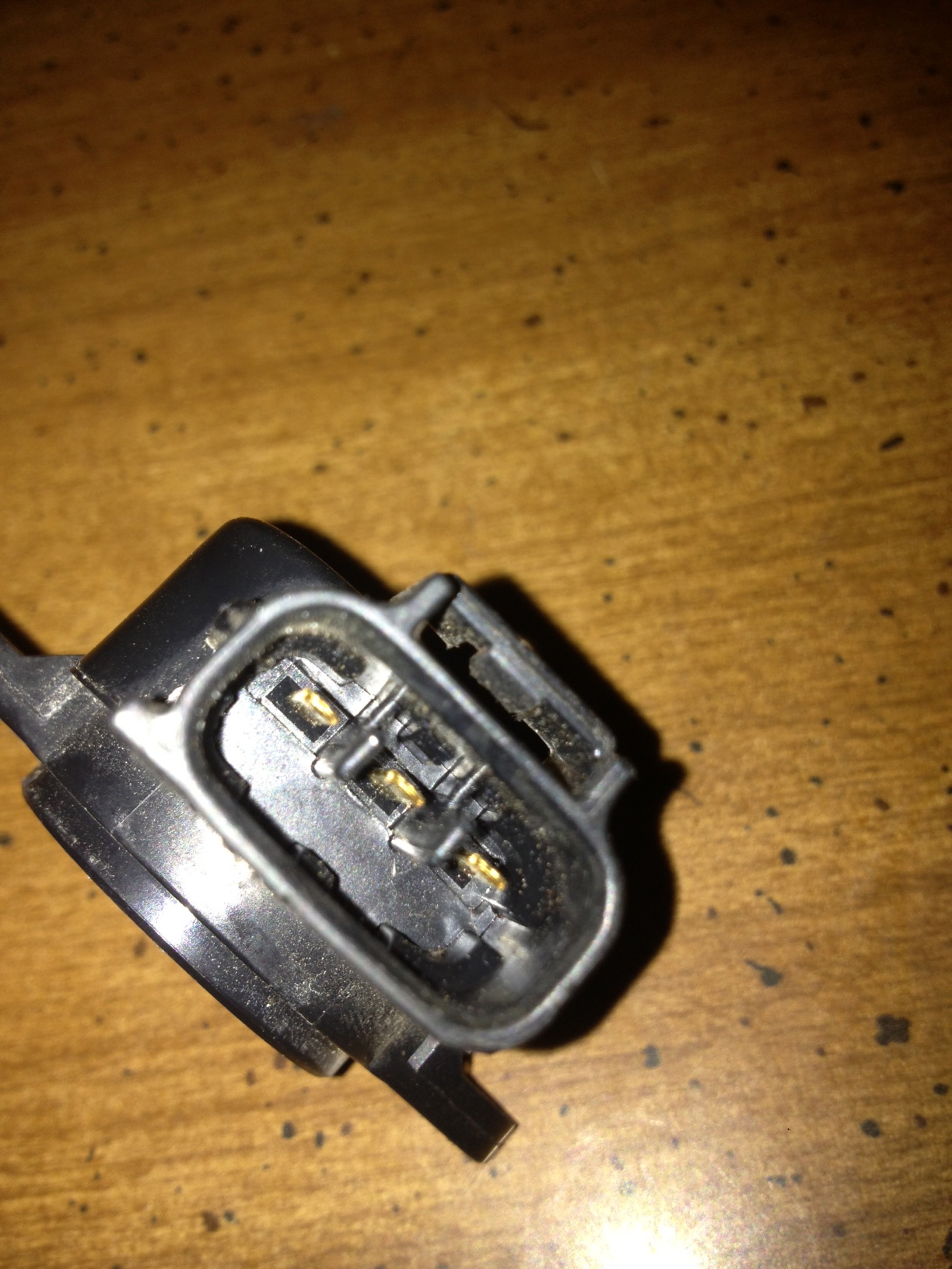

Ok so I think I may have f***ed up a little.
History:
89 single cab
98 4runner 3.4 (auto donor)
96 tacoma 4x4 MT ecm & harness
Here is where I ran into trouble, As some of you may know the 98 4runner used a 3 pin TPS (top two pictures) and my harness called for a 4 pin TPS (lower 2 pics). I believed the pn was 89452-22080 for the 4 pin, so i ordered one... biy the way it connects to the throttle body is completely different!
If you look at the pictures the 3 pin connects to a flathead looking ens and my 4 pin does not.
Has any one experienced this??
I figure my options are:
A) re pin my harness to run the 3 pin, but i don't know what the forth wire does...
B) order another TPS because maybe i have the wrong part number?? anybody have that info?
C) get a different wirring hanses and ecm combo and re-wire my truck...

picture 2

picture 3

picture 4, sorry about the quad post. my computer was being difficult.

Ok, so I think i figured this out, if anyone runs into this I think swapping throttle bodies will work.
