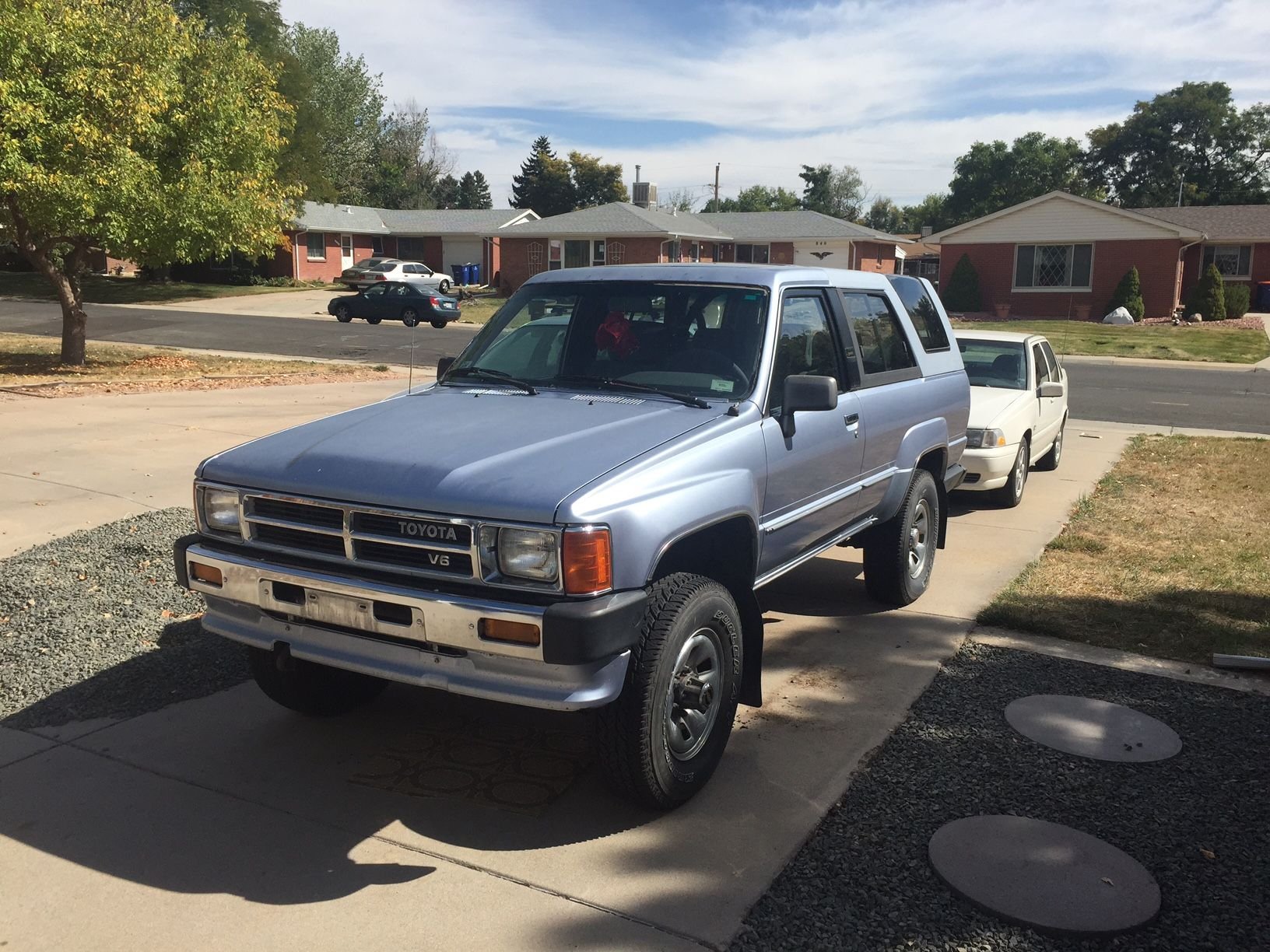

Hey All,
I've been reading these forums for quite some time now but just recently joined after picked up a first gen 4runner! Its an 89 3.0 which didn't drive (a bad clutch according to the previous owner) not sure this was true, but the body and frame was in excellent shape for an 89 and I got a killer deal on it. My plan was to put a 3.4 in it right away and since it wasn't drivable this one was a perfect way to start the build right away.
I've already started scrounging for parts and got my 3.4 out of a 2003 Manual Tacoma that had 113K with ecu, harness and anything else I could pull from the truck minus the alternator, but I got a CS144 to replace it.
I've pulled the 3.0 and taken off oil pan, oil pressure sender, engine mounts and other misc things to go on the 3.4. Also found some extra parts in the oil pan of the 3.0, looks like the crankshaft washers decided to give up. Clutch on the other hand didn't look bad. Maybe a bad slave cylinder?
I've already installed new seal on the valve covers. A few more days of building up the 3.4 and it'll hopefuully be ready to drop back in. Then on to wiring.
Here's its is!
