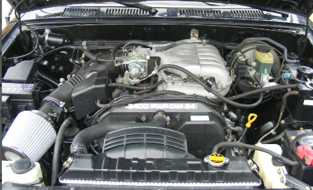

On Thursday I payed Cliff and Justin at Toy Only Swap a visit and dropped off my 94 4runner to get a heart transplant with the 3.4 from a 2000 Tacoma. Can not wait to get the 4runner back in a couple of weeks. After several e-mails and a couple of calls it was great to meet the guys in person. very professional guys and had everything lined up. Their crossover looks great!

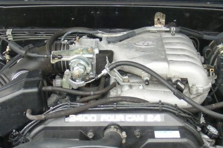

I picked up my 4Runner from Cliff and Justin at Toy Only Swaps on Friday and made the 500 mile drive to Nevada today. The swap was totally professional and very clean. All wires were armored/bundled and look like a factory job. I can not comment enough about how clean and professional the job turned out.
They completed the job in a very timely manner and the cost of the job is well worth having them do the swap.
I highly recommend Toy Only Swaps for their swap parts, but if you are near the West cost it is worth the drive to have them complete the swap.
For those thinking about doing the swap take the plunge the power difference is night and day. I am running 31/10.5/R15 aggressive tires with 4.30 gears and the 5 speed. No problems starting out in second gear now and I can pass with ease on the road. My 3.0 had 216K on it and the 3.4 is no comparison. I can not imagine dropping the supercharger on it. But time will tell

Straight off the Toy Only Swaps website
"Complete 3.4 conversions installed parts and labor start at $3500"
This will get you an awesome running 3.4 swap! I added a few extras before the new motor was dropped in.
All OEM Toyota Parts
Plugs and Wires
Timing belt
Water pump
Clutch kit
Radiator
Drop them an e-mail and they will give you a quote on what work you want done.
Their work is supper clean and they completed the job in the time frame promised. Actually sooner on my swap!
What did I provide?
A 1994 4Runner 5 Speed with a 3.slow 216k miles and it leaked oil like the Exon Valdez.
Toy Only Swaps
Sourced a low millage 2000 Tacoma 3.4 fully tested with a warrantee on the motor.
Built a swap harness
Built a new crossover
Installed and tested the new motor
Complete with all emissions in place including new style charcoal canister and both O2 sensors.
OBD2 plug installed as well
Cliff and Justin are great guys; they answered all my questions and keep me updated on the progress of the swap.
I had a 500 mile drive home without any issues. 100+ degree heat and a lot of mountain passes.
I have lurked on Yotatech and read every 3.4 swap thread I could find. I read through the problems and successes. Between work and family I did not have the time to dedicate to a swap.
Having Toy Only Swaps do the job for me worked out great. I would use them again in a second.

What a deal. I think I paid that much in parts.
I don't think , based on the pics, that it'll pass smog in CA. The intake needs the CARB sticker for one thing....
